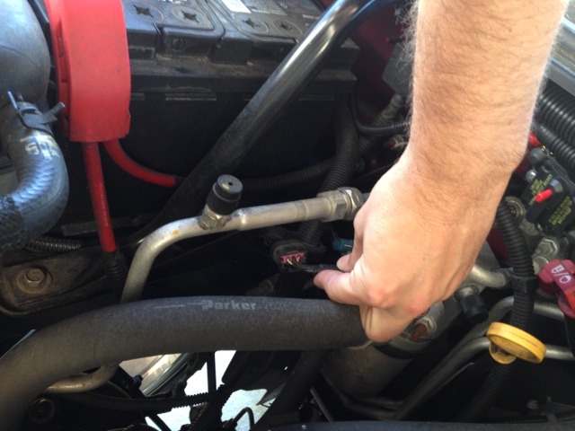

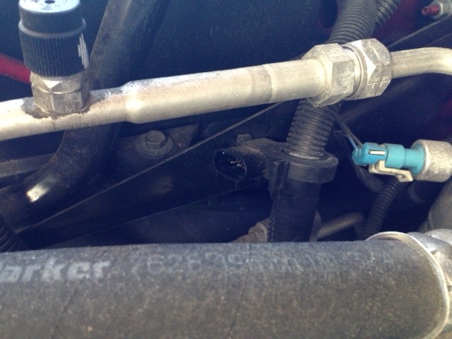

on the 07+ we have this regulating system (Regulated Voltage Control or RVC) that basically controls the alternator when it sees more/less drain on the battery.
Being that I have a decent sized stereo as well as HIDs (with the relay harness) on my truck, I looked for a way to turn the RVC off. There would be points while driving that my HIDs would start to flicker because the ballast weren't getting 12 volts. I thought it was the ballast and swapped sides and even purchased new ballast with the same results.
Well, there is a wire connection on the negative side of the battery that controls this system. If you unplug it, your alternator will continue to charge and will stay around 14v while driving. I've had this unplugged for almost a month now with no issues what so ever. No more stereo drain, no more flashing of my HIDs, nothing. I haven't seen any consequences of disconnecting it either.
Here's a few pics you can see the plug and the wiring to disconnect. I put some electrical tape over the connections so they don't rust or get corroded or anything.
Can anyone upload these photos? Id like do this mod on my 09 Tahoe.
