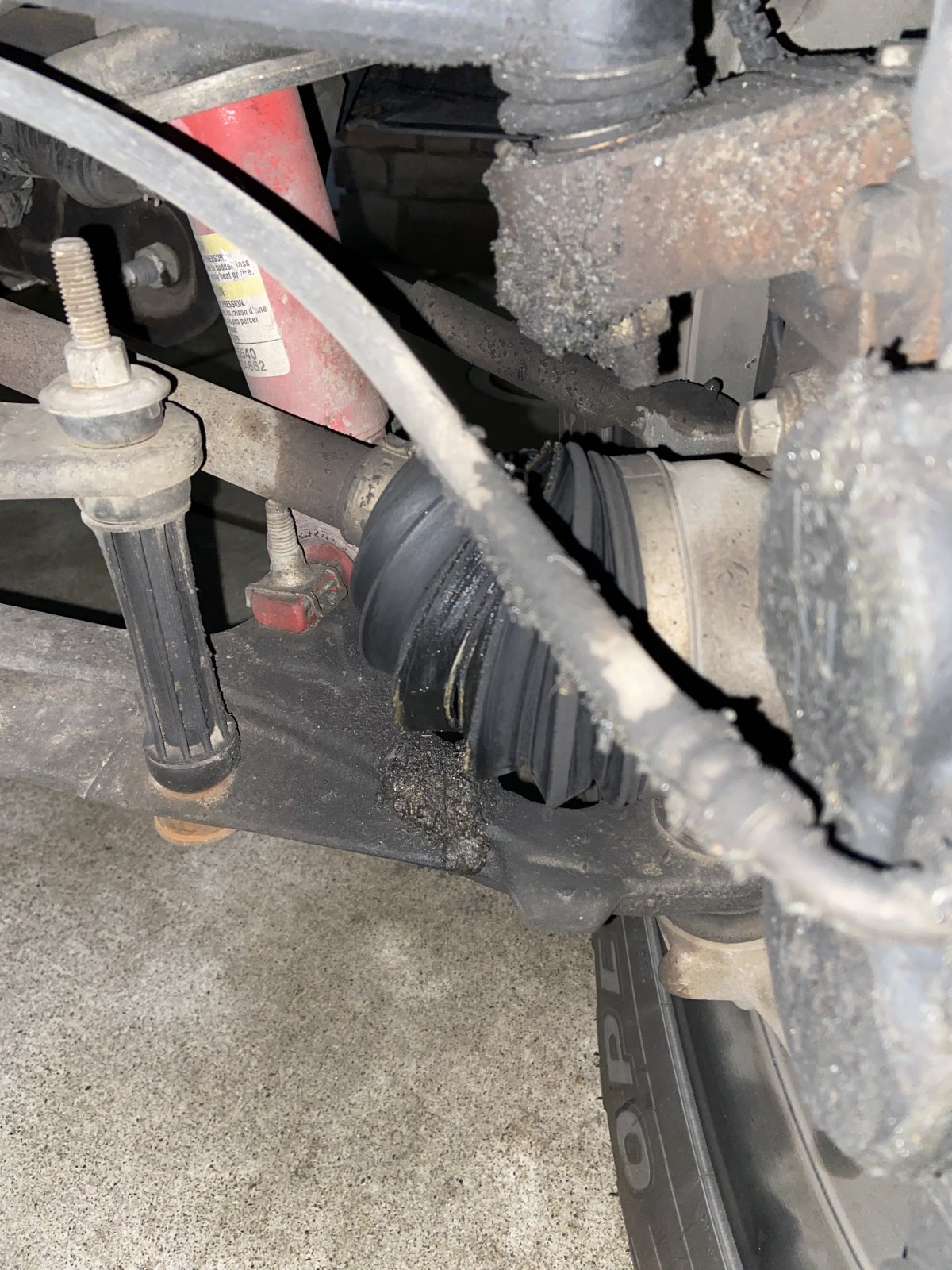

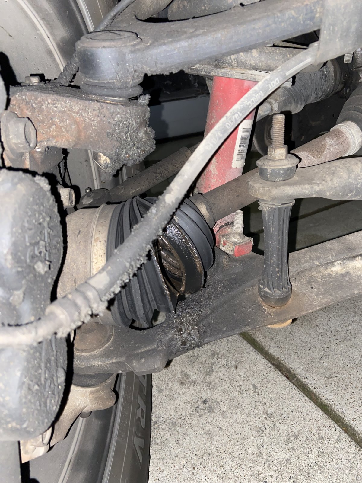

Found it

I’m guessing it the CV joint/ boot
Maybe. But those usually make noise at all speeds - especially when turning, when they're on the way out. Easy fix though. If you can post a video of the sound on YouTube with public permissions and link it back here, we can give it a listen to help verify.
10,540
15,298
I just had both front drive shaft assemblies replaced last week, because the CV boot had split on one, and I had over 150,000 miles on those drive shaft assemblies. Mine were not making a noise, though.
B-train
Sep 12, 2022
2,717
4,934
Depending on how long they've been open could most definitely be your issue. If the grease inside attracted dust, dirt,and moisture, there will be a gravely sounding from them. The contamination can also accelerate wear on the components causing time to become more sloppy.
