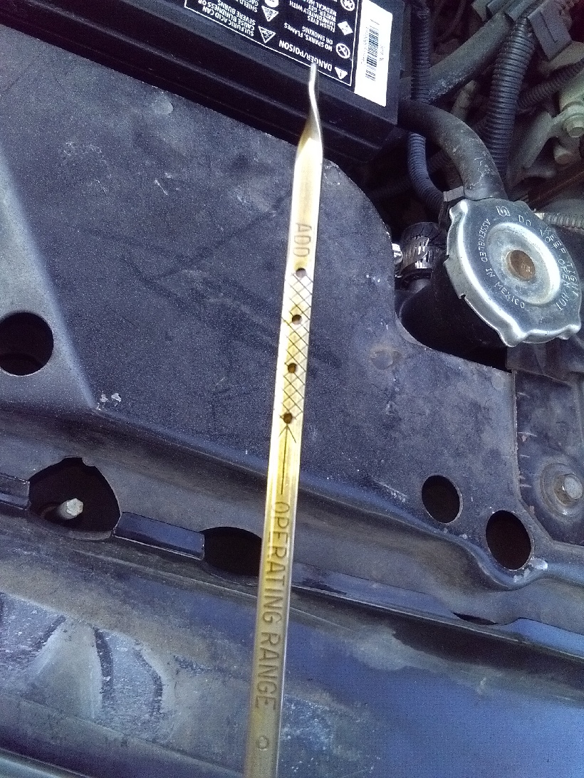

Hey all. I drove home from a regular oil change and didn't notice anything unusual but next day saw oil level was a little high (at about the R in "OPERATING RANGE" on dipstick, see picture). Service invoice says 6qt went in. Took a short drive, pressure seemed higher than normal (about 50psi), slowly dropped to around 25psi steady as truck warmed up. Should I be worried, try to drain some out? THANK YOU!

That invoice also tells you they pumped in oil and never checked the level. Idiots!!!
You need to get some tools and a drain pan and do it yourself.
... and check it each time, before you leave their facility.
I have no disagreement with Fless' post but, in my experience, his recommendations are for reading and adjusting in finer increments than what you're dealing with here; especially if they've over-filled you.
If GM's gone from 5 qt capacity to 6 qt capacity, over filling an older engine just gets more likely.

Unlevel ground can make a difference, too.

I appreciate all the great advice folks! Manual says 5qt. Reading slightly lower on back side of dipstick (about at O instead of R in "OPERATING RANGE"). Dipstick wasn't perfectly horizontal when I took pic. Reading probably a little high. It's a good 1/2-3/4" past top hole in any case. Street its parked on not perfectly level but not that far off.
Dipstick smells like oil to me with no obvious fuel odor.
Shop's half hour away and driving back sounds risky. Tried to crack drain plug to let a little out but way too tight. Afraid I'll break ratchet, plug, or shoulder if I keep at it. Setup here no good for wrenching anyway. Ordered a big syringe so I can try pulling some out from dipstick tube. Guess I'm not driving anywhere for a few days.
Thanks again. Seem like easy fix. I just hope no damage is done. Do the pressure readings sound weird?

What were your pressure readings before the oil change? Every vehicle can be a little different. Even different oil filters or a defective bypass valve can give different readings.
If I were in your shoes I would call the place, tell them the situation, send them the picture if you want or they ask for it, and tell them you are driving it there or towing it at their expense. If driving it if something happens to the motor on the way there it's on their dime. After they fix their mistake don't go back there.

Put the truck on level ground and let it sit allowing the oil to drain back to the pan if it's been run. Wipe the stick clean and take a reading. Look carefully at both sides of the stick. Many times the stick will rub the tube and smear oil making it read wrong.

Honestly never paid much attention to pressure readings before. I know they were always in range. Otherwise I'd have noticed. Best I can recall maybe 20-25psi (about 10 or 11 o'clock) was normal. Can't remember if it went higher while warming up or not.
In principle I know y'all are right but also inclined to cut losses. Like I'm supposed to trust this shop to make it right? Might well just make it worse. If motor seizes on the way there I can yell all I want but what can I really do, sue them? If I can pull some oil out the top at least I can trust myself to get the level right and hope for the best.
