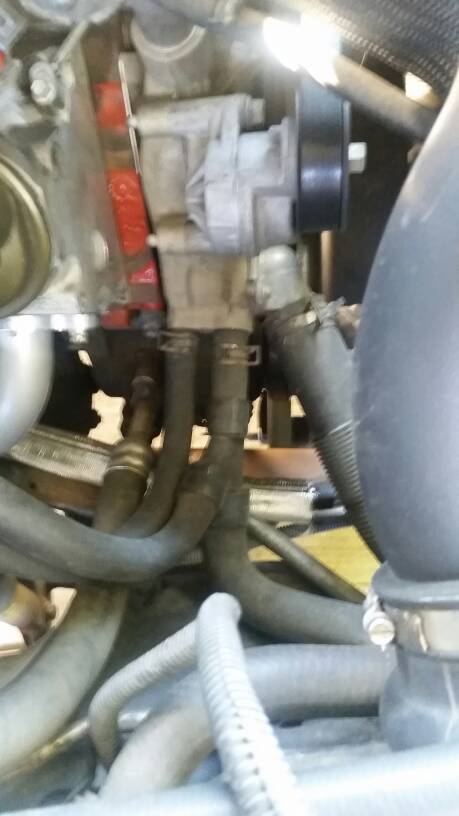

i have a question on how your hoses are routed. Can you take a pic of the hoses running from water pump to the surge tank? I never see fluid moving in my surge tank while the engine is running. The level will fluctuate from cold to hot, but i don't see any actual flow.
Also, does your lower radiator hose get warm as soon as you start the engine?
Last, have you plugged up a tech tool to confirm the temp gauge is reading correctly? Those stepper motors can go bad over time.

Unfortunately my camera is busted on my phone but ill try to explain how my hoses are ran. From the top of the pump (outlet) runs to top drivers side of radiator. Top passenger side of the radiator goes to top of surge tank (not the overflow on surge tank) Bottom of surge tank goes to an inlet on the water pump behind the thermostat. Bottom passenger side of radiator goes to thermostat housing. What I believe is happening is the pump is pushing coolant into the radiator, the thermostat is closed so it runs into the surge tank and comes out the bottom hose which runs right back into the engine because that hose goes behind the thermostat. I plugged that top hose coming off the surge tank and now the truck heats up just fine. My temp gauge stays at one line before 210 and I have excellent heat now. My check engine light also went away. Obviously this is not the correct fix and just a band-aid. Any ideas?

I agree. the only problem im seeing is that the bottom hose from the surge tank goes into the water pump but it goes in behind the thermostat, not in front of it. So when the pump is turning its pulling the coolant out of the engine through the radiator into the surge tank and back into the engine right behind the thermostat. i closed this loop by disconnecting the surge tank from the radiator. Now its running perfectly. How is that possible?

Alright i think im a little confused here. At first glance it looks like that hose that goes into the water pump from the surge tank goes behind the thermostat. What I think is actually happening is the thermostat is longer than most and can close this hole when the thermostat is closed. I think my problem is an incorrect thermostat housing for my new pump. Its allowing coolant to slip past the closed thermostat making an open loop system. Ill order a new one and see if this fixes my problem. Ill keep you guys updated.
The hose from the surge tank should go to the front inlet of the waterpump not the rear....that hose should run to your heater core..if your hoses don't look like this they are reversed and explains why u see coolant flow in the surge tank..
Sent from my SAMSUNG-SM-G900A using Tapatalk
Yes mine is routed just like the one pictured. Thanks for the info!
