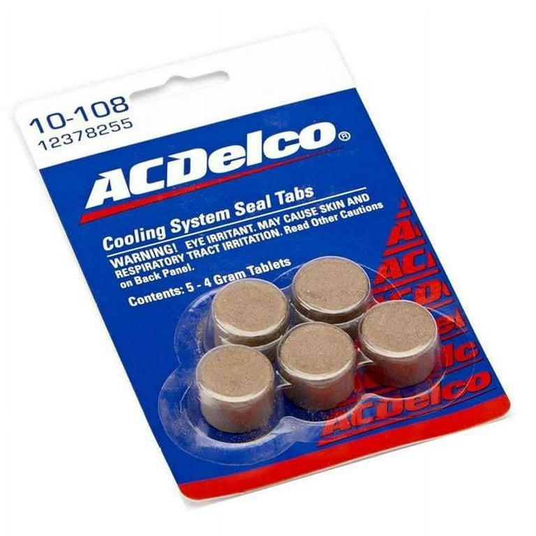

Yea, use the GM coolant leak tabs and nothing else. They work. The others are a 50/50 crap shoot.
Guessing these are the ones?

I put the UV dye in coolant reservoir and didn't add the tabs yet because now I am not sure the coolant is going down now. Just something I noticed. Will keep an eye on it.
