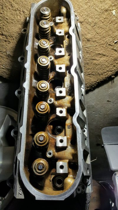

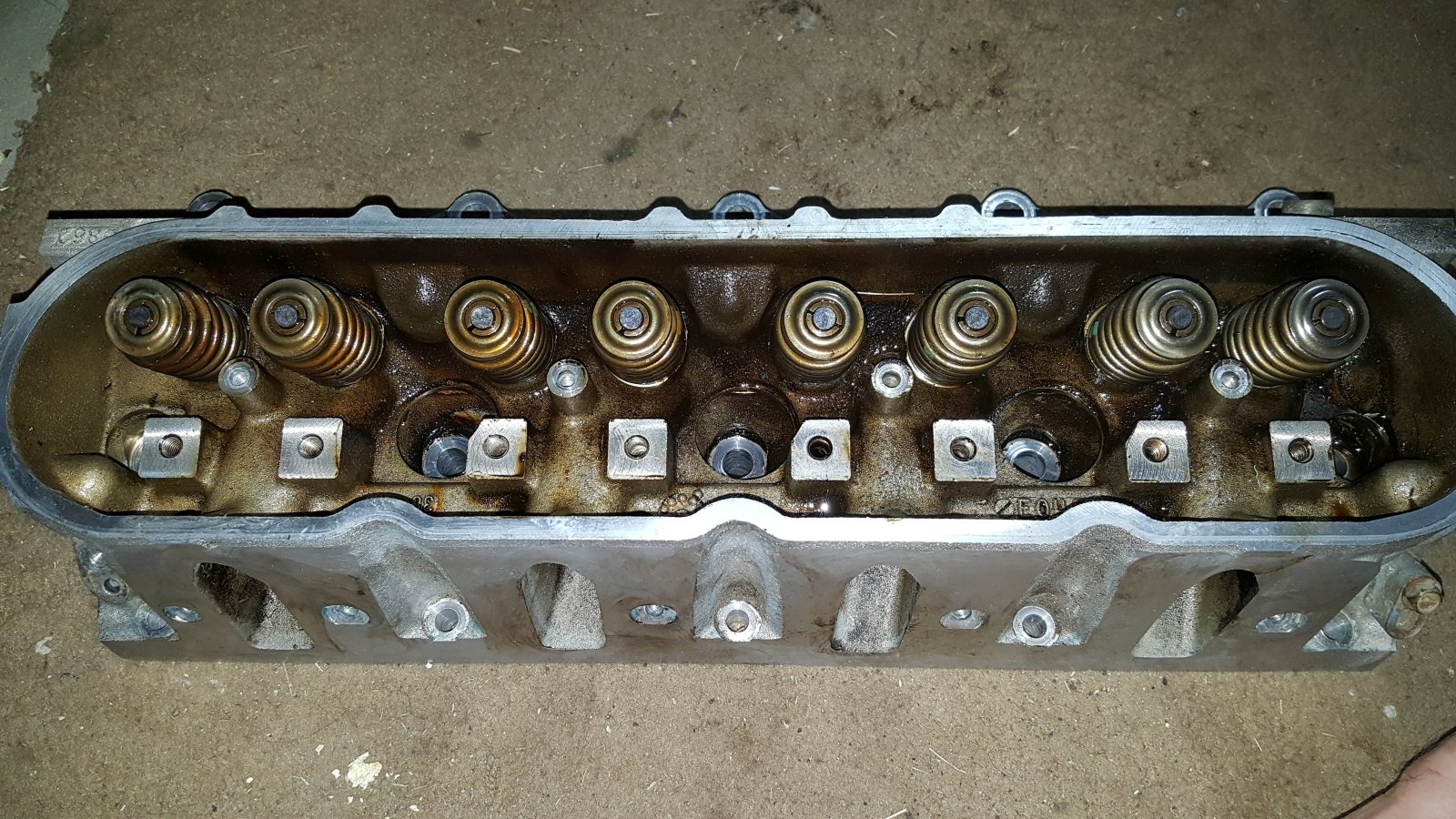

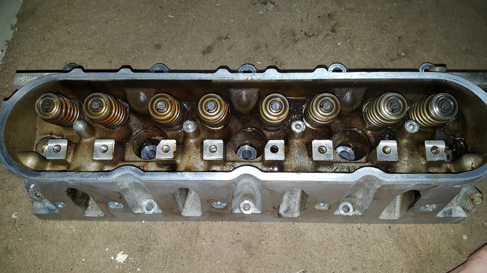

I have none of this going on. Engine runs smooth, no misfires and no sludge. Here is a pic when I had the heads off. Heads are number 862 with no Castech logo. Which are identified by a small "battery" or "Castech" logo cast under the valve covers. Mine do not.

No smoke in exhaust and mine aren't Castech heads.
"The Castech head issue in 5.3L GM Vortec engines (roughly 2001–2006) involves a manufacturing defect in 706 casting heads that causes cracking near the head bolt valley. This defect leads to significant, unexplained coolant loss, often resulting in sludge under the valve covers, a "milky" oil appearance, and sometimes misfires, typically requiring replacement of the heads."

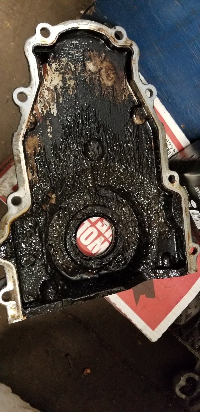

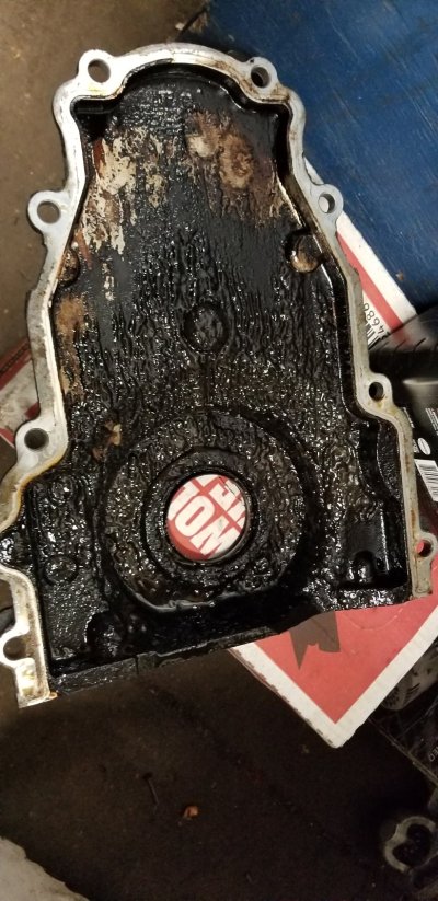

I thought only the 4.8 had 862 heads. I had/have 2 vehicles that had 862 heads, and they both would get low on coolant, where I'd need to add coolant maybe once a month. They were an 05 Express van and my 03 Tahoe--which i swapped a 6.0 in. Imo it was the 862 heads. I never saw anything that pointed to coolant evaporating--sludge under cap etc, but later on the van was the oil pump was replaced and there was a ton of sludge in there.
I saw somewhere online that the 862 head also had Crack issues. I added those coolant tabs to the van and never had to add coolant again. Stayed that way for another 2-3 years until I sold it. The tabs are cheap enough to get and try. I think that'll solve your issue. Give it a shot, nothing to lose.20200114_184000.jpg20200114_190436.jpg20200114_190430.jpg
I used to change my oil every 3-3500k. Bought it with 110k. In these pics the van only had 144k on it. Imo it's from the coolant.
