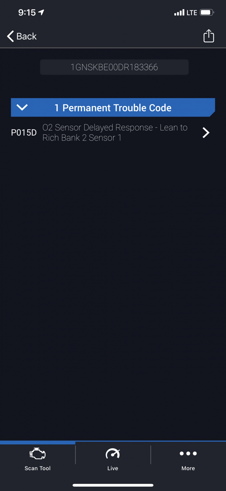

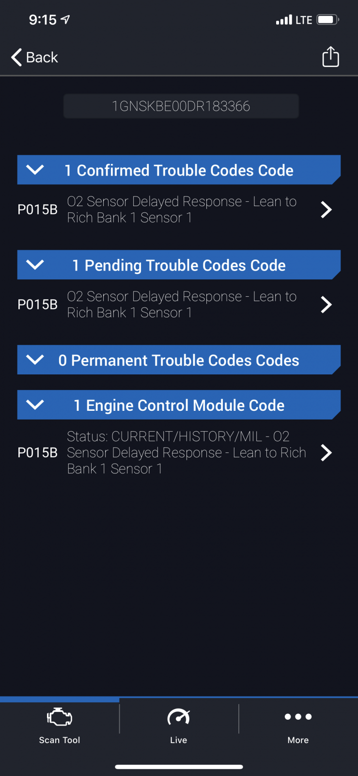

0420 and or 0430 probably. Your o2sendors not liking the super gas. Unless the engine is tuned I would stick with 87
and yes, every few years i get same codes in my 13 hoe but i use 91-93 all the time...
edit: sorry, it is probably 015b or 015d delayed response from either 02 sensor

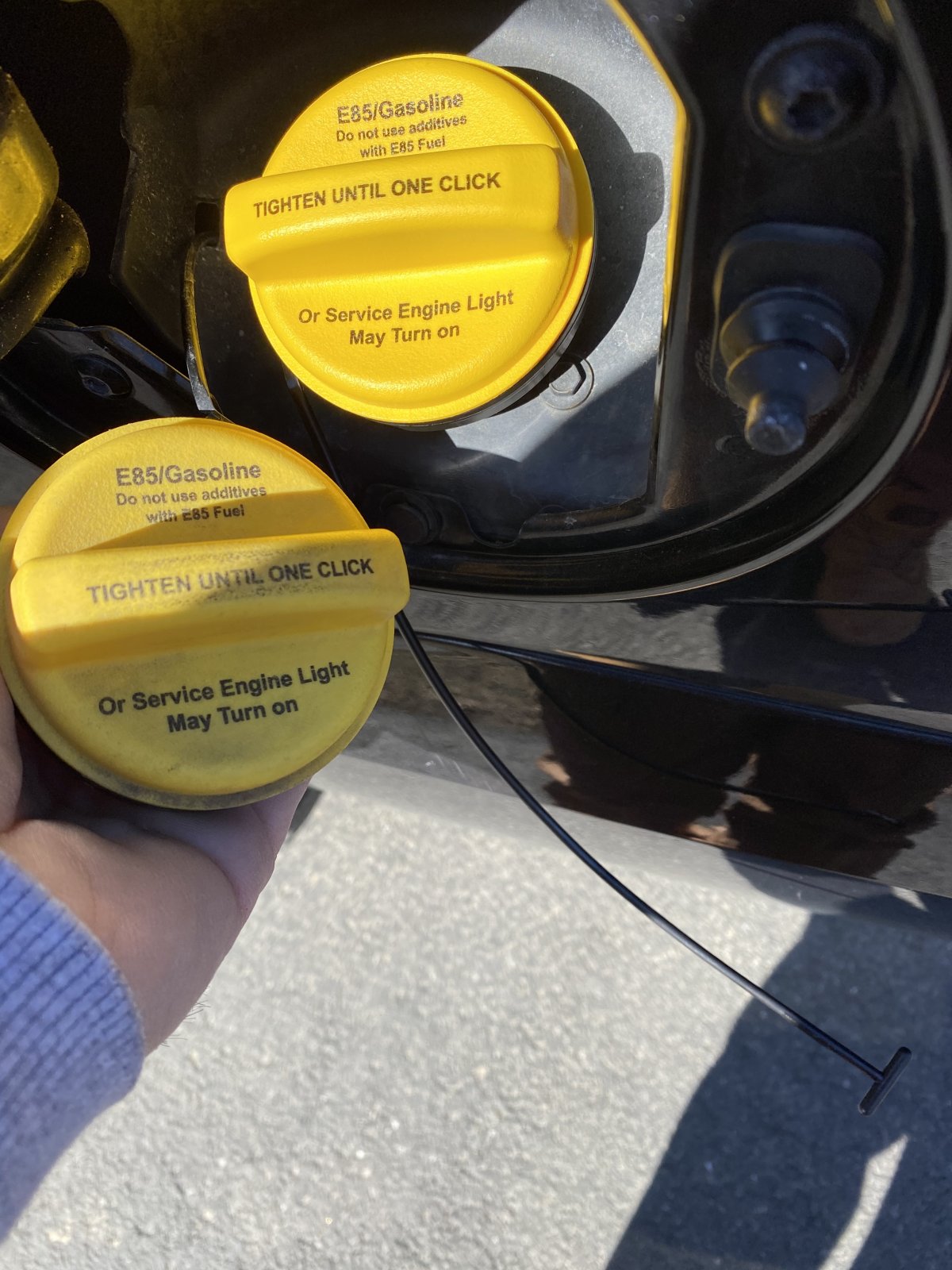

But if its a 13 and the gas cap is yellow its flex fuel

No matter the color of the gas cap (they can be changed) the inside of the gas filler door should indicate whether it's Flex or not. And do we know if any of this gas is E85? Or it it just the octane difference of the E10?
