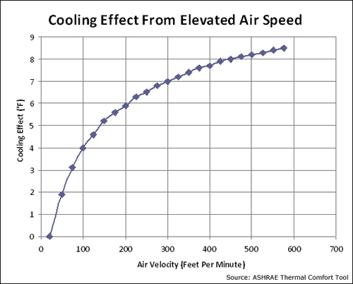

Compounding fans can work... but it can also make things worse. If the air flows over the radiator too fast it cant pull the heat out of it.
faster airflow = more heat removal. At least until you get so much airflow that friction and compression is a concern. Supersonic radiator? :oops:
Granted there are diminishing returns past a certain point because of boundary layer flow behaviors. But there's no such thing as too fast to remove heat
Well, i guess i shoud caveat that with i dont know everything about airflow. However, i do know coolant can move too fast through the radiator to transfer heat to the air. I have seen my own Nova run cooler with a 195 stat than no stat at all.

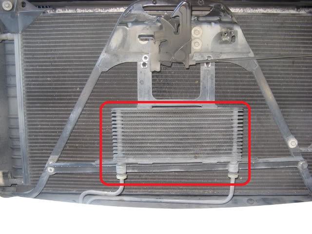

Sorry I’m a newb to the forums, 2004 Tahoe z71 the engine itself has around 80,000 got replaced with a crate when the truck hit 100,000. Last year I replaced the water pump, thermostat and I believe both hoses. I have yet to replace the radiator worked on doing the cheaper replaceable parts first but it does make sense. I’ll have to run down to the O’Reillys to see if I did the fan clutch as well I wanna say I did. I’m running Preston’s dexcool antifreeze. As far as an aftermarket tranny cooler I doubt it I’m the second owner and the lady I bought it from wouldn’t of known what that is she’s the one that blew the first engine.
Take a look behind the grille and see if you have one of these (in the red box) in front of your A/C condenser:
