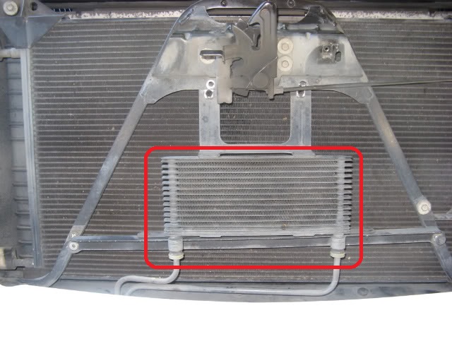

Take a look behind the grille and see if you have one of these (in the red box) in front of your A/C condenser:
I will look tomorrow when I get back home, out of town for work. I believe I do though and I was under the impression that they came stock. Learn something new everyday. But I’ll get back to you on that one to give a definite answer.
