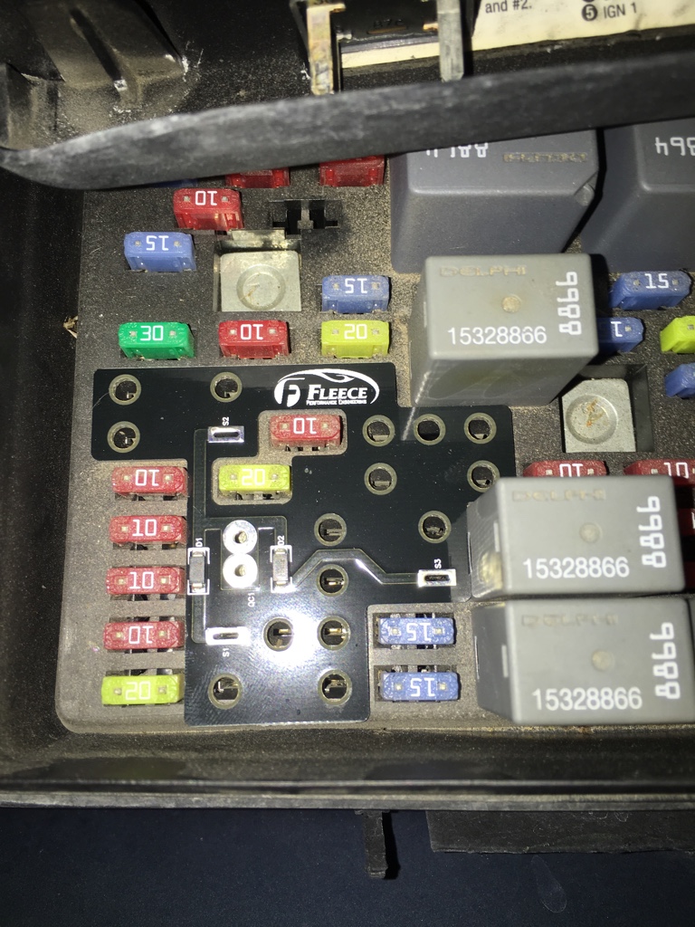

Isnt this already incredibly simple dor the 00 to 02? Ground yellow wire off the low beam. And for a 6 hi create an insulated jumper for the relays under the fuse panel... ? Is there something I dont know?
52,954
Yes it's pretty easy but there are some who don't want any jumpers in their fuse panel. And BTW you need a diode in the jumper or it won't work.

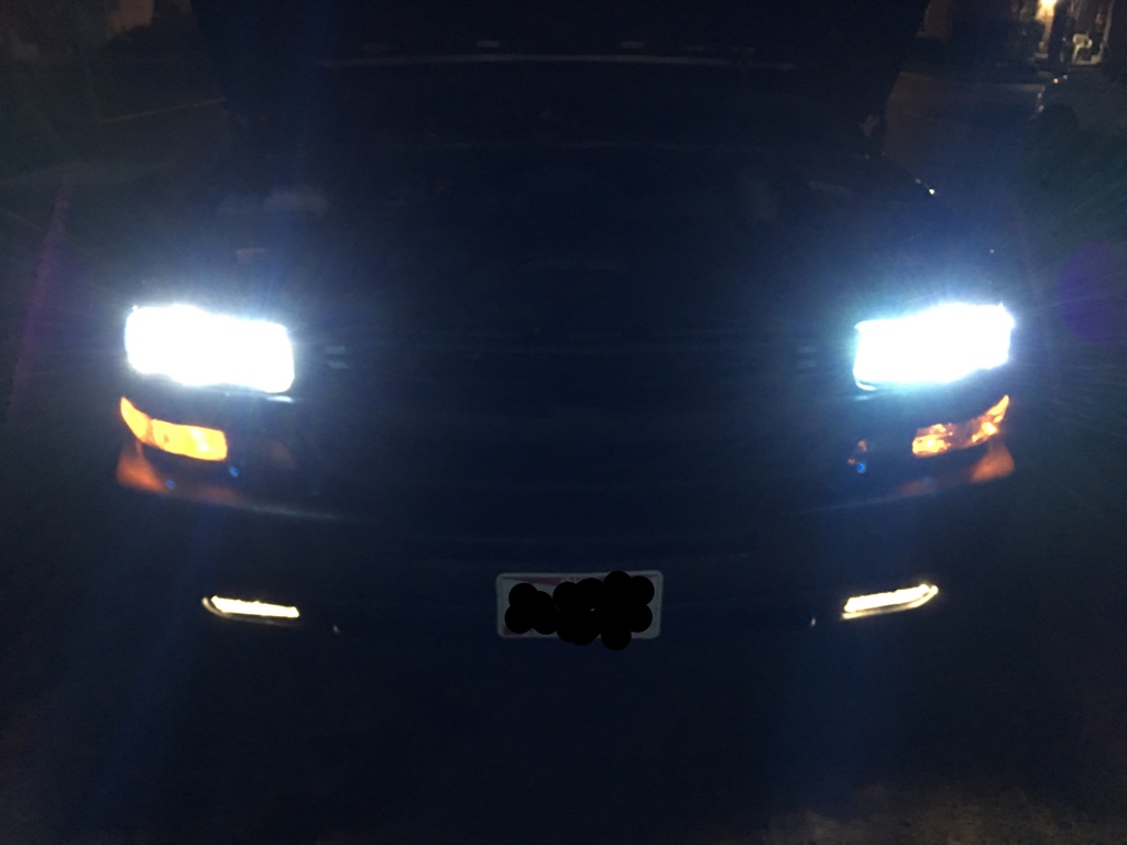

Installed this today in the wife's 04 Denali, very very simple. Kicks on the fogs and keeps on the lows, when High in engaged. If the fogs are already on, they remain on.

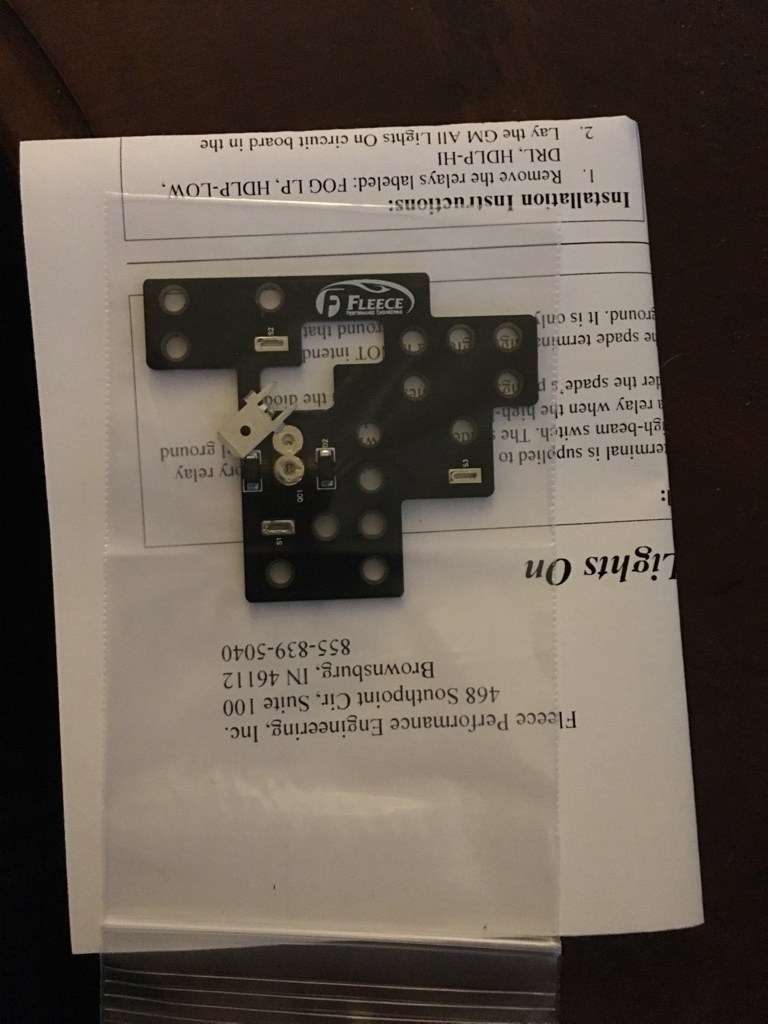

What exactly does the soldered spade do in terms of auxiliary? Has anyone utilized this?
6HI Mod via diodes (currently)
Have this board in-hand with solder..
the aux spade will send a signal to a RELAY that will they take power directly from the battery to power light bars and what not.. EXAMPLE. you click your high beams and it automatically turns on all 6 lights plus the light bar for sunlight laser beams on the dark country road.
the relay can also have a switch wired to it at the dash if you want to turn the light bar on when ever.

Sweet. So say you have 2 switches already set for aux lights, can you then just piggy back this off the sw feed at the relay(s)?
