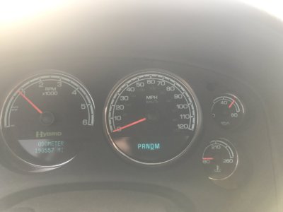

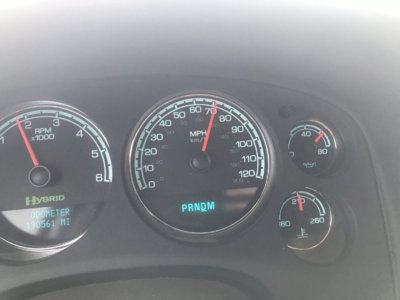

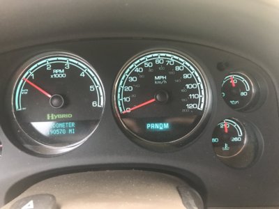

What's the range on the oil pressure for these trucks? I constantly run around 60, and when the truck runs poorly, at or less than 40. At start up it instantly goes to 60 and holds. Holds at 60 while I'm driving. When the temp outside is hot, the oil pressure drops to 40 or below and the motor runs poorly. At that point, the motor hesitate on acceleration and has a rough idle, sometimes a spike in RPM. See pictures below.

Not familiar with your motor, has it always run at 60? Are you the original owner? My 5.3 idles around 20 and is usually just north of 40 underway, all normal.

2nd owner. I've had it almost 5 years and it's ALWAYS run at 60. Drops to 0 when it goes into auto-stop. Goes back to 60 during any drive or idle. Now it runs rough around 40 and won't go into auto-stop if it's around/below 40. It has a jerk/hesitation when it runs at 40 and at idle.
