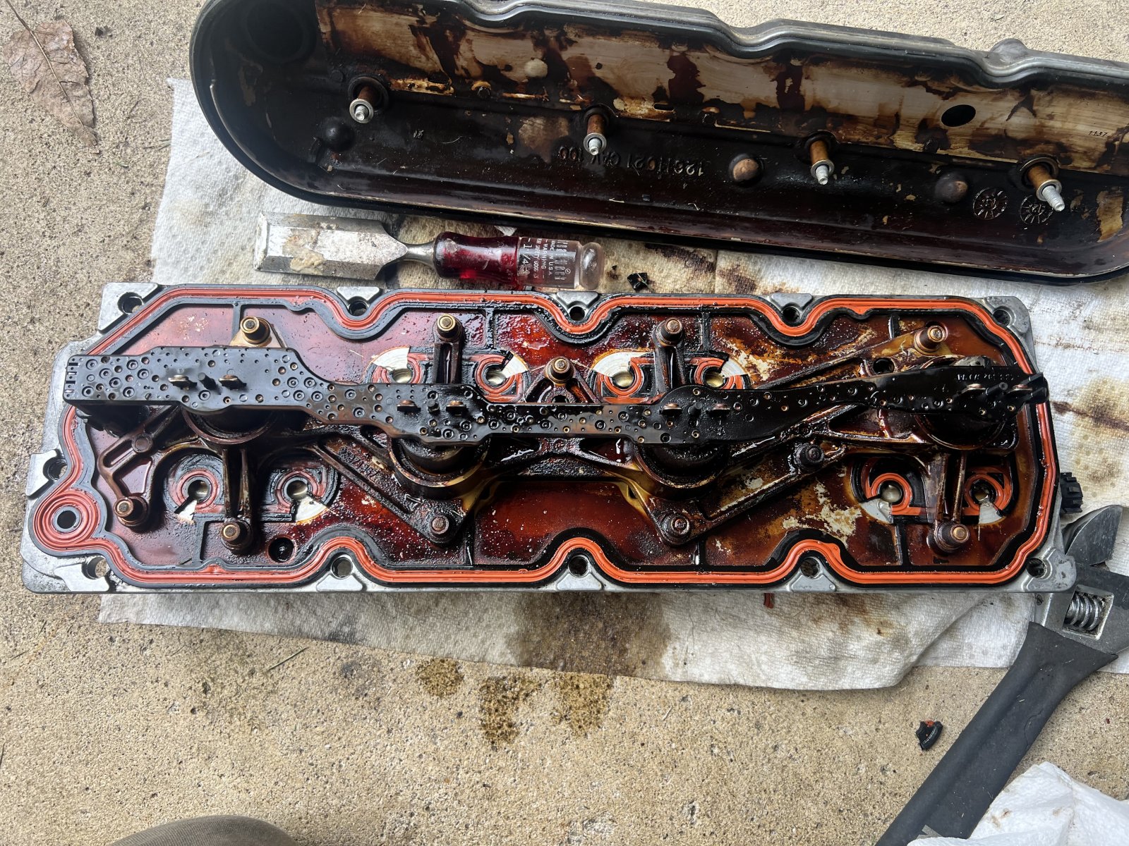

Yea so looks like I'm gonna do a quick fix on the afm lifters for now and probably vlom, and find myself a lower mileage motor to do a dod delete and a mild cam on for when it fails again also gonna disable dod via hp tuners
I don't think I've read thru everything. but is the lifter just stuck down and loose rocket not opening?
if so, you're high mileage, but you might unstick the lifter, turn it off with hpt and see how long it goes?
Unstick the lifter?
j91z28d1
Feb 28, 2022
4,675
5,934
Hmm do I need a new vlom if I'm deactivating dod
are you replacing the afm lifters? the vlom has to match the lifter type. can't put a smooth plate on a afm lifter and no reason to run a vlom on a standard lifter.
I was gonna go back with what's in there

Just looking to bandaid it while I work on a bigger better plan for more horses and no dod in my life

this is kinda hacky, but it has worked for some if you caught it before you damages the cam or lifter.
@spsteve
This is exactly what I did on my 6.2. Had a lifter collapse but I was able to trailer it home so it didn’t wipe out my cam.
#4 was collapsed. I ordered the kit that CrazedPerformance sells (in the video he shows how to use it). Comes with a tool to unstuck the lifter as well as plug for the VLOM
Since I have a 2013, I have the updated VLOM so I still chiseled the gaskets around the towers
I got a OBD device on Amazon and I’ve been running it since. Not sure how long it will last and it’s more of a band aid. Deleting AFM wasn’t in the cards for me when my lifter collapsed. But it was much cheaper for me to do it this way.

@spsteve
I did the same thing before mine stuck, turned it off, got the block off, clipped the gasket. fingers crossed and hoped, as there's no delete kit known to work with my engine since it's different cam for the hybrids.
People will be able to chime in more on this than I will…
But I believe it’s not uncommon if you replace the AFM lifters that they will collapse again fairly quickly.
The last owner of mine said they replaced the lifters about 20k miles before it collapsed. And that’s assuming they actually replaced them.
Now I’m definitely not the most knowledgeable on this forum. But imo I would either unstick the lifter, full DOD delete, or swap.
I think AFM lifters can also collapse even if AFM is turned off. Not 100% sure on that one
