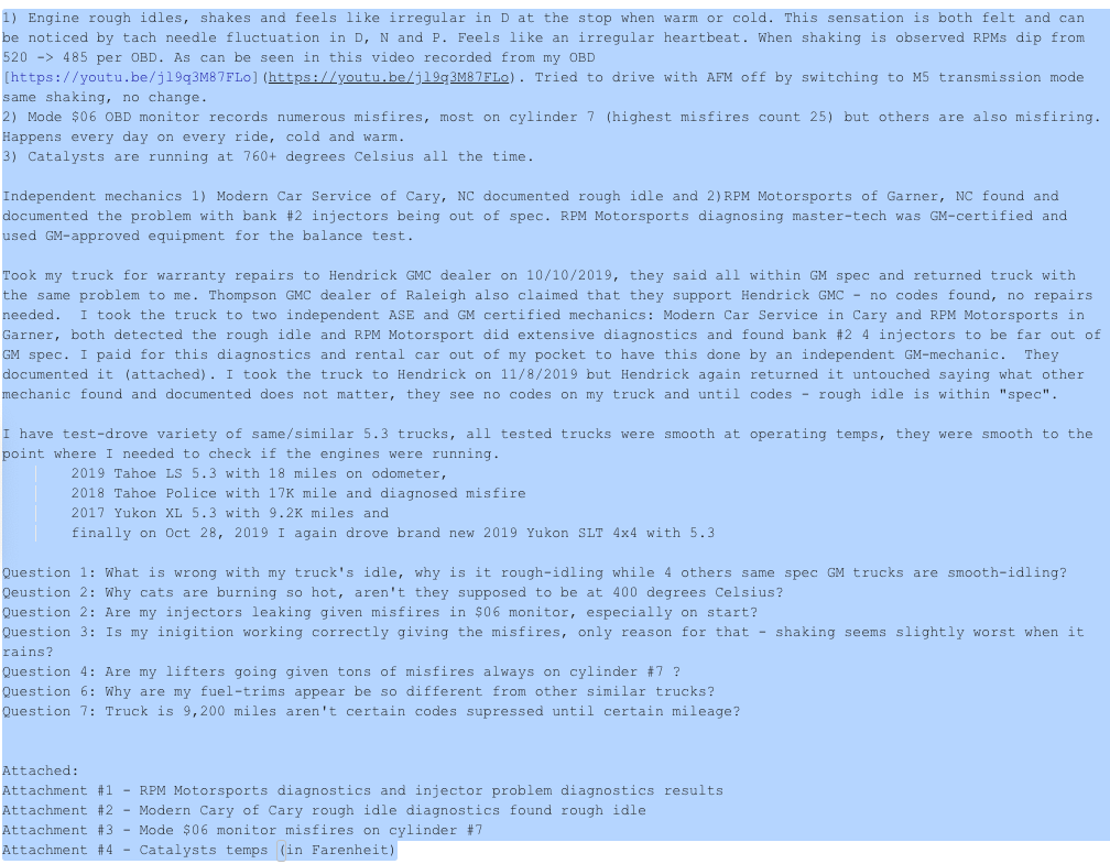

Brent, thank you for pointing it out. I have provided Charles Boyd GMC with detailed problem write up (see below) including cats running high, got home last night and cats running hot complaint was conveniently left out from the work order when truck was returned to my wife. Call me crazy, but this all smells fishy now. They probably know that my truck is suppressing codes and cats will melt or fail soon and if it was logged on the order they would be liable, by not being on the order it is mine to fix when they melt. I cannot explain why dealers leave details of my complaints out. I provided them printouts and logs...

Brent, you advice is truly invaluable! Thank you. This is what I would do from now on - record on my cell, I cannot believe how many times they ignore what I say. Just to make things interesting I called Charles Boyd GMC this afternoon and asked to add cats complaint to the work order, he said, he did not receive anything from my wife and son, and work order is closed and cannot be updated... Just surreal. North Carolina 2019, it is phantasmagoria of horror.
