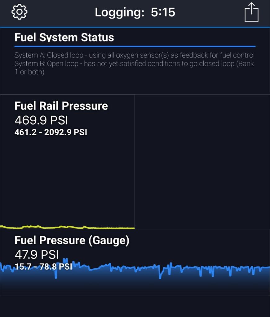

Wonder if it could be in the high pressure system. A scanner that can read it would be needed. High pressure readings can be several thousand PSI.
I have seen a C7 stumble in certain conditions and they chased their tail on it replacing the in tank pump and the high pressure pump for it to end up being a check valve or something restricting flow.

Did some logging of high pressure. Also noticed low side dipped to 15psi while at idle in drive.

Yeah, that's what I'd be looking for. So do these have a pump in the tank and another to increase pressure at the fuel rail? Kind of like a lift pump and an injector pump?
