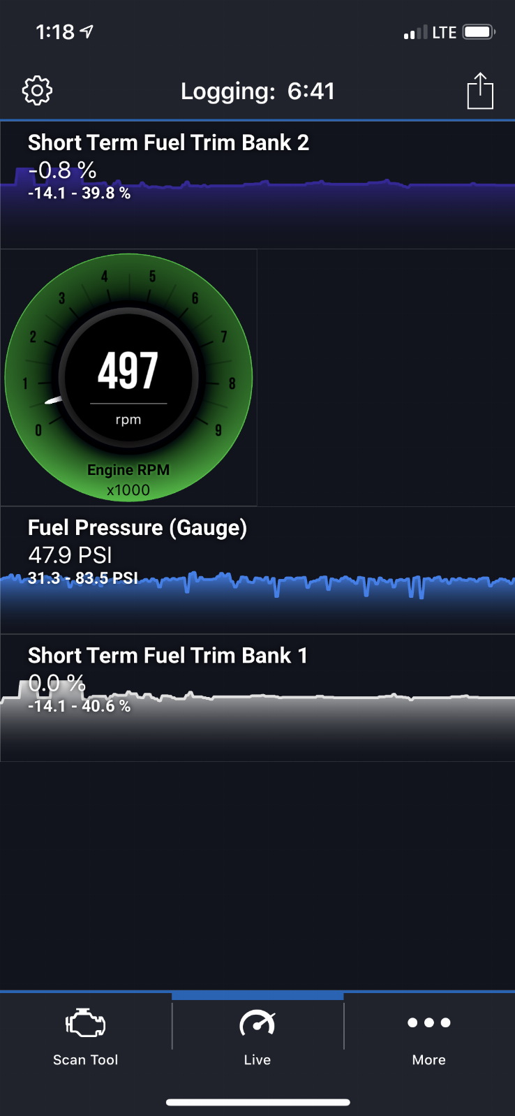

Get your app to show fuel pressure and stomp on the gas to 75 mph on an on-ramp somewhere. If all is well, the pressure will not drop more than a pound at WOT. You guys have a fuel system that I am not familiar with though. Mine runs at 43.5 PSI all the time.

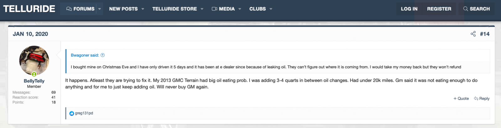

I will give it a whirl and see. I went down the slippery path of arbitration to prep for a court. I am reading in numerous posts that GM's self-appointed "specs" allow up to 3-4 quarts of oil to be added and consider normal... this is out of control.
Mine too has a rough idle. 2018 5.3. The motor mounts were replaced in the fall. In the beginning it seemed to help but it’s back and seems to be getting worse. I’m wondering if it’s destroying the new mounts from the constant movement. I did the fuel pressure test. Got it up to 50 from a dead stop. It didn’t drop. The low reading around 31 was idling in drive stopped. It fluctuated to 45. Do you think this is a fuel delivery problem? I have no issues with acceleration or hesitation.
