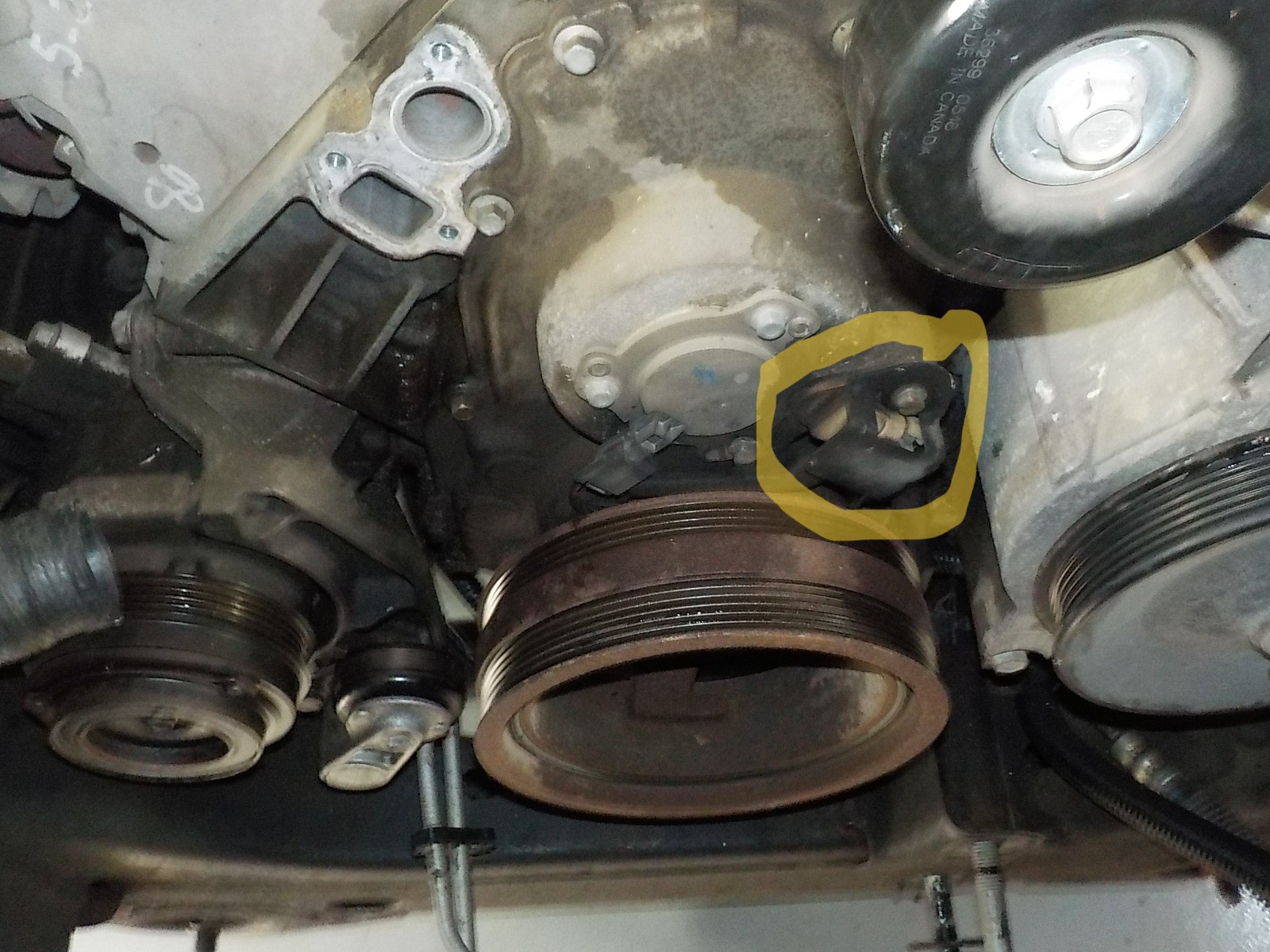

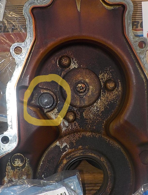

I thought it was up front by the harmonic balancer and timing chain cover on the driver side?
Camshaft position sensor under it own little mounting cover.
And they usually don't comeout without a fight :(
