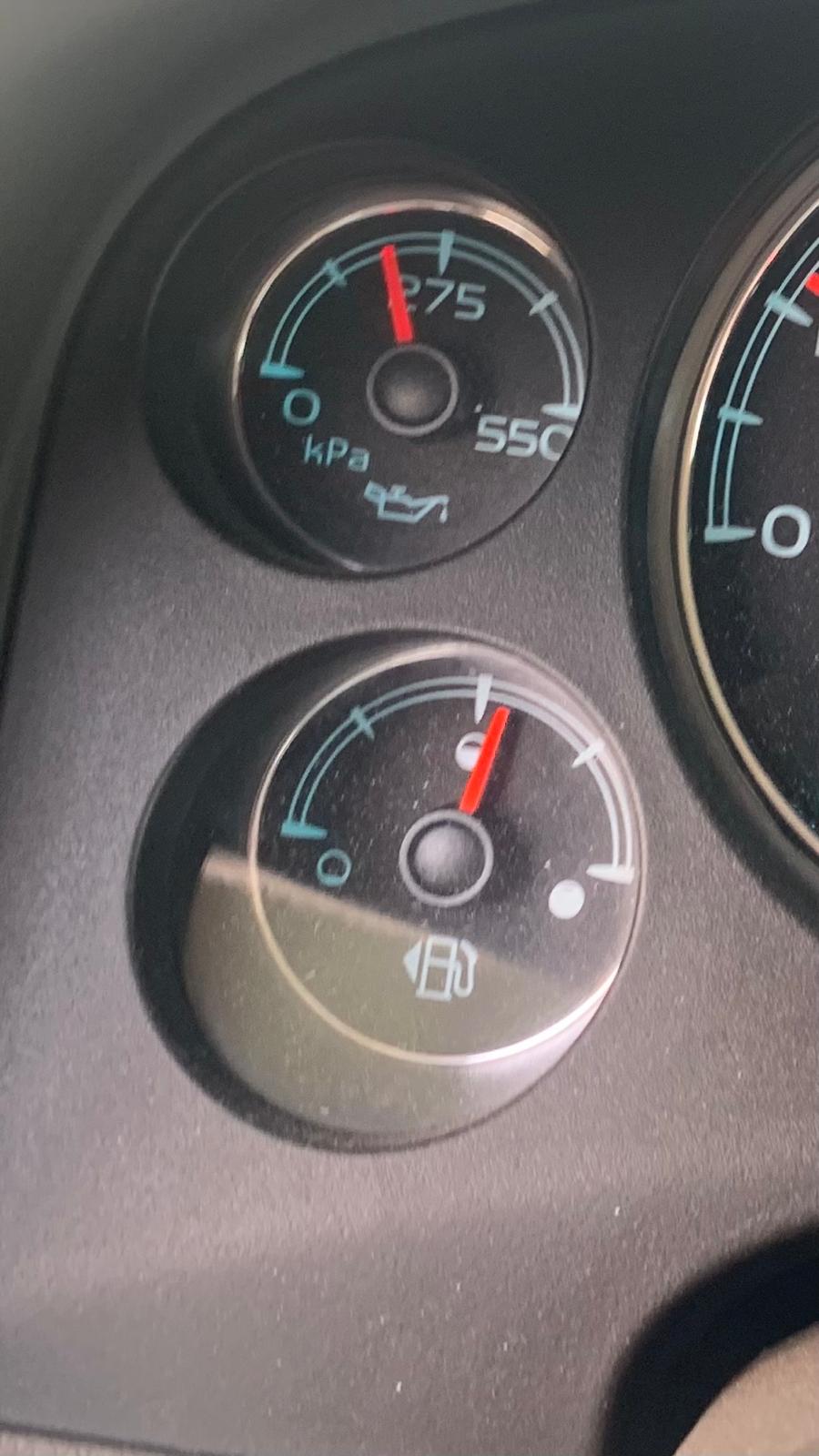

I am noticing the Engine Oil kPA guage is reaching at 275kPa as the photo, is it normal as its below? when I speed and the RPM is 2 its touch 275 mark. So have no idea if its good or bad.
After clearing the P2135 error, its running fine except the above gauge I noticed. So should I wait for the error to reoccur or replace the sensors of the TP?
