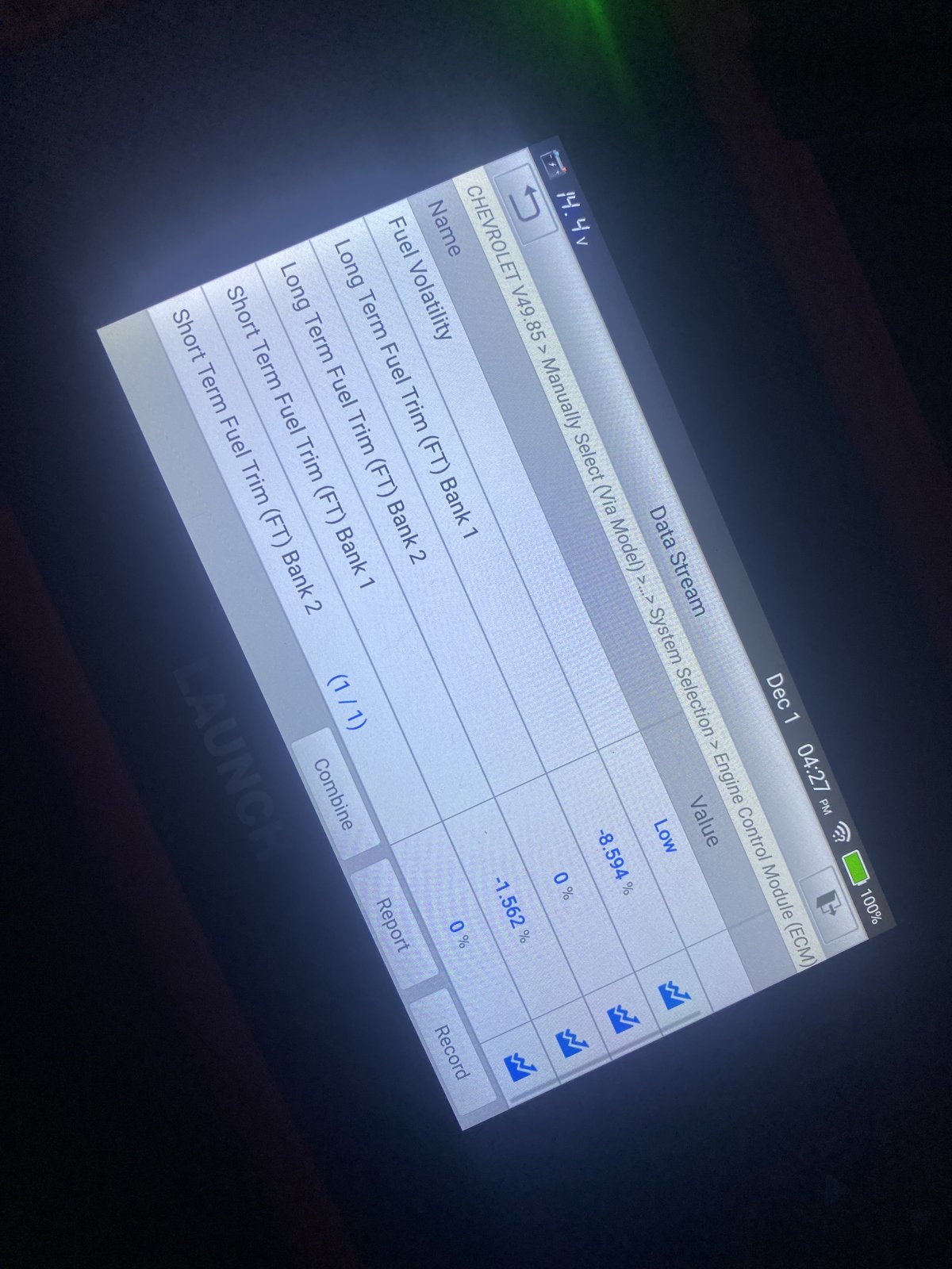

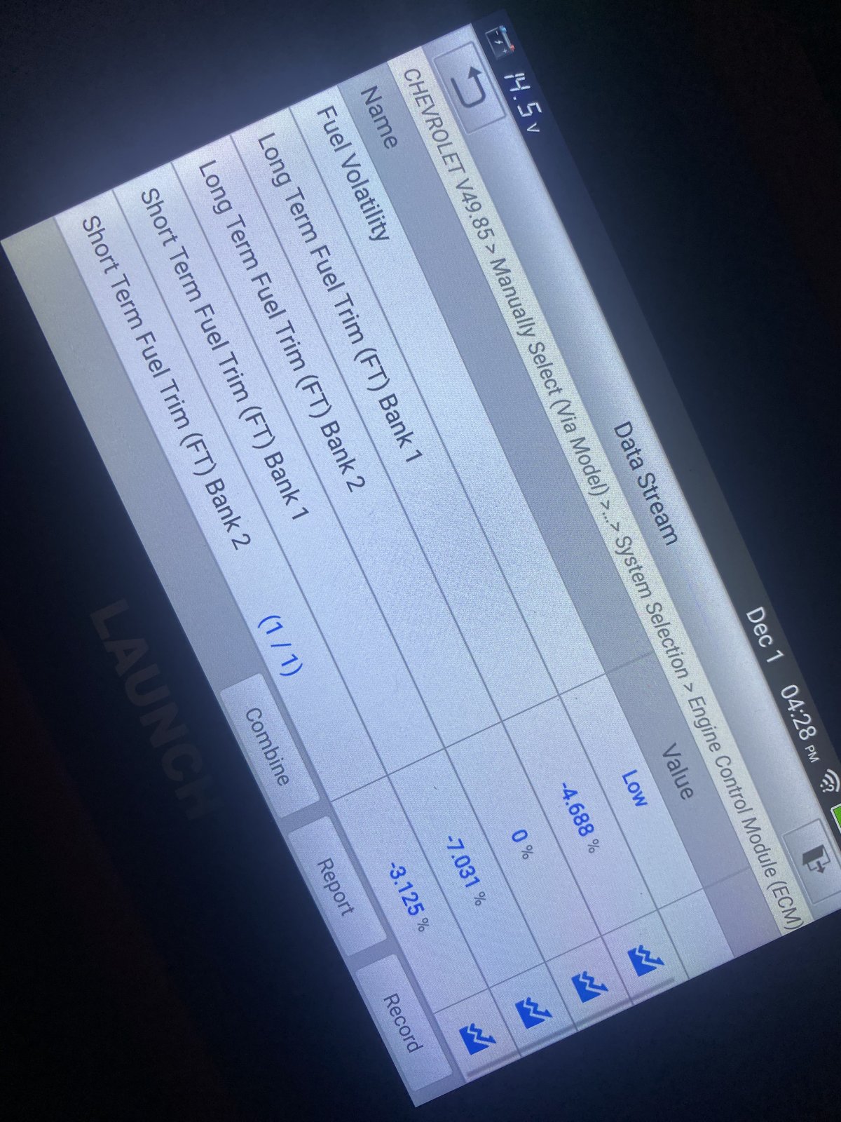

So it’s running the exact same with o2 sensors unplugged. This is the long term and short term trim values at idle with them unplugged

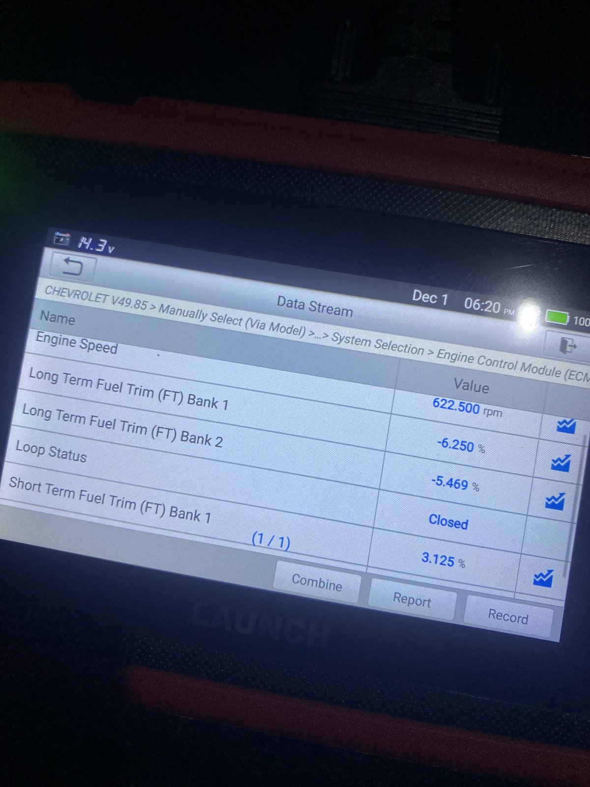

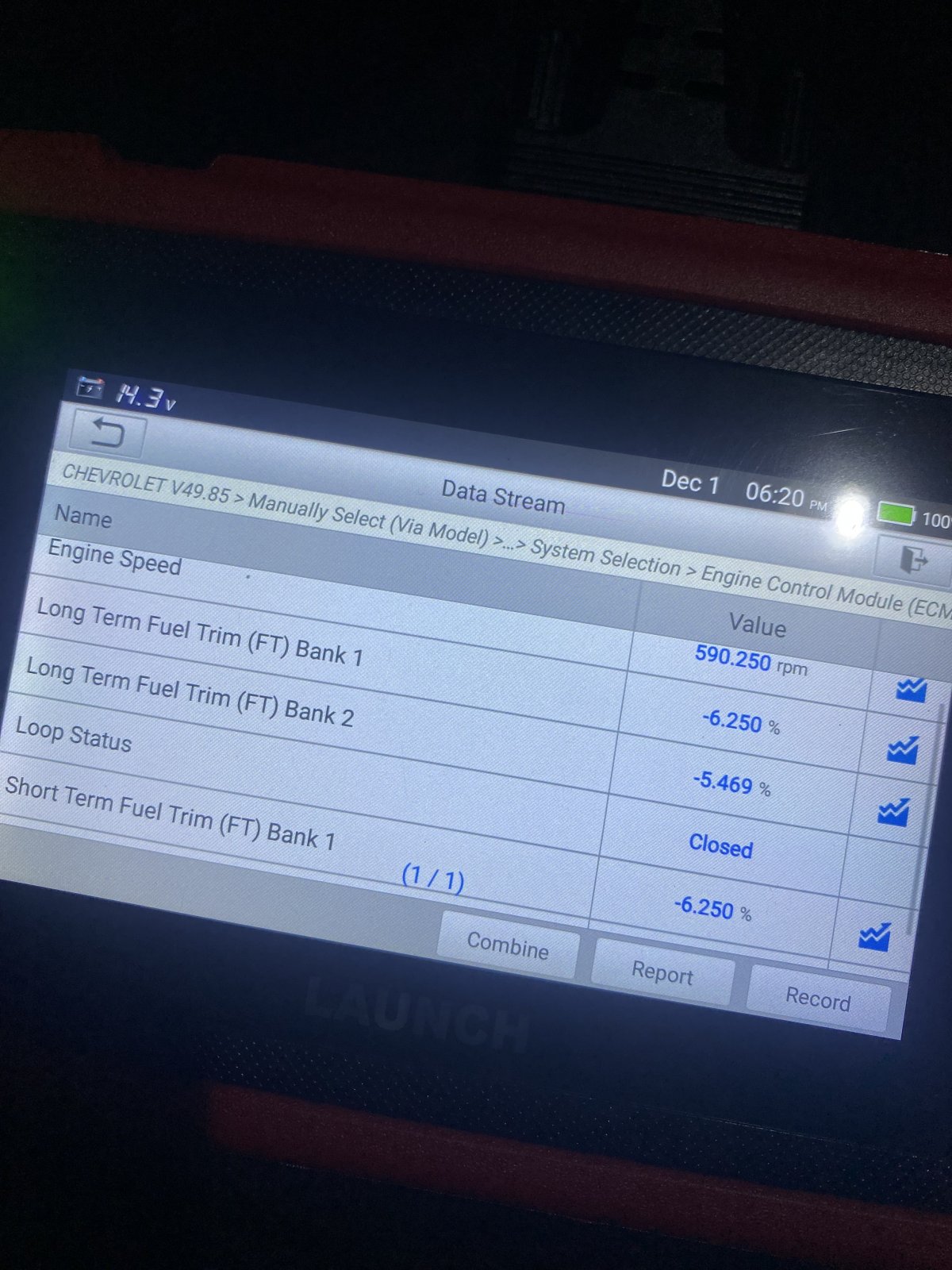

What's different in the captures? RPM? Can you get these values with it showing if fuel control (closed loop) is on, and the RPM at the time?

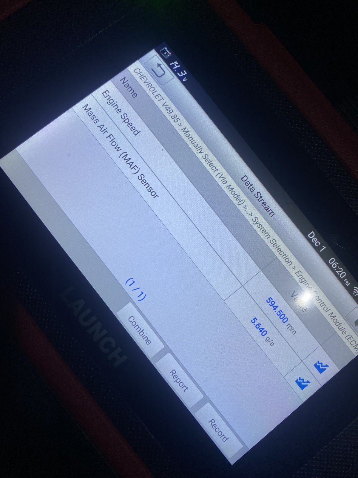

What is the MAF reporting in g/sec at hot idle? And what's the corresponding idle speed?

Those are both at idle. But that’s what it’s jumping between value wise. I can probably get the values with closed loop and possibly rpm at the same time. I’ll also grab the maf and idle

Looks like I can only show loop status or hot open loop.

that's kinda weird it's still removing 8% fuel with the o2s unplugged.
is it possible to clear/reset those? I was expecting trims to be stuck at zero with the o2s unplugged.
edit, and it's in closed loop. yeah that didn't work at all lol.
