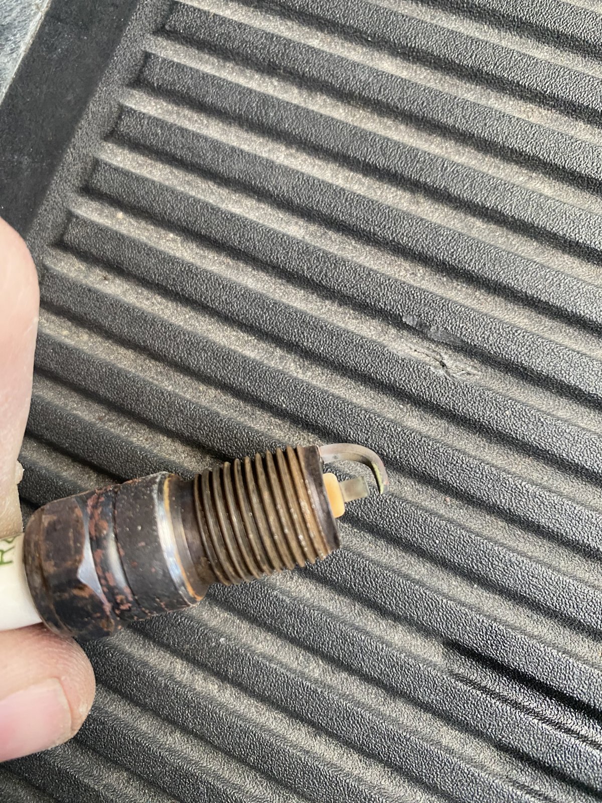

Copper ac delco plugs, ac delco wires. Gap was confirmed before install. I’m not 100 percent sure on injector connectors tbh but could be switched somewhere. I don’t believe so though. Plug wires go where needed. Booster hose is connected. No leak with new intake gasket. Also all new intake bolts. Does have a decent exhaust manifold leak but the manifold bolts are rusted very bad. I just pulled the plugs earlier. I’ll attach a picture. All cylinders besides cylinder 6 are misfiring only at 1100-1600 rpm. And not enough to throw a code but can hear the popping from the exhaust exit

Also plugs are white which usually means it’s running lean correct? But then trims show its adding fuel. So I’m lost haha

Plugs are white.... All of them? Well that would require combustion, which would require compression. I doubt you forgot to put on the intake manifold gasket? LOL. If you're positive there's no vacuum leaks.... Then you should take a close look at your fuel system including the O2 sensors. Plugged catalytic converters or muffler would foul your plugs black. If the fuel numbers are correct and it's running that lean, it's a very large vacuum leak. Try unplugging the large vacuum line to the power brake booster, and plug the port on the manifold. If that fixes it, you have a ruptured brake booster diaphragm.

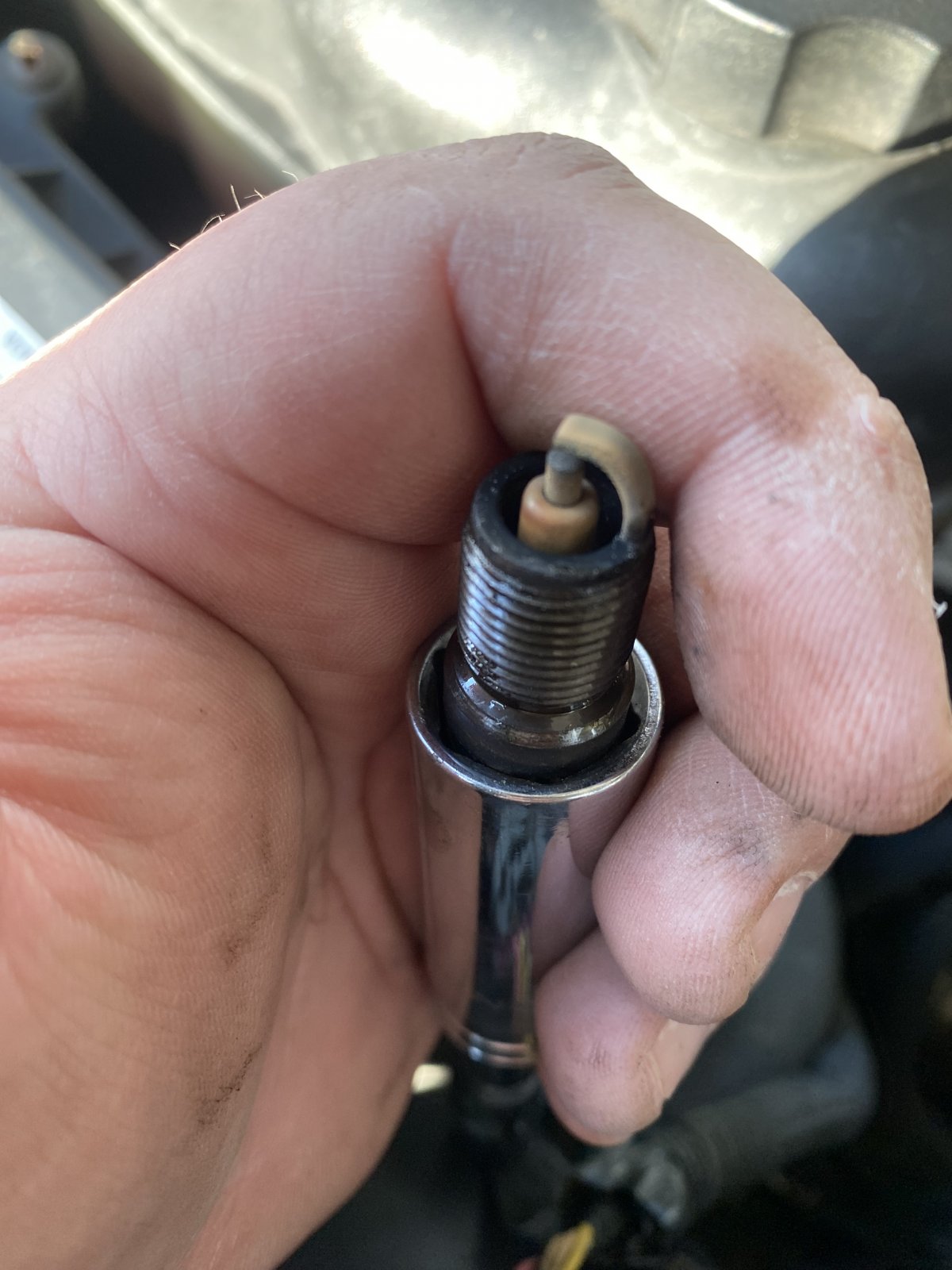

So small update. Here are the compression numbers. Now throwing codes for cylinder 5 misfire and also a p0300, bank 1 lean, oil pressure and a large evap leak. Motor bogs down bad when coming to a slow stop. When it misfires bad the engine light flashes and traction control turns off and stabilitrak turns off. The plug in the picture is cylinder 6 that has the highest compression. I’ve tried swapping plug, coil and wire with 5 and 3. It did not follow to 3. Just gapped all the plugs again. They were at .45. They are now at .40. Also cleaned out all the injectors. I did recently unplug the front o2 sensors and drove it a little bit. Seemed to have some of its pep back but was still misfiring.

View attachment 453525View attachment 453526
