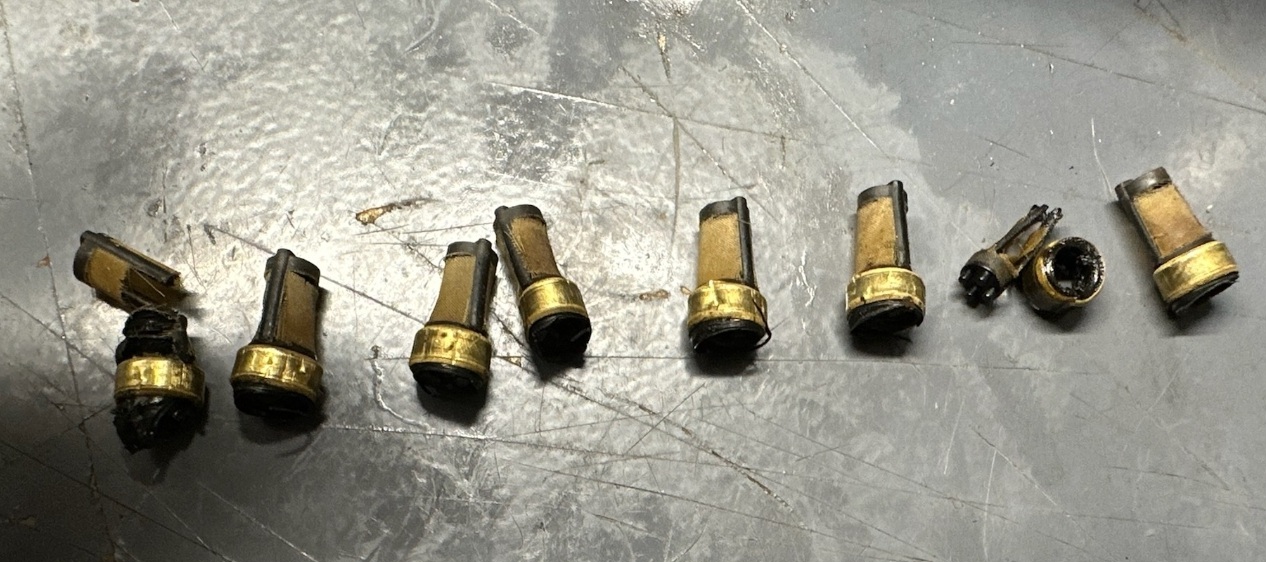

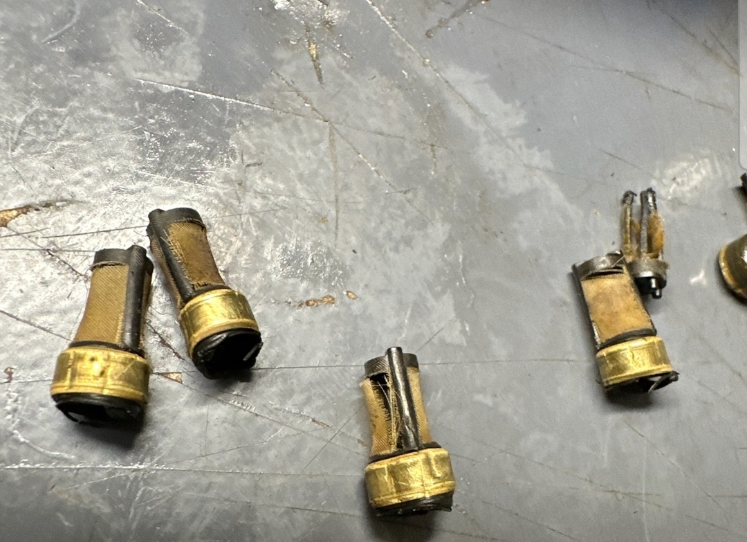

I missed this thread, but @2009TahoeLT what plugs did you use when you replaced them? I hope the OE AC Delco as aftermarket can be very finicky.
Edit to add:
Do you have an aftermarket air filter, oiled? Have you replaced any sensors with non-OE sensors?
I didn't have the issues you do, but an occasional stumble and some slightly higher fuel trims. So with some down time, I had my injectors rebuilt and was surprised to see how bad the screens were.
I also went with new OE plug wires as well as OE plugs, new intake manifold gasket, and OE upstream O2 sensors. All this really evened out my fuel trims and returned my lost few MPG's. To keep everything in check, I also replaced the MAF and MAP sensor with OE.
Pics of my fuel injector screens at approx 150K miles.
I originally replaced the plugs with ngk coppers. Just recently replaced those with ac delco iridium I think. I haven’t torn apart the injectors but I did spray cleaner through them to check flow and clean. I have replaced with ac delco wires, 4 coils, metal upgraded intake manifold gasket. 1 ac delco o2 sensor. I have not replaced the maf sensor but it was cleaned. I had bought a new map sensor but truck wouldn’t even start with the new sensor so I put the old one back in lmao. Also stock air box and filter replaced maybe 6 months ago
