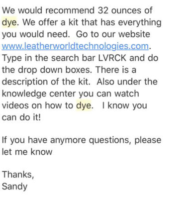

This place also sells what is needed here is a copy of a email from them with instructions on how it o get the product to do just thay
