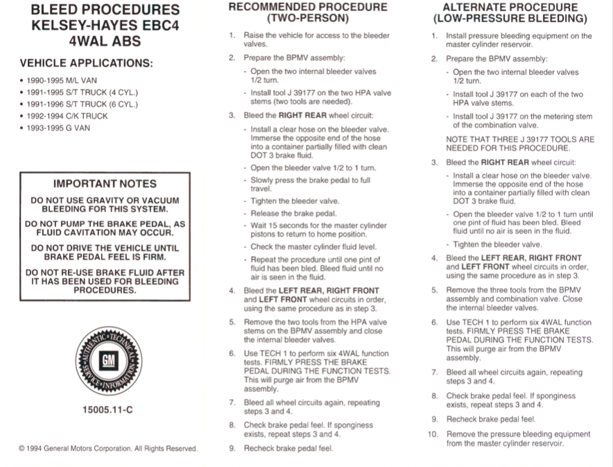

You can 'bleed' the ABS some without the Tech1 by setting it off. 25mph and brake ******* loose ground 2-3x then bleed the system again. If that helps, might try it again.
I'm also pretty sure the single man bleed is not efficient enough as I spent a ridiculous amount of time and fluid on it alone. Two man is the recommended procedure.
You also need a tool for the brake proportioning valve on your 92.

What a mess. Maybe I will need to try another MC, as I don't know if it has been damaged now. The truck no longer has ABS, that has all been removed. I did do a 2 man bleed, with my helper holding the container with the hose in it, while controlling the bleeder as i pushed the pedal. Zero air bubbles at all 4 corners. As far as the rubber brake lines, they do look fine but I imagine new ones would help. From what I understand these trucks always had a ****** pedal, my dad's 98 does too, he complains about it often. My goal is just to get the truck to stop safely. The pedal will slow the truck to a stop, but the pedal keeps traveling slowly.
