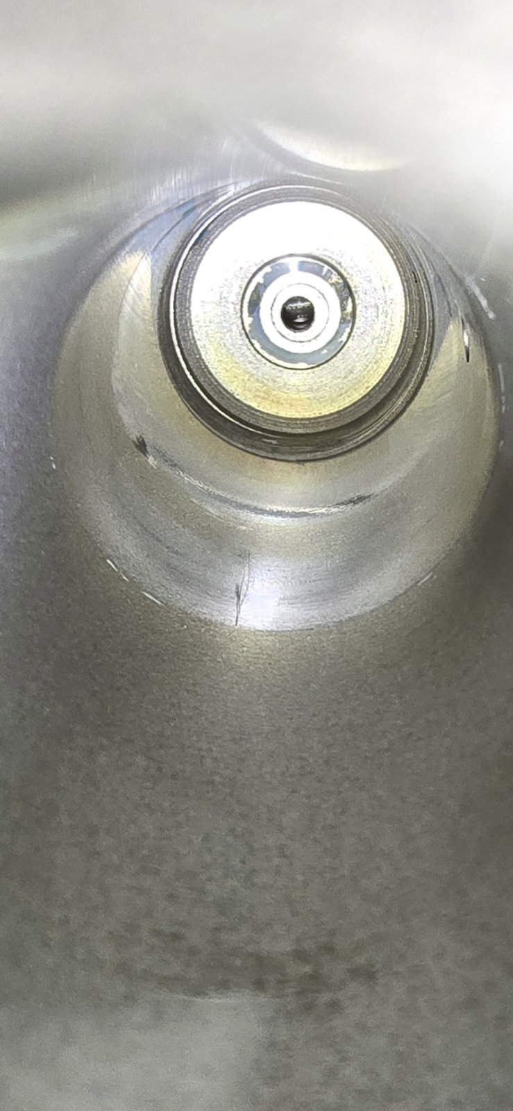

All signs pointing to good booster, but bad master cylinder, removed master cylinder and torn down.
You can definitely see the wear in the tube from its 19 years of service. But, you can also see a scratch right thru a wear mark.
To be clear, no tools went that deep up in there, just a lint free right off the roll, soaked in brake clean, and my fingers.
Plunger was also stubborn to remove. Instructions stated to push in with phillips head, remove snap ring, slowly retract and plunger will come out with spring pressure. Yea, no it didnt. Had to do som poppin to get it out.
