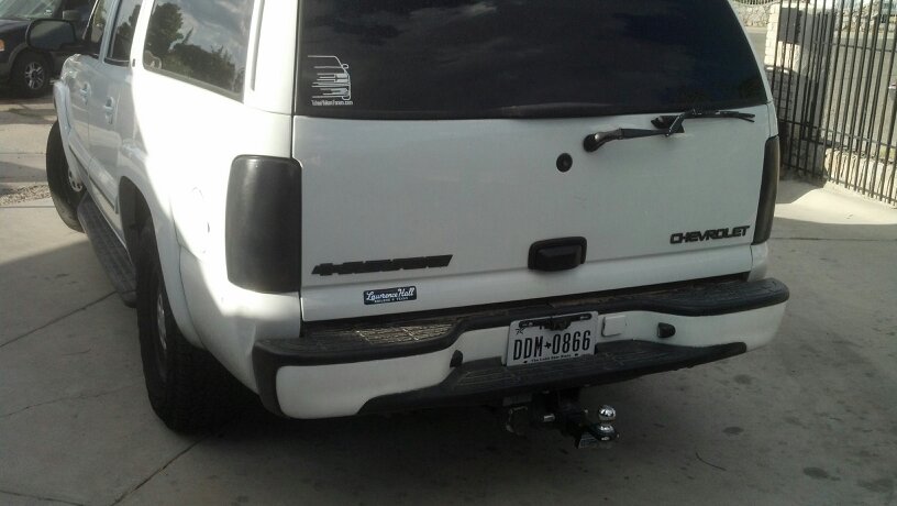

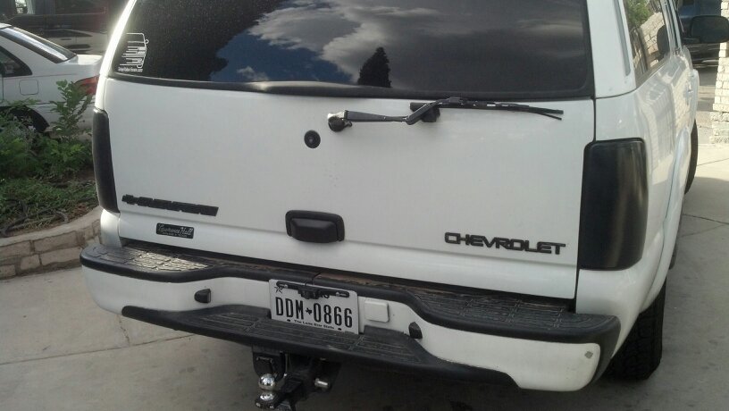

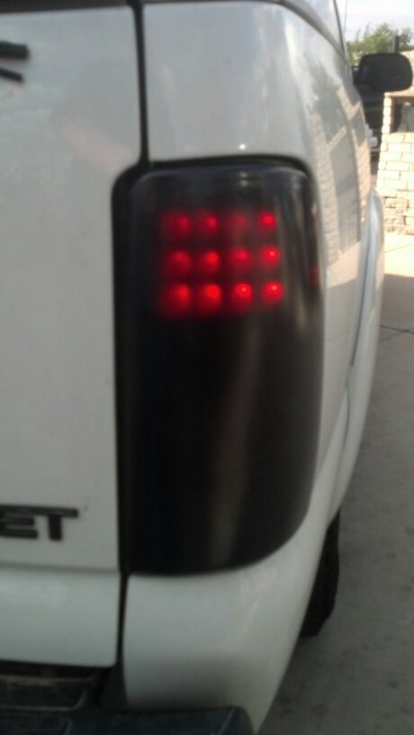

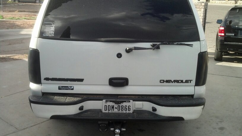

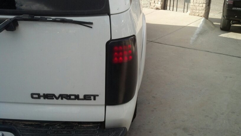

I tinted my tail lights today with Smoke from Plastidip. Since it is plastidip I can peel off whenever.

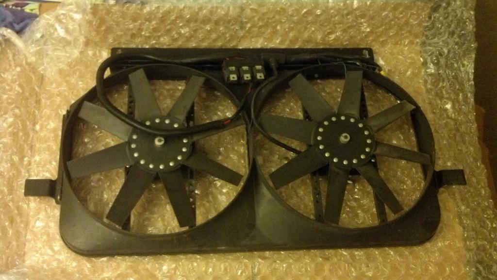

It came with a harness that looks really good. It will be hooked up to the computer and an external temp probe instead of the a/c hook up.

Update:
Got the e-fans in and are working flawlessly. Been chatting with Ezdaar a lot on what other mods to do and we have come up with a whole bunch of awesomeness.

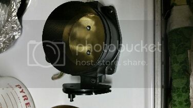

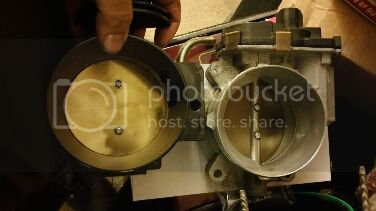

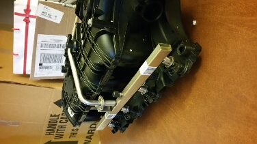

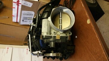

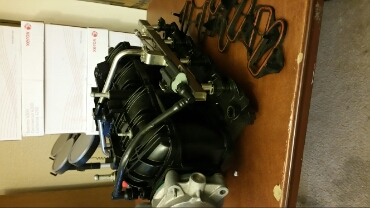

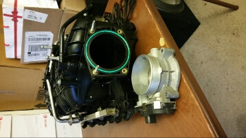

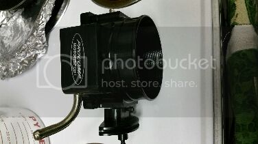

Now for manifold/TB ****:

So the TBSS manifold is a direct swap onto a 5.3?
Yes, tons of people have done this swap. It is probably the most popular manifold swap out there. Only thing that was hard to do was find a cable driven throttle body since I am not drive by wire.
