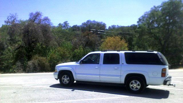

2002 Chevrolet Suburban. Bought back in August of 2011 for $10,000 with only 63,500 miles from a vet that only drove it on vacations and when needed for bigger tasks. All the rest of the time it was covered up in the garage. He was the original owner.
First thing we did was take it on a 2500 mile trip with the family

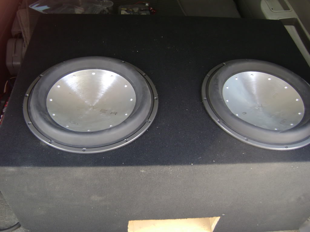

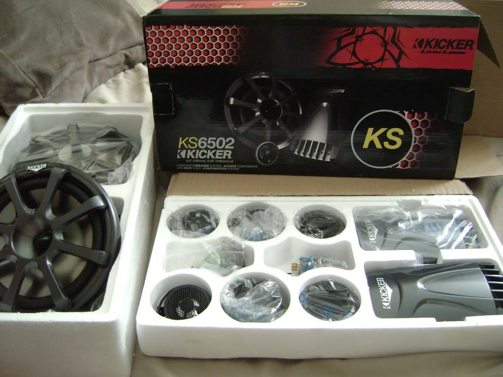

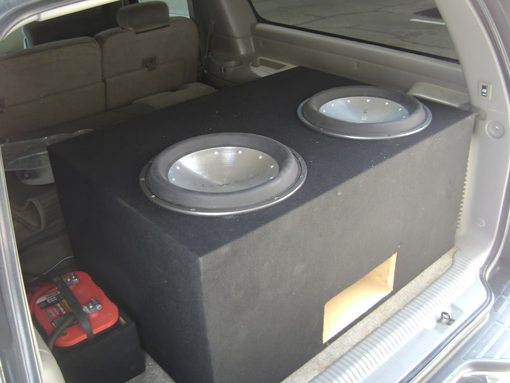

First mod I took my system out of my 2001 yukon xl and bought new door speakers and put it in the burb.

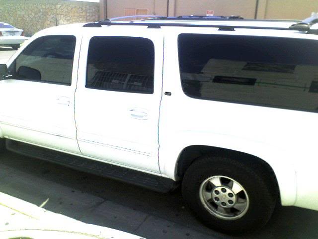

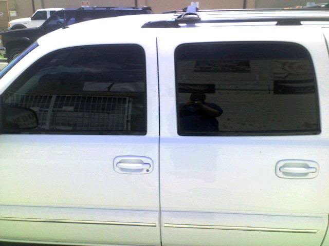

Then I got the windows tinted, 20% up front, 5% over factory on the rest

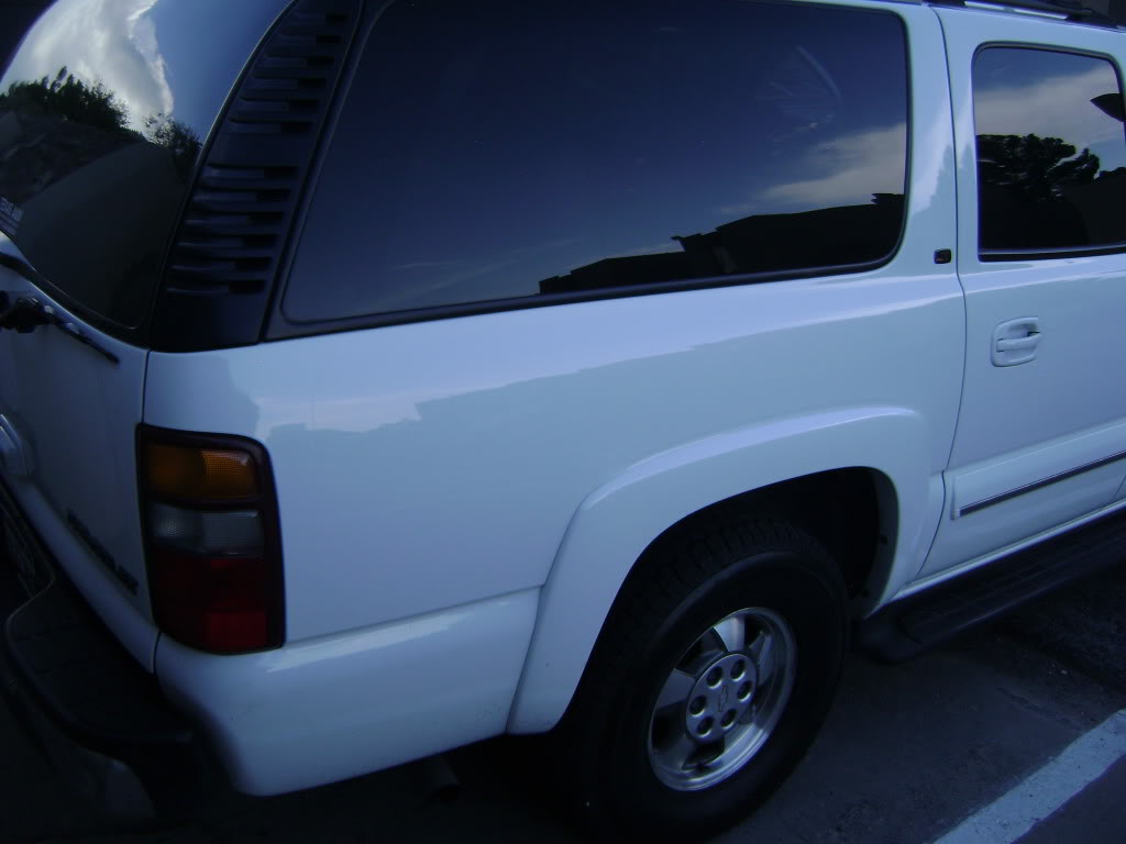

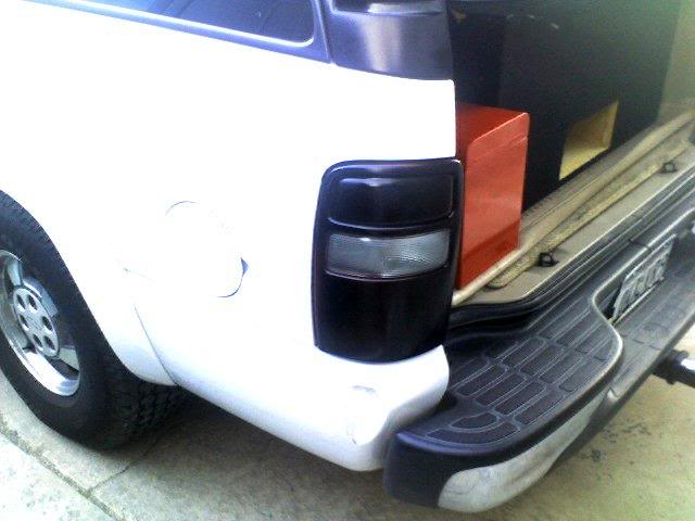

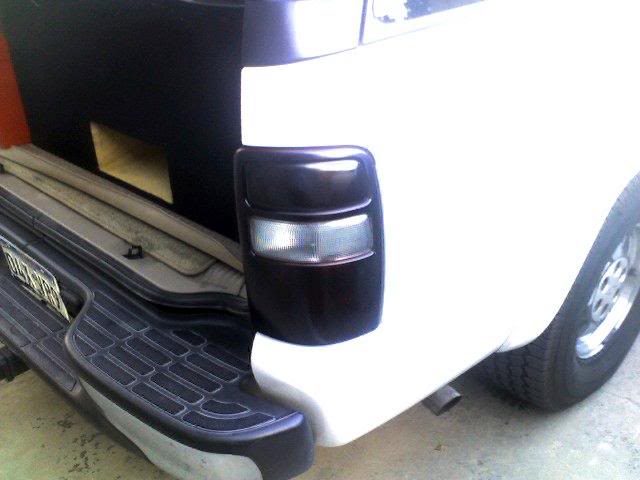

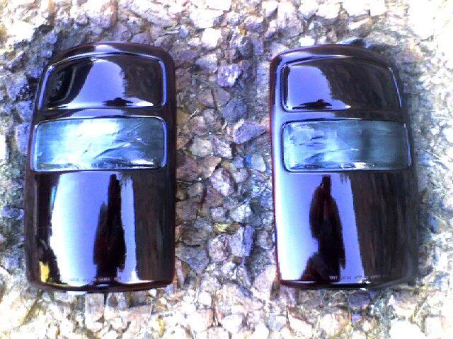

Then I tinted the tails and front bumper lights

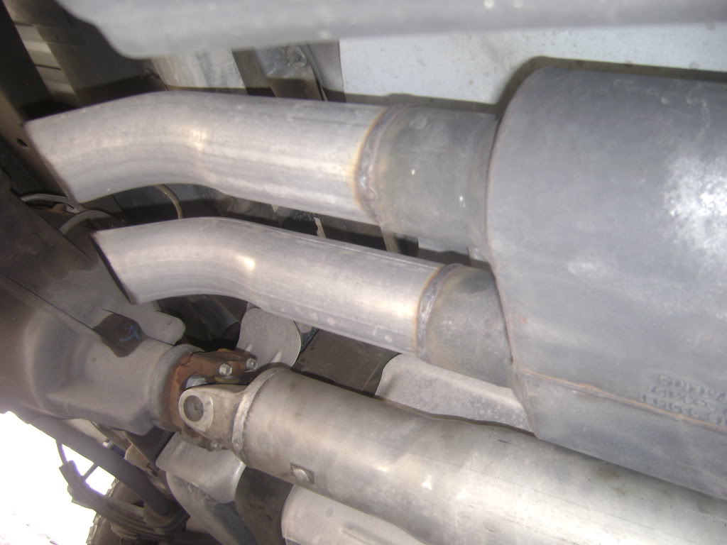

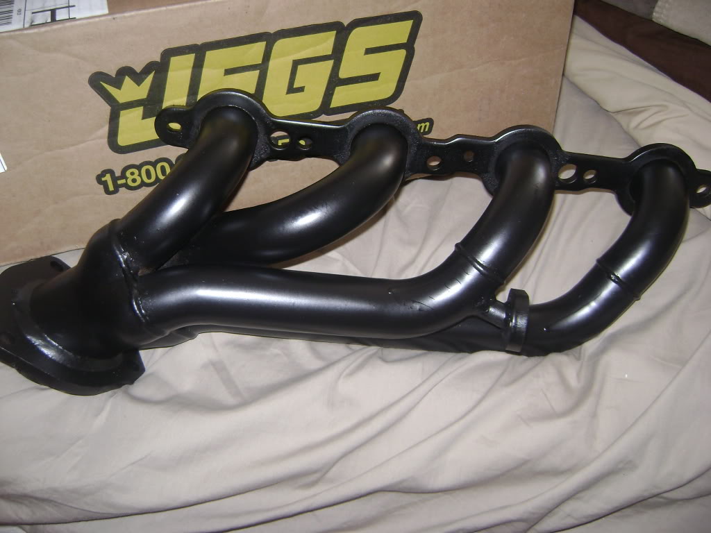

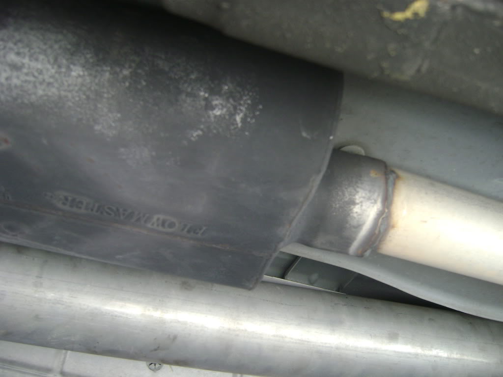

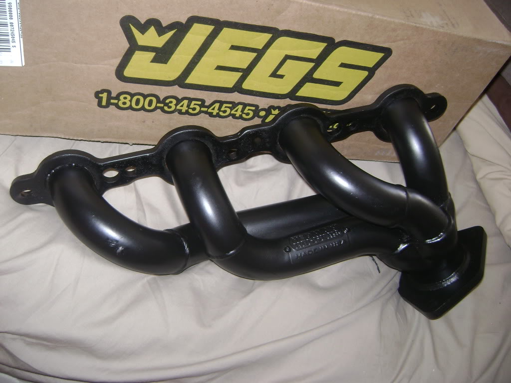

Then I got headers and a flomaster super 44 for it

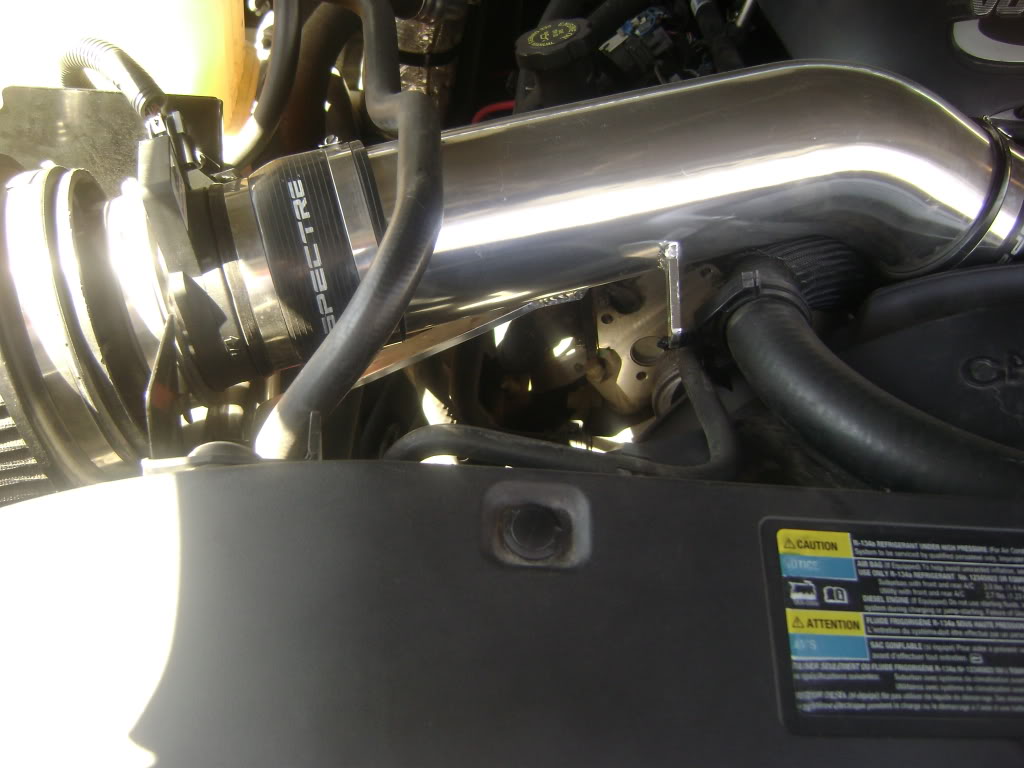

I also took my CAI out of my xl and put it in the burb

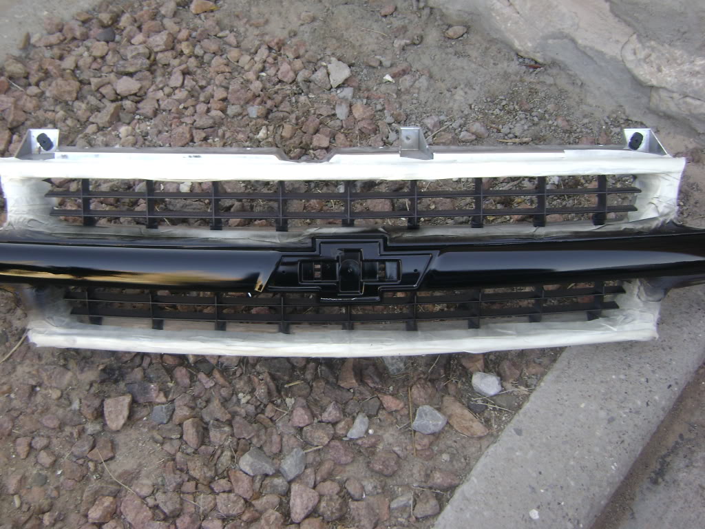

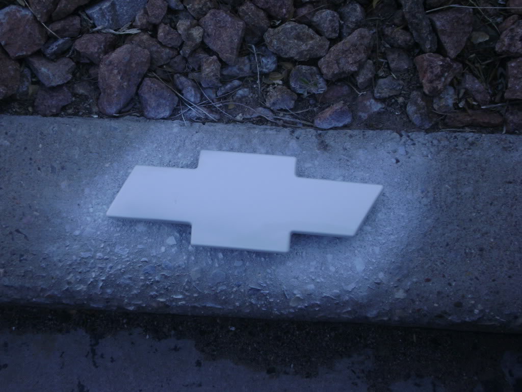

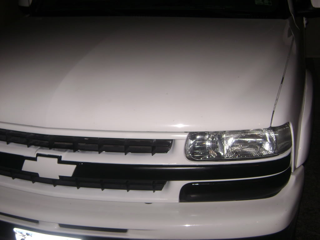

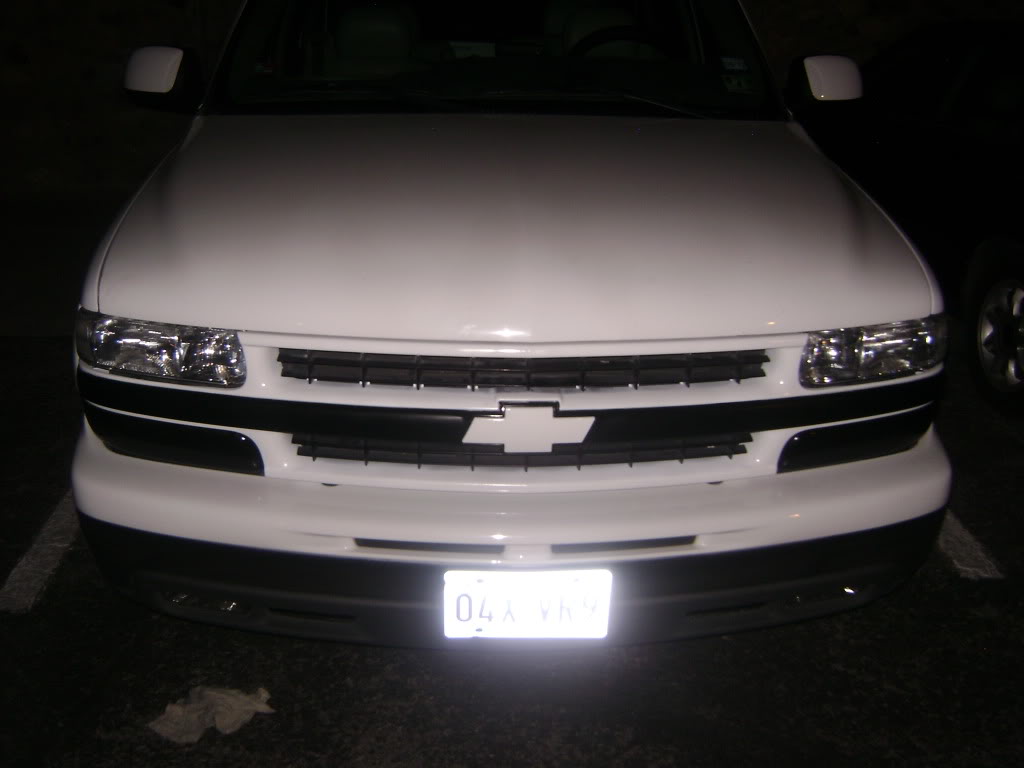

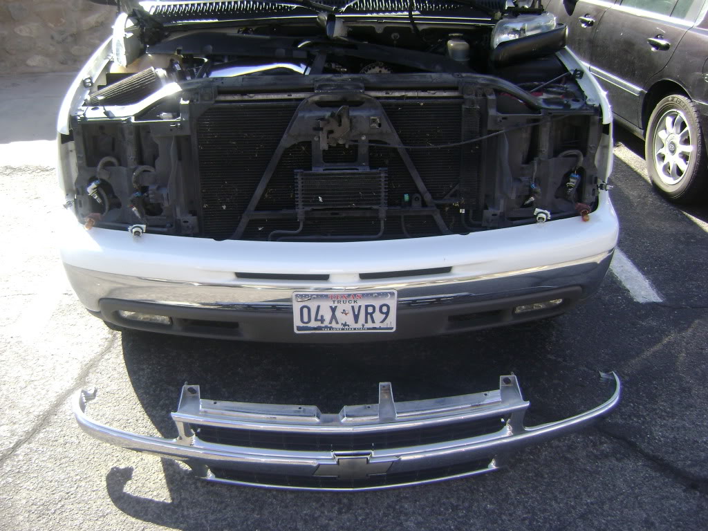

Then I painted the grill shell and bowtie

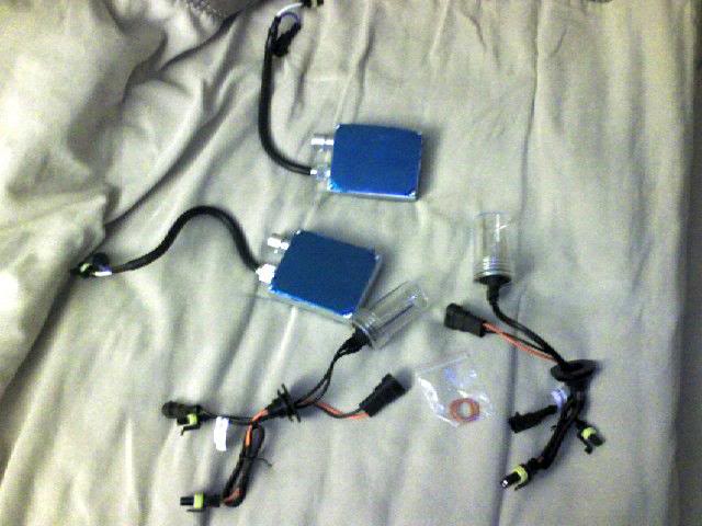

Then I bought 5000k HIDs from DDMtunning (dont have pics of them installed)

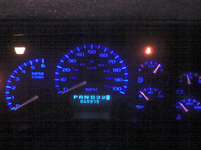

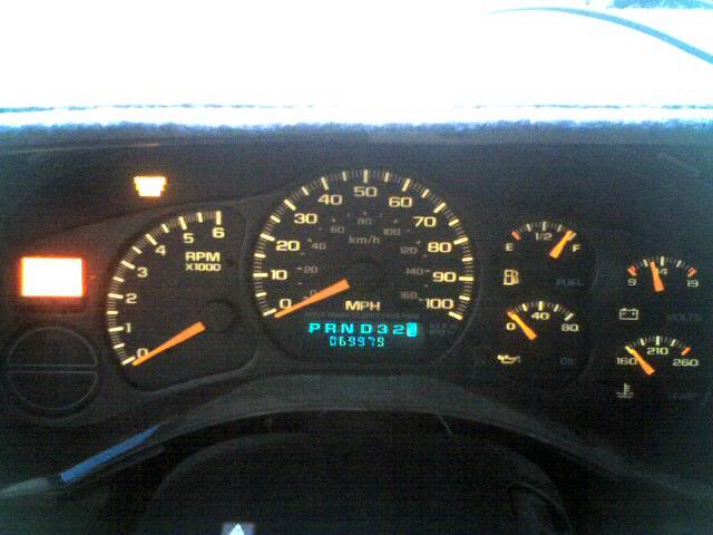

Then put leds into the cluster
Before
After

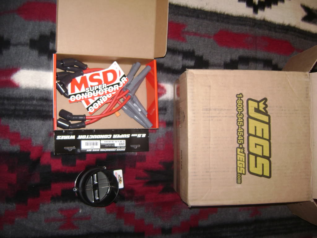

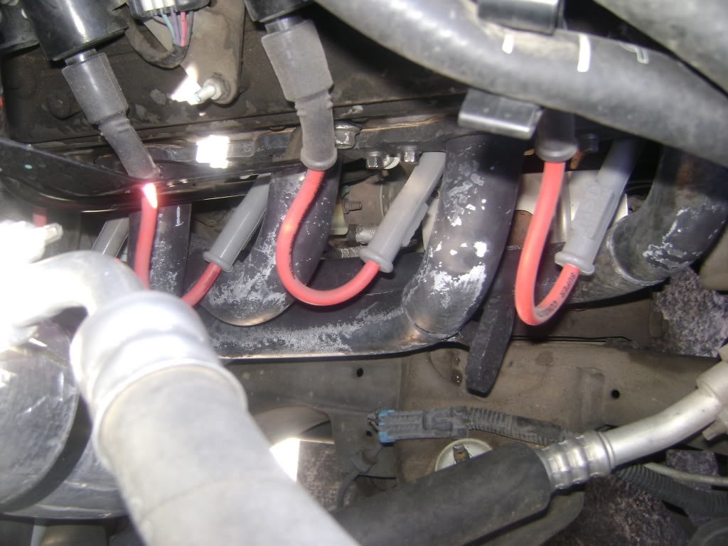

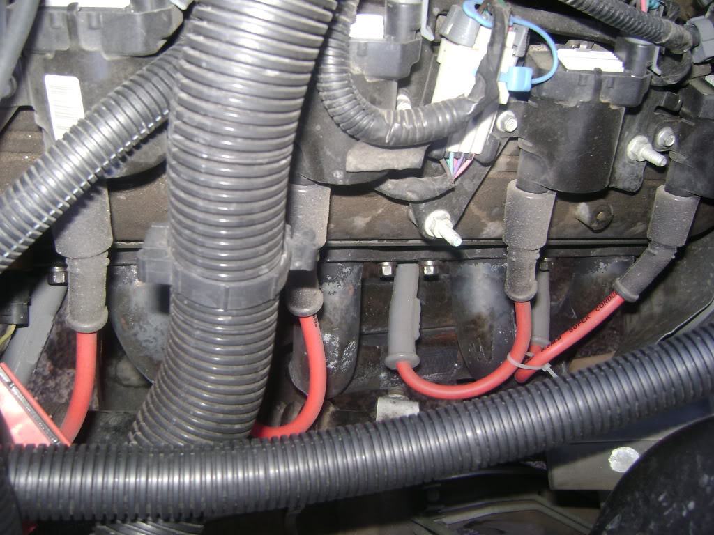

Then bought MSD 8.5mm wires and high flow MAF sensor

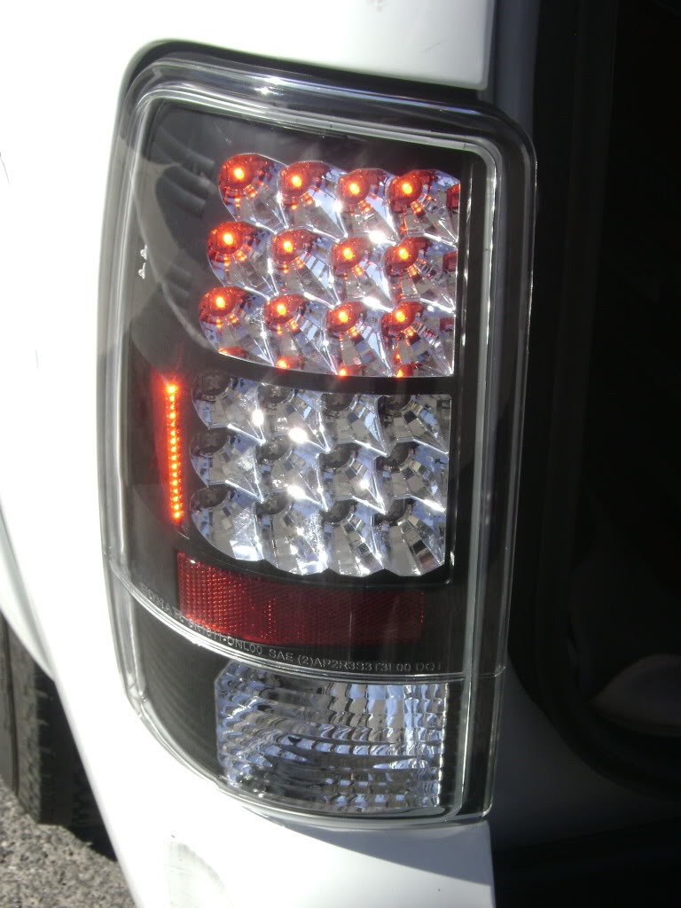

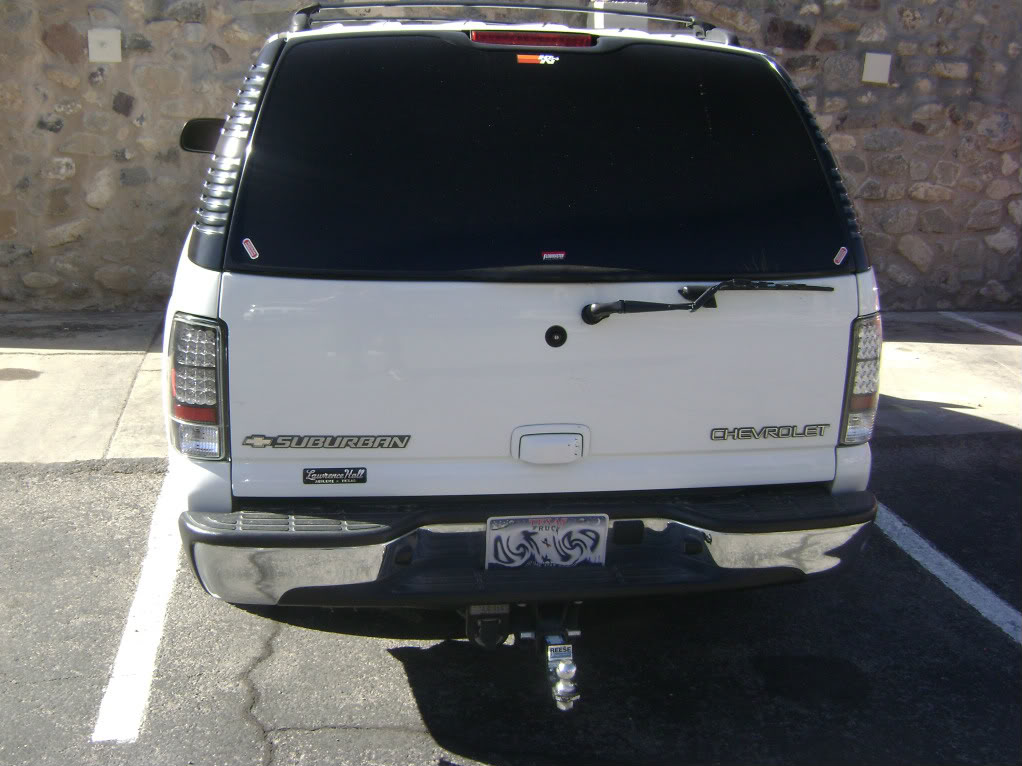

Then LED tails

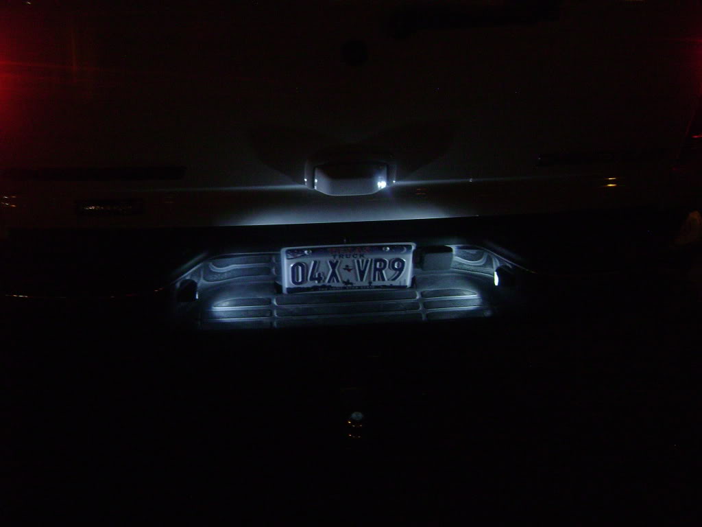

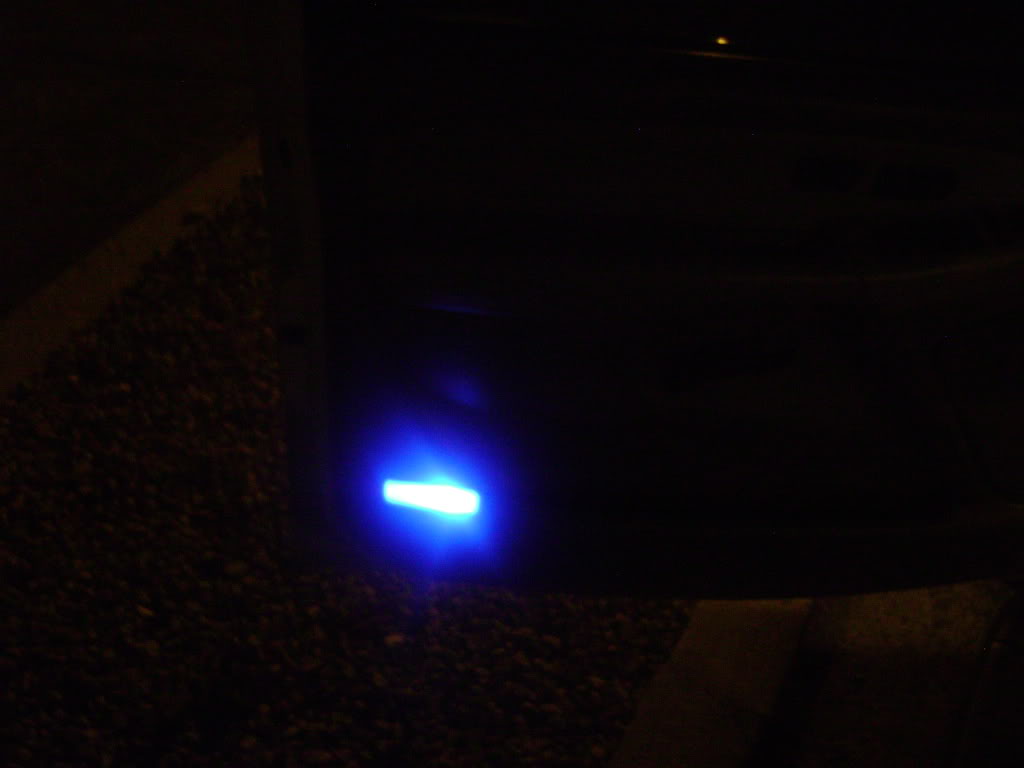

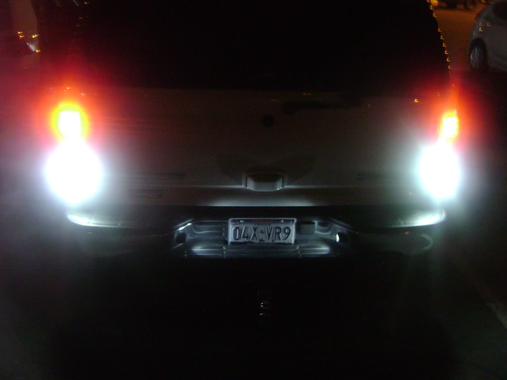

Also put LEDs in reverse and plate bulbs

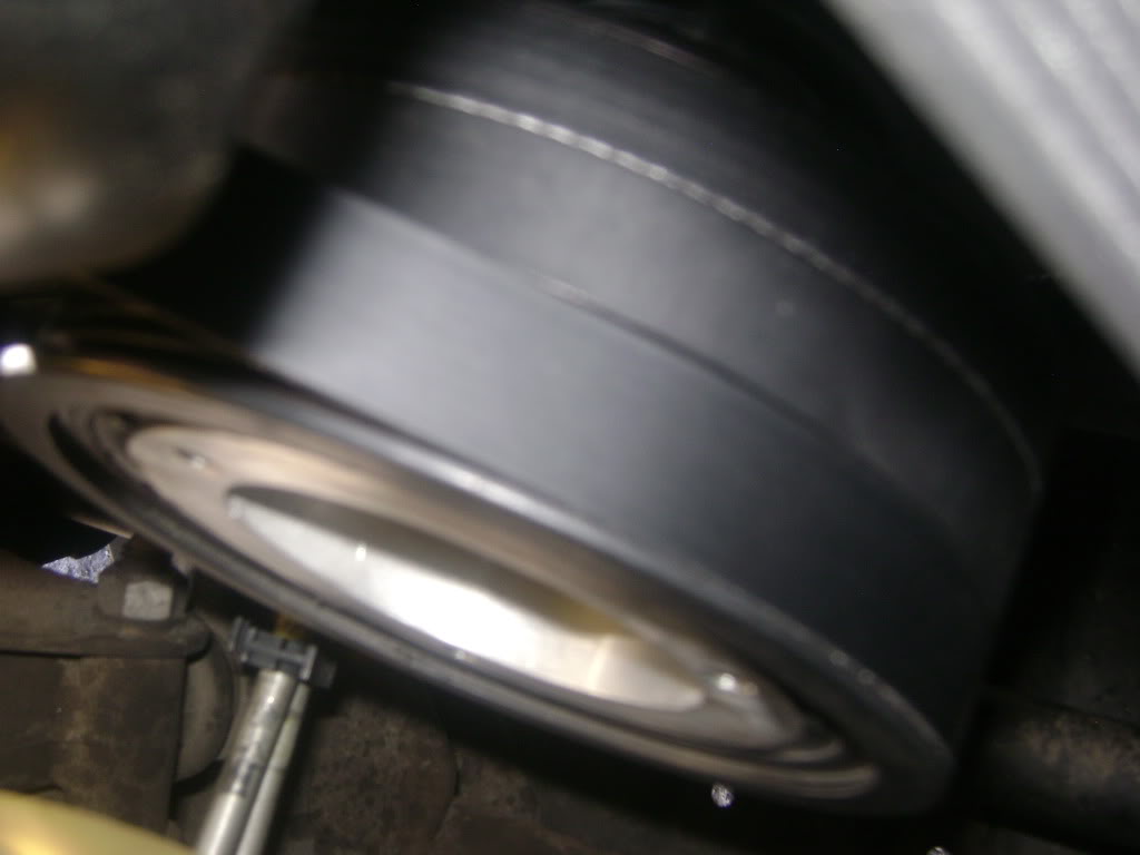

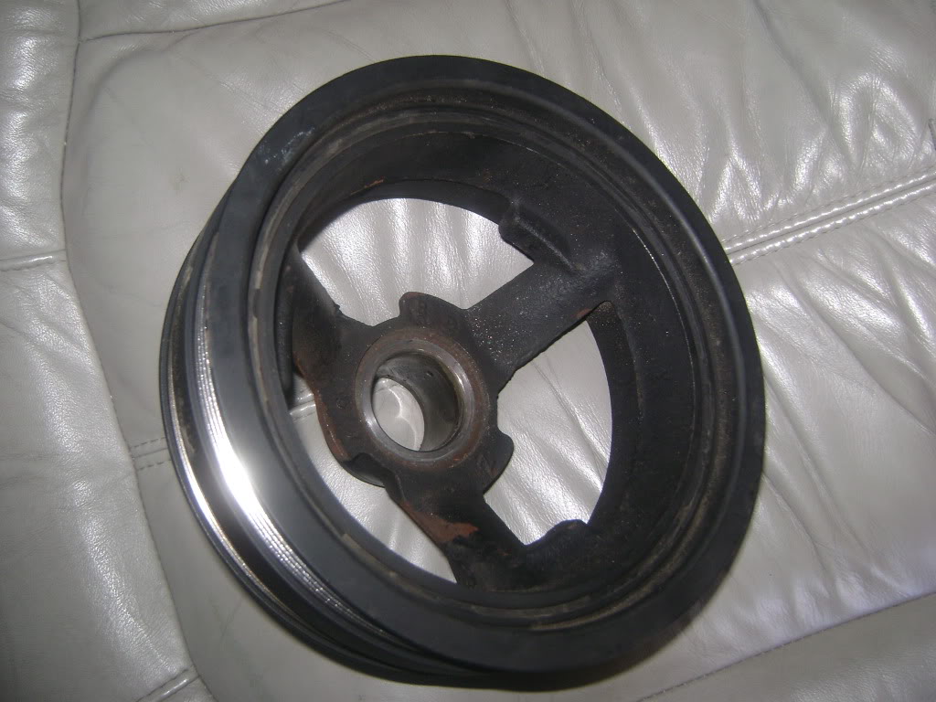

Then an Underdrive Pulley
Old
New

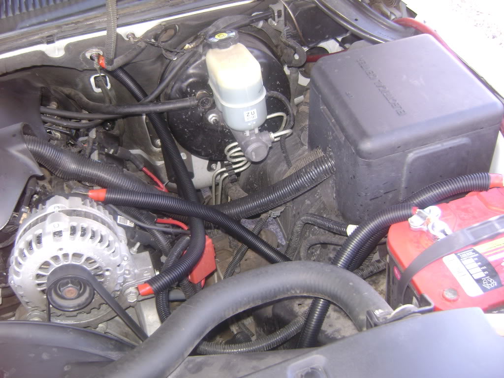

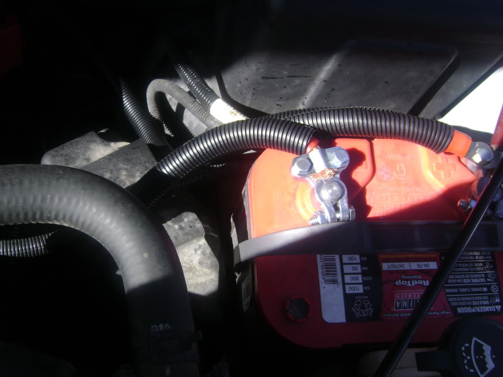

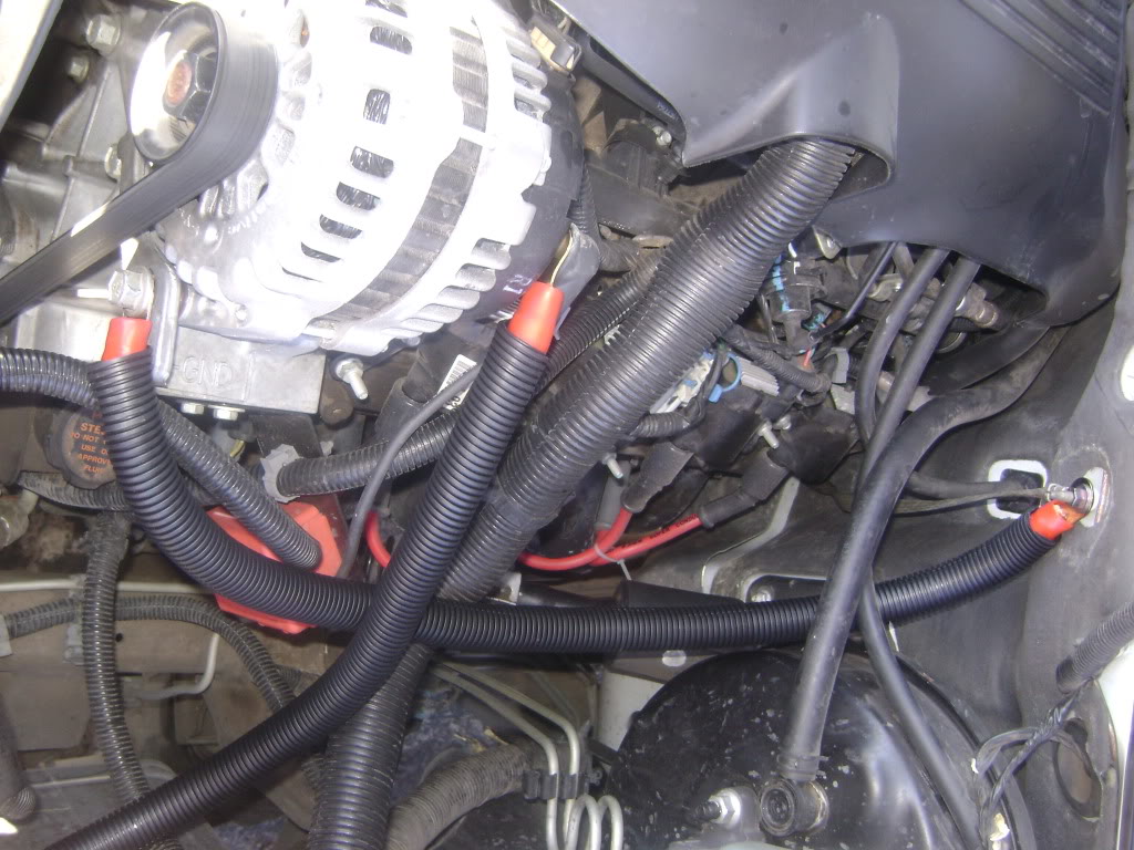

Then the Big 3

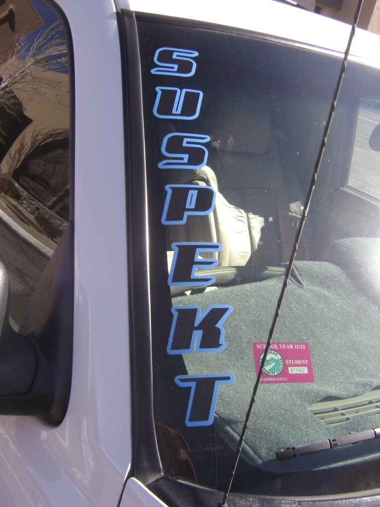

Then put the teams sticker on

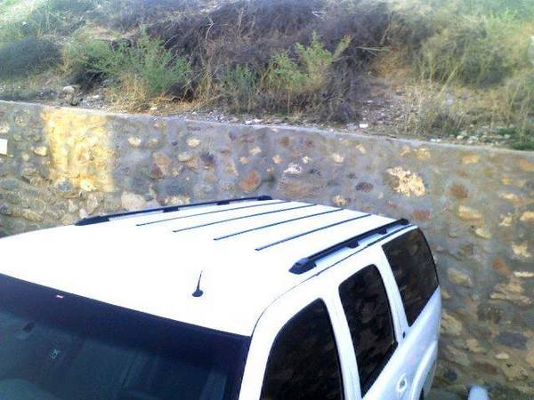

Deleted the Roof Rack Cross Rails

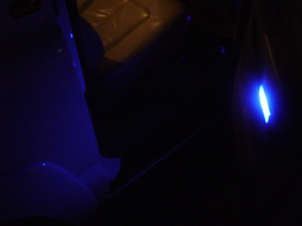

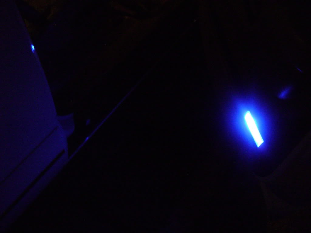

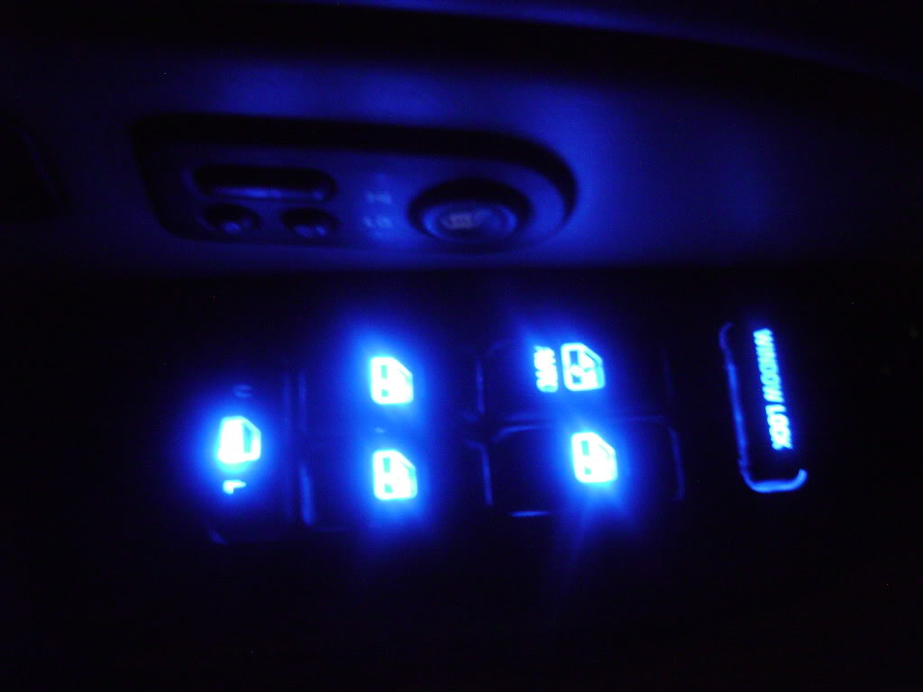

Then put moar LEDs in the interior

But I still found time to mod this beast. Since the leds I have plastidipped a few interior panels to white, redone the grill shell in black and white plastidip for durability and the paint was chipping off. I have plastidipped the rims black to look like police inteceptor rims.
