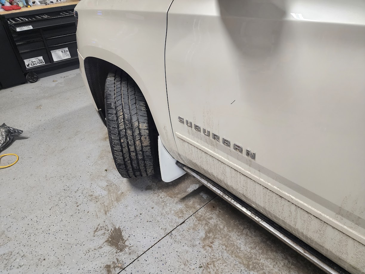

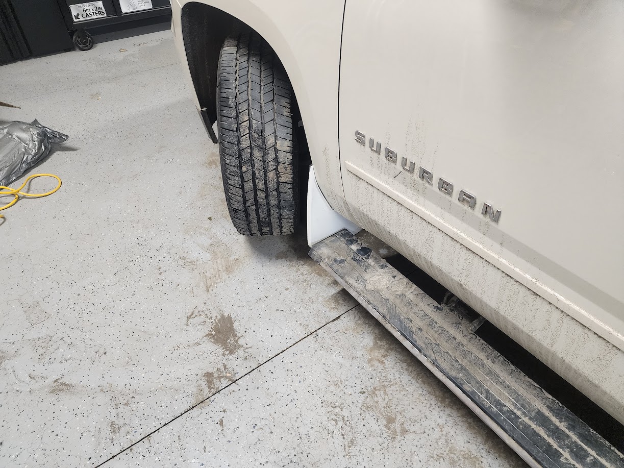

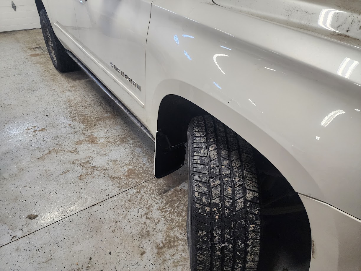

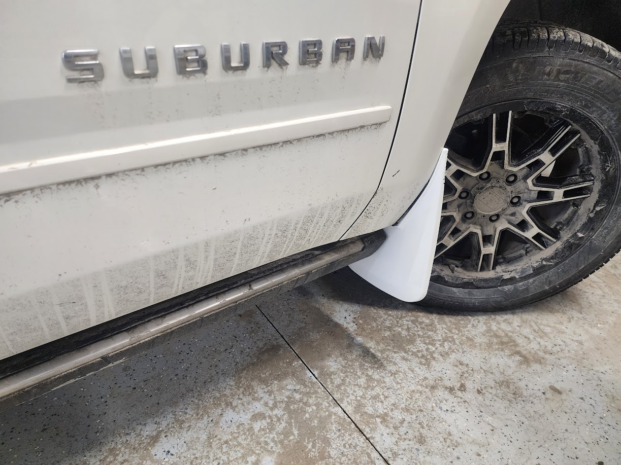

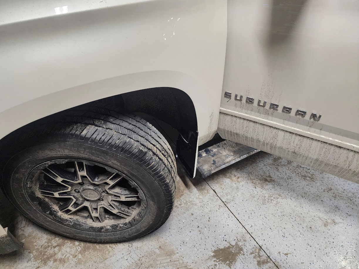

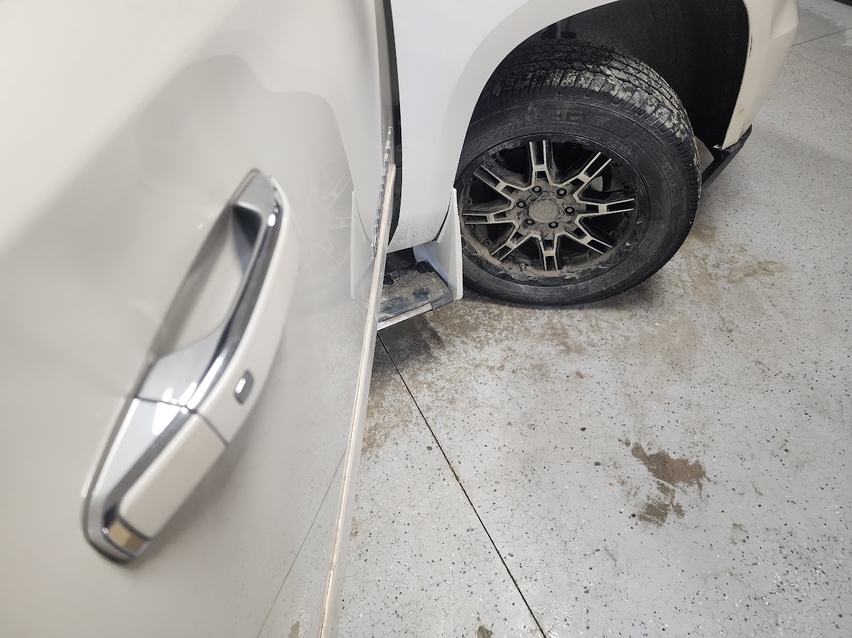

In the meantime, i did look up my paint code, as some of you might remember, and painted some mud flaps. While they do look good, and will be very functional. the paint color uh....yeah, doesn't match. i realize the pearl can be a PITA to match, but this paint matches the wife's Acadia and my buddies 19 truck, not the burb. I might try and see if i can find a better paint match, or worst case i have a buddy that paints show cars. i could probably talk him into paint matching them for me.....but anyhow. These are Husky liner front mud flaps. We live on dirt/gravel roads. Husky PN 58201 Perfect fit, was easy to paint with minimal prep. they should do their job to help protect the paint and the sides from the tires throwing to much debris. The factory rears were paint matched so i figured i'd give these a shot at paint matching. The interiors i painted with rattle can bed liner, and we will see how much it annoys me or not. maybe once the paint is dirty it won't be noticeable....
They are installed using 3 T15 screws that are already holding things together, turn the wheel unscrew, install. nice and easy
Passenger side
Driver's side

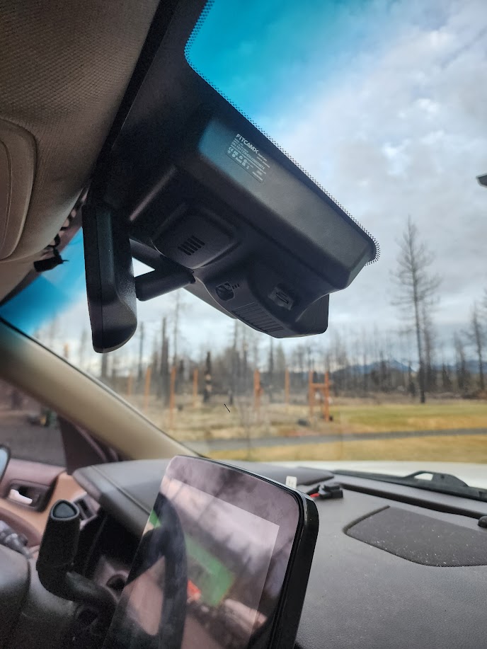

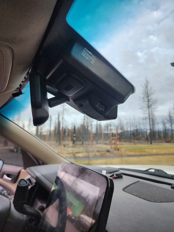

Oh, also installed a dash cam last night. easy install, although i swear i wish they would give just a little more room on the T Harness and just a little more room in the plastics to stuff them away

More info the camera, pretty easy installation if anyone is interested
