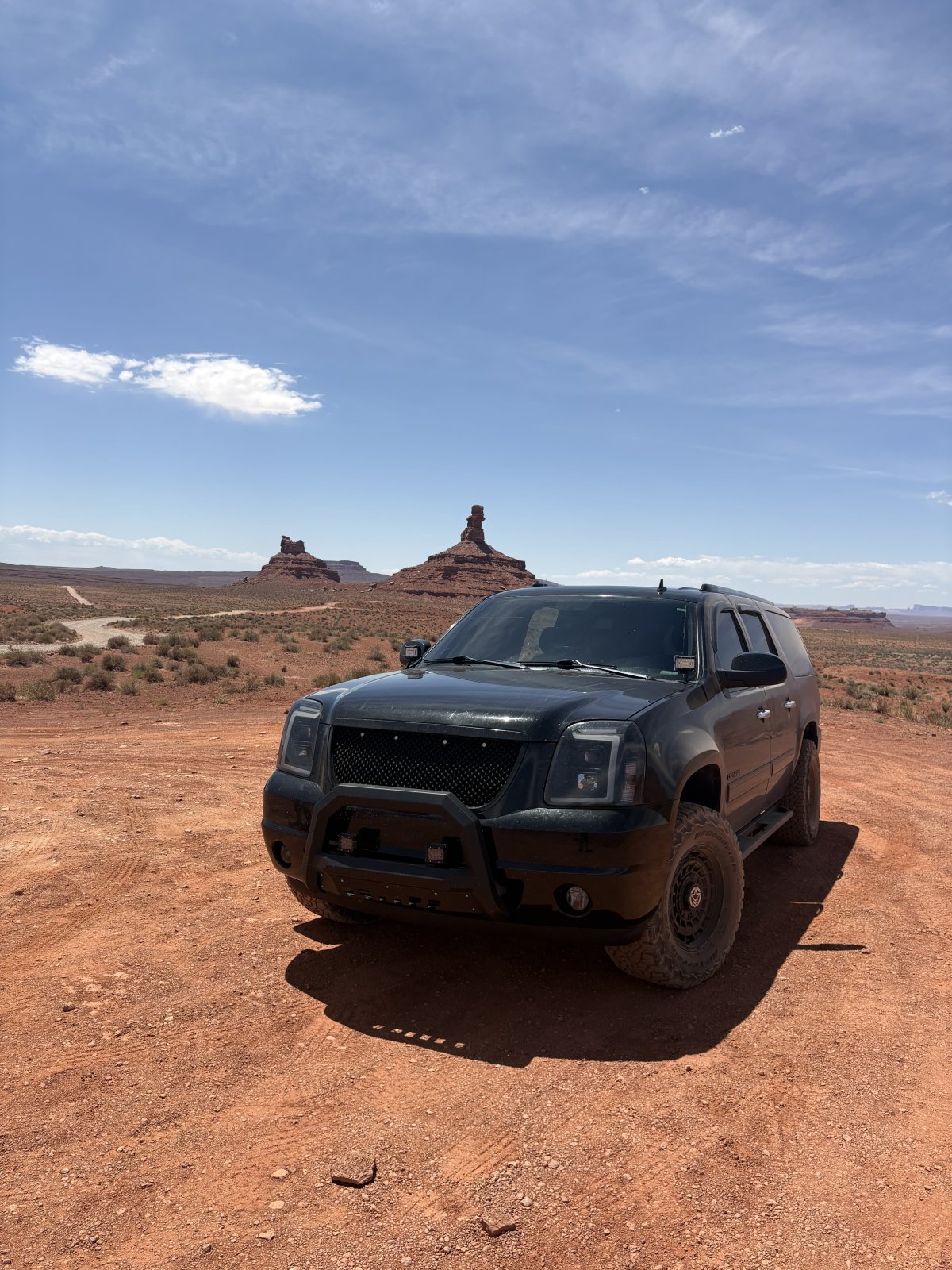

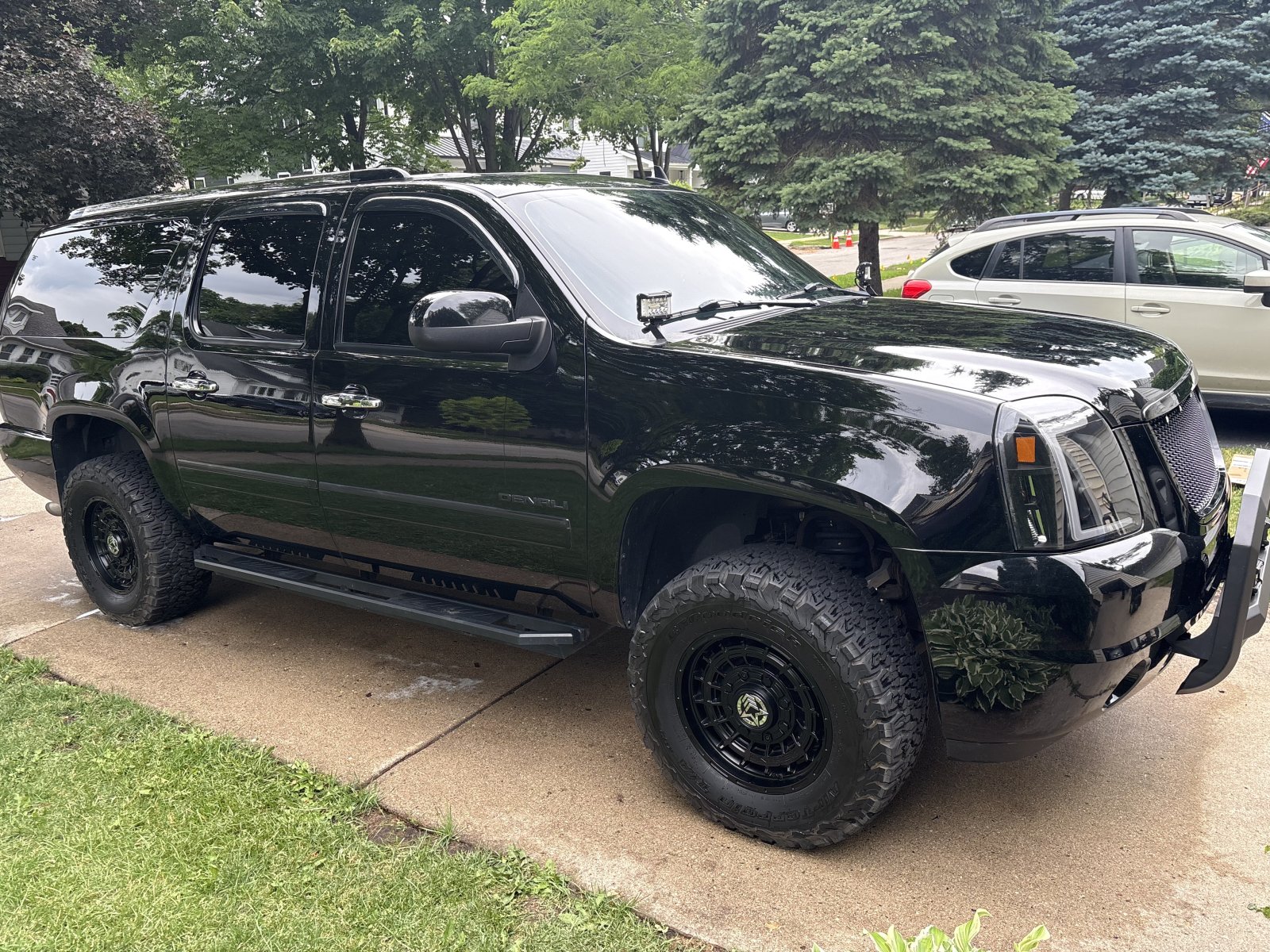

Hey all, new to the forum, not sure why I haven’t joined sooner, but I’ve got some questions regarding a lift kit. I’ve got a 2012 Yukon xl Denali that I’m looking to get rid of the air ride completely. Going with the 4” BDS kit with Fox 2.0 in the rear and going to go with bilstein 5100 up front. My questions are, what springs should I pair with the 5100 up front and what springs should I go with in the rear as the air ride springs will be too soft. 90% daily and 10% overland. Not bouldering, just light to moderate trails
