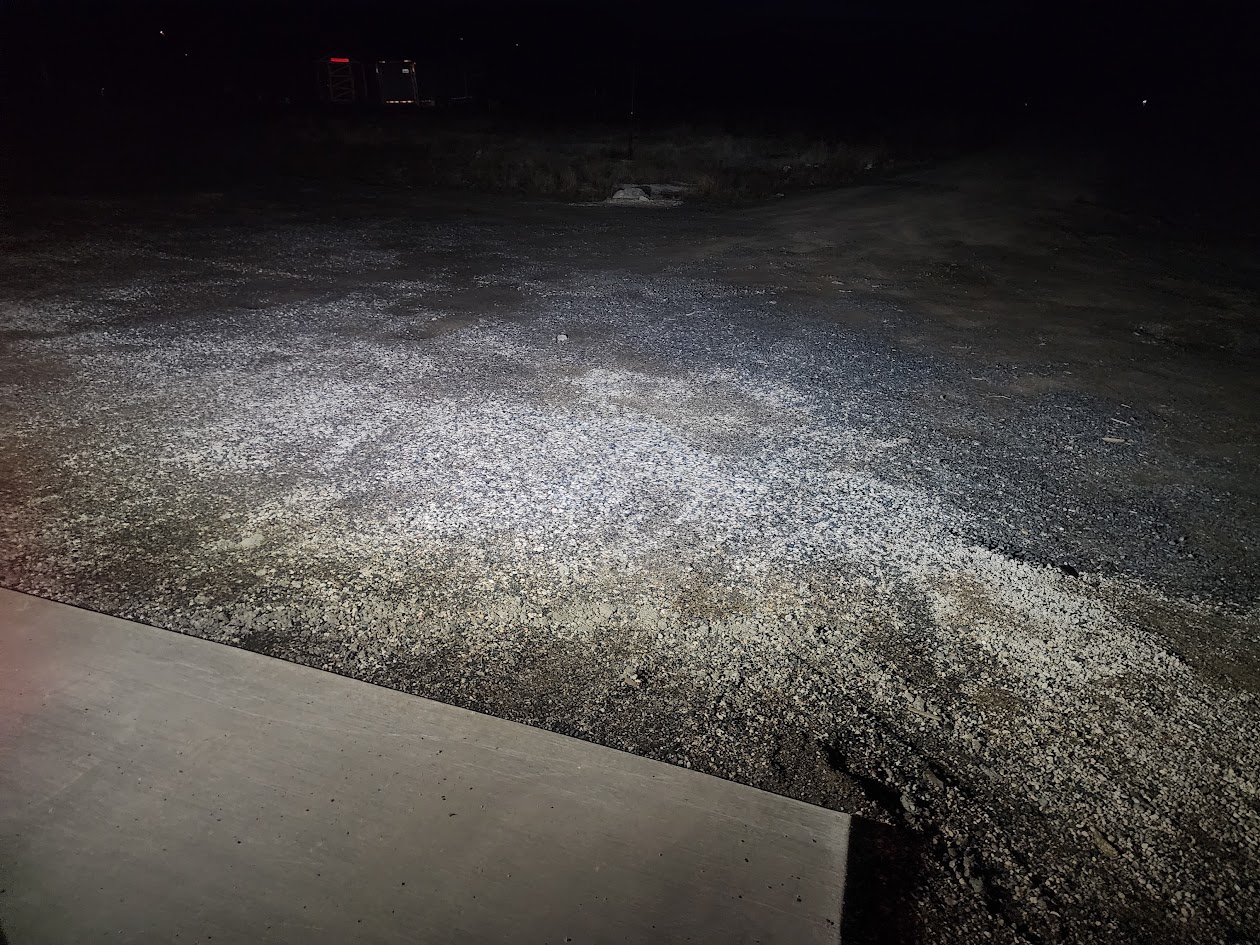

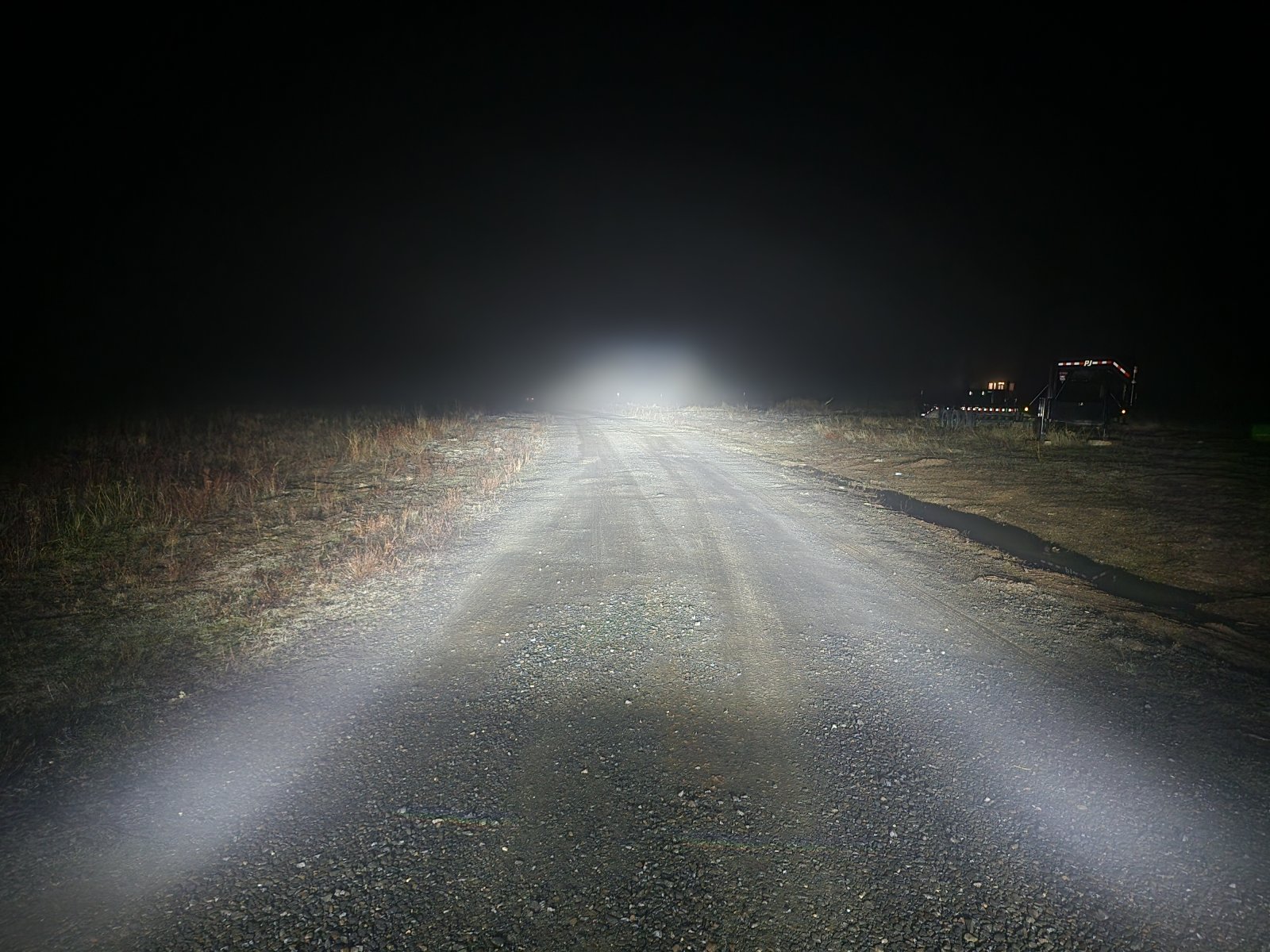

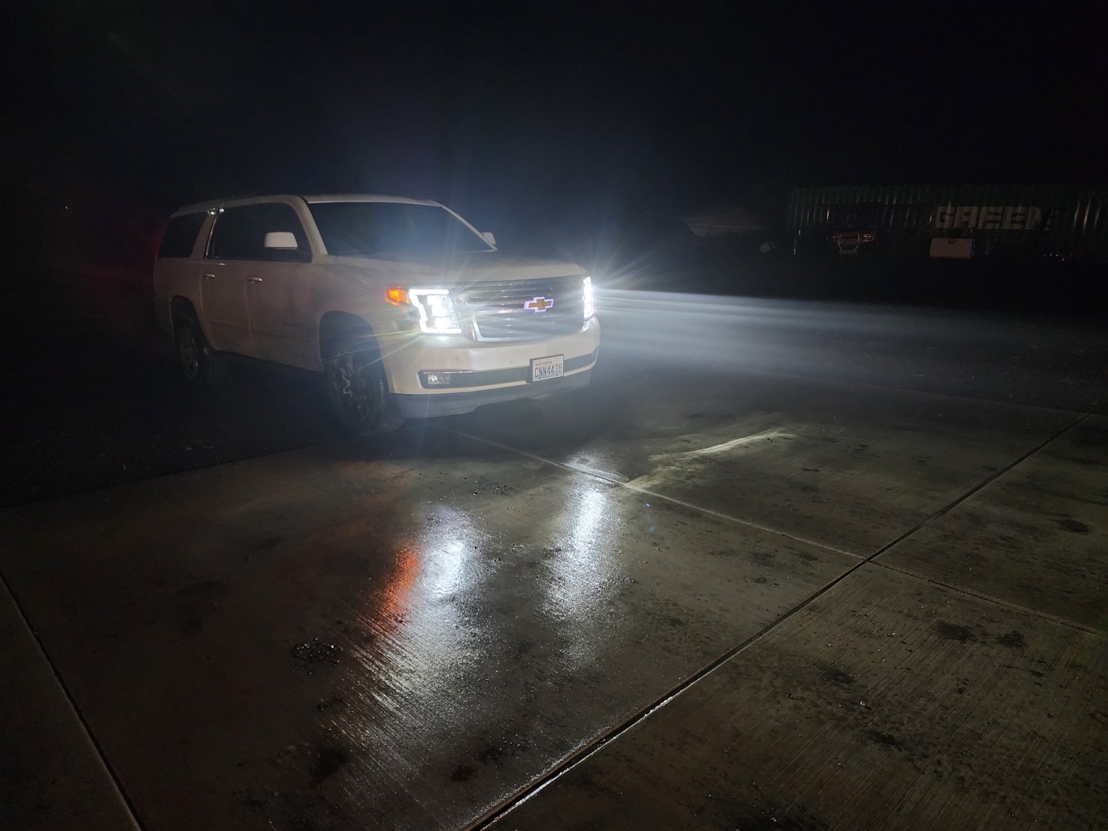

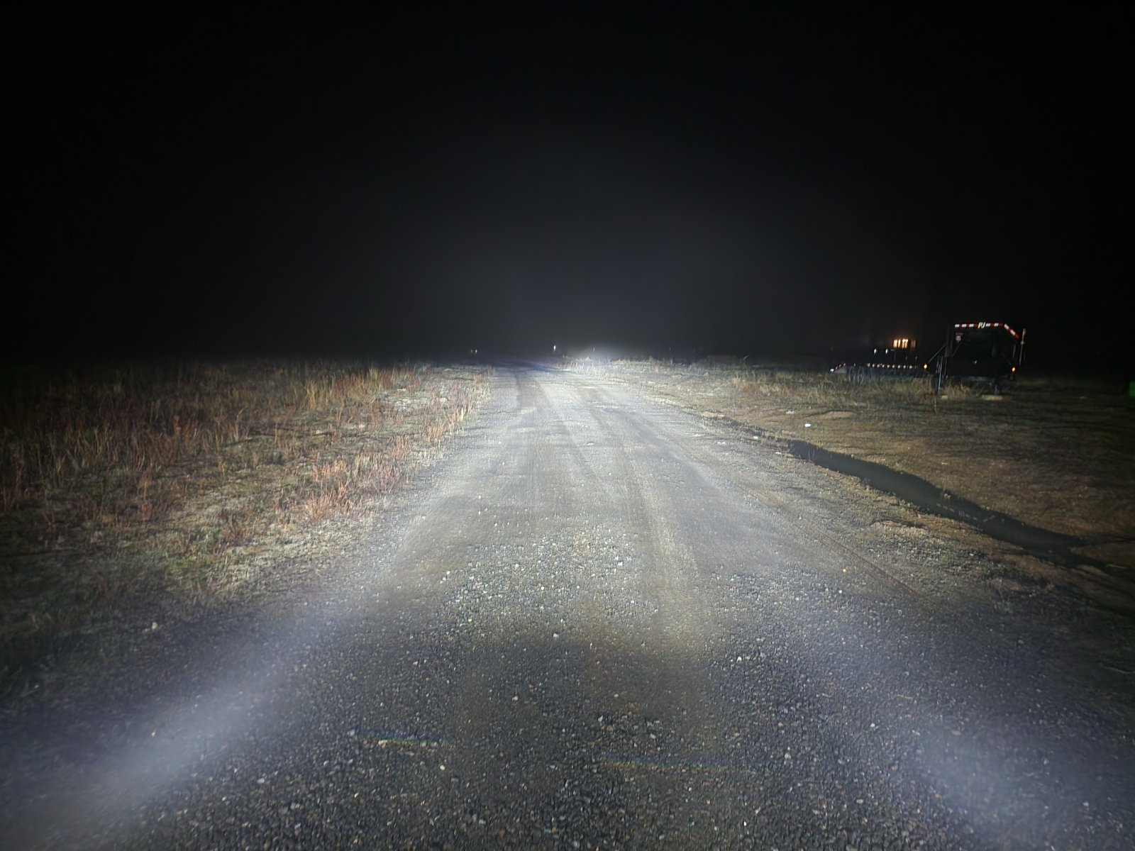

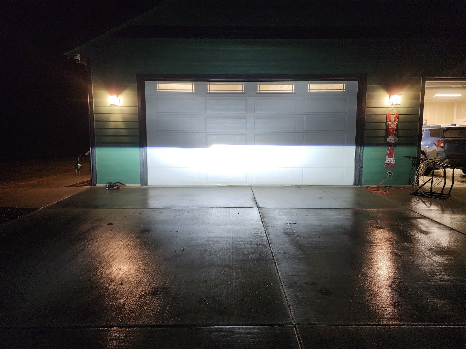

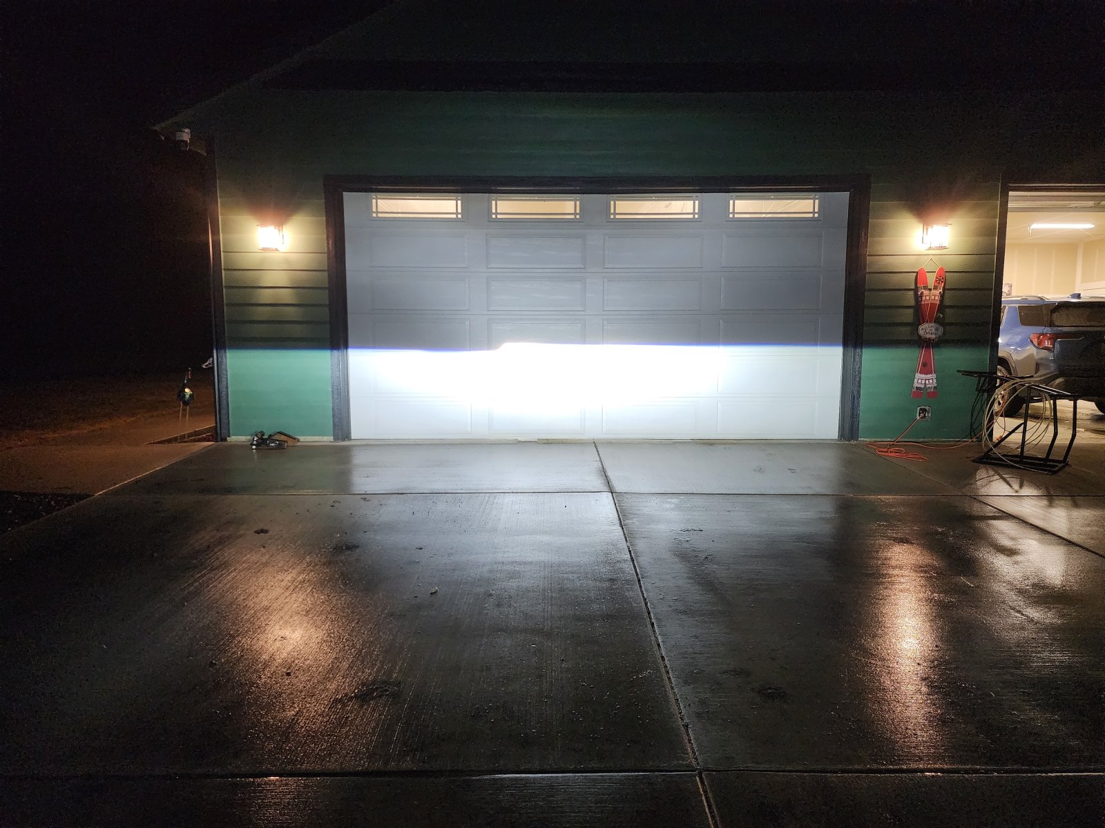

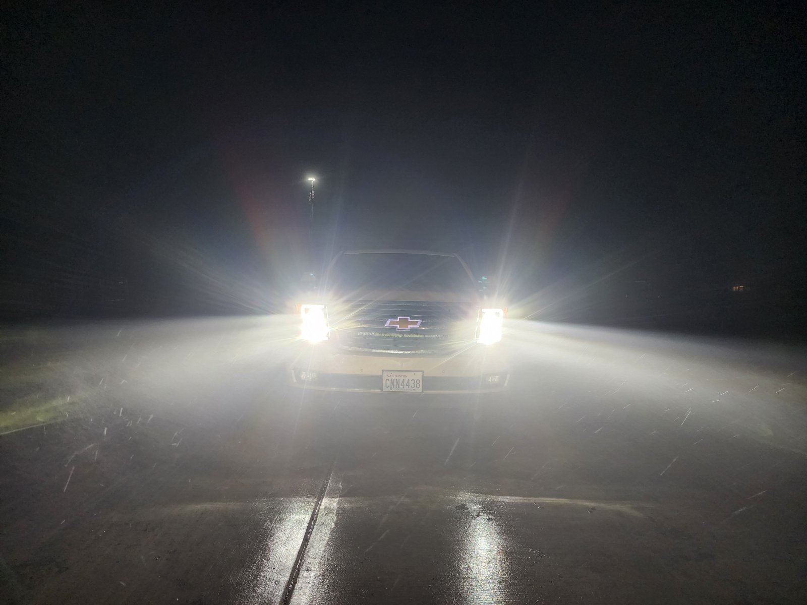

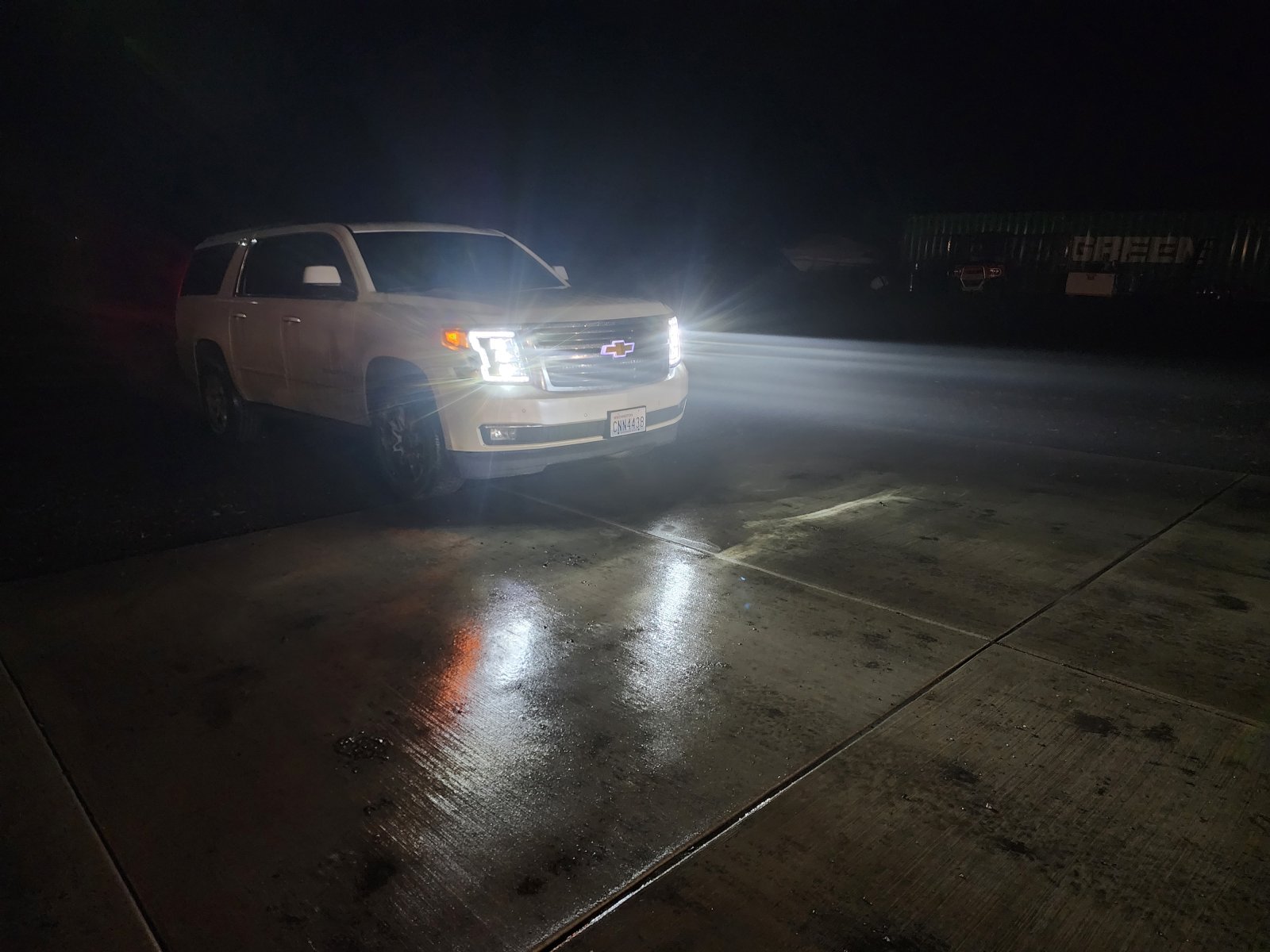

Couple more pics after adjusting the headlights
And of course low beans

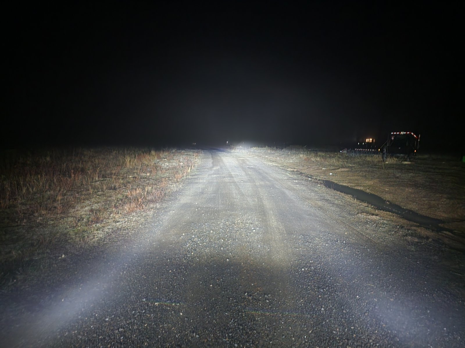

And high beams

I did not expect these to be so nice for being aftermarket. THe output is very nice and the high beam has a good hot spot. I build headlights for my cars and while I like thorwing something on it and forgetting about it, for the cost of aftermarket lights I can always over achieve output and come in way under cost but it takes time to do the work on a set of these lamps.
Yeah, i've had buolt headlights, high end OEM headlights, cheap housings and just about everything. While yes, you can build something with some D2S projectors and 55w HIDs that will outperform just about anything, there is a time consideration in my mind. For a drop in housing, i have yet to see anything that truly comes close to the build quality of Morimoto. I have a set in my truck that hasn't served me wrong over several years. I've spent lord knows how much in lighting over the years playing with different things and i honestly don't have the time to build a set anymore, or mess with the issues that can arise with CANBUS systems and HIDs. IDK how bad GM is with them, but Rams can be finicky. I honestly truly hate drop in LEDs in any housing, because they don't work right and nobody listens to you as to why something that visually looks good, actually looks horrible. bright does not equate to quality lighting. Beam patterns and refraction designs are a thing. There are times engineers actually earn their keep, and lighting is one of those times. But regardless, i do very much enjoy how much effort Morimoto puts into making a truly drop in housing with high quality LED projectors. Once you account for the time and effort that goes into building a set of housings, it's hard to not just buy the XB housings and call it a day in my book
