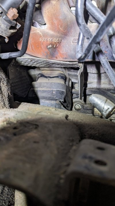

Just finished reading this thread and although I don't have much clunk on accelerating I do notice a slight groaning sound before the engine warms up when going over bumps. Thought it might be the mounts. Do yall think this is normal movement or is this mount on the way out?
I do believe that is to much movement and the mount is likely failed. Not sure if it would cause a groaning sound on a cold motor though.

you know, it's hard to say for me. that's definitely more movement than I'd like to see, but also it doesn't have the abrupt lift and hit the stop that mine had. yours looks like it has some smoothness to it. but you'd need to find someone with a oem non hummer mount to compare.
groaning over speed bumps when it's cold seems to be sway bar end links and bushings for most people. mine does it, but they look fine and it's not cold here long enough for me to care much yet.

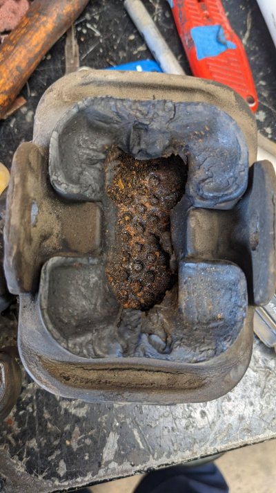

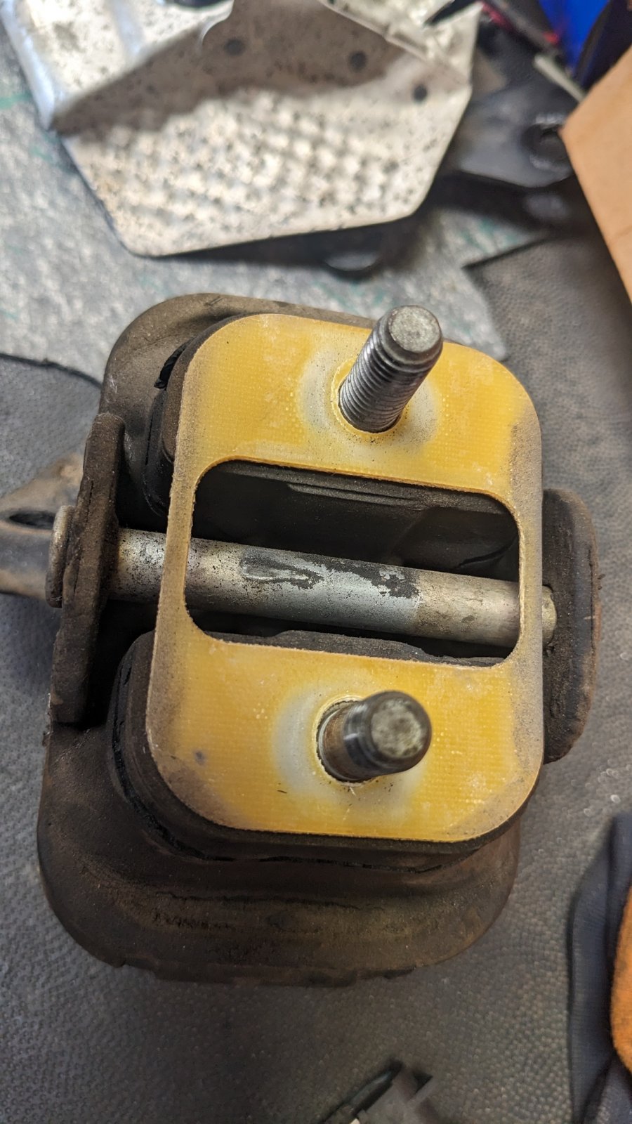

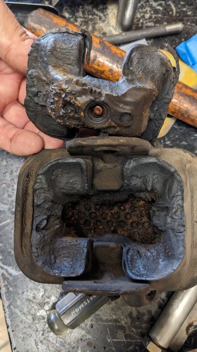

so I got bored and took my old mount apart, I'm guessing this isn't a oem mount. so it was probably done before. I definitely don't see any way these have fluid in them?
