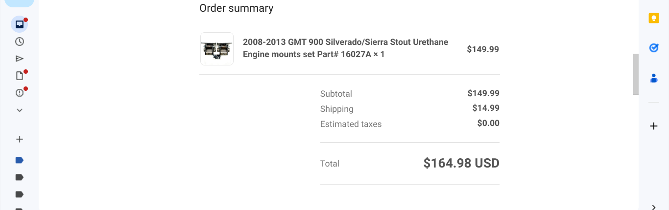

Looked and looked and looked. Only real options I saw where fab'd by desert racing shops and were $360+ ......about the same as a few of the GM parts and/or Hummer H3 mounts....Worse I was having trouble confirming that the lesser priced factory options weren't just another hydraulic crap turd that has failed too many in too short a time...
Then I stumbled across MetalTek. Small company out of Southern Michigan. Dude even gave out his personal number on his website, AND answered on the third ring.....and 9:35pm!! Very nice guy Turns out it's just he and his son that do all design and fab work. Said his son has actually become the superior welder, so he handles all the beads.

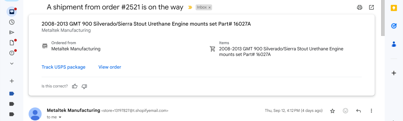

My order processed late on the 11th.
I asked what the expected turn around would be to fab these....Jamie says...."ehhh prob be a week". I say "sweet deal, thanks and let me know when you get them moving my way."
Fast forward to last night when we get home from Pittsburgh and there they are leaning on my garage door. He cut the pieces and had welded it all together in one day! No lie... The shipment left Mich on the 12th and arrived here on the 14th at 142pm..

Nice! Let us know how they turn out! Looks to be a good $200 cheaper than similar options! But needs paint.
