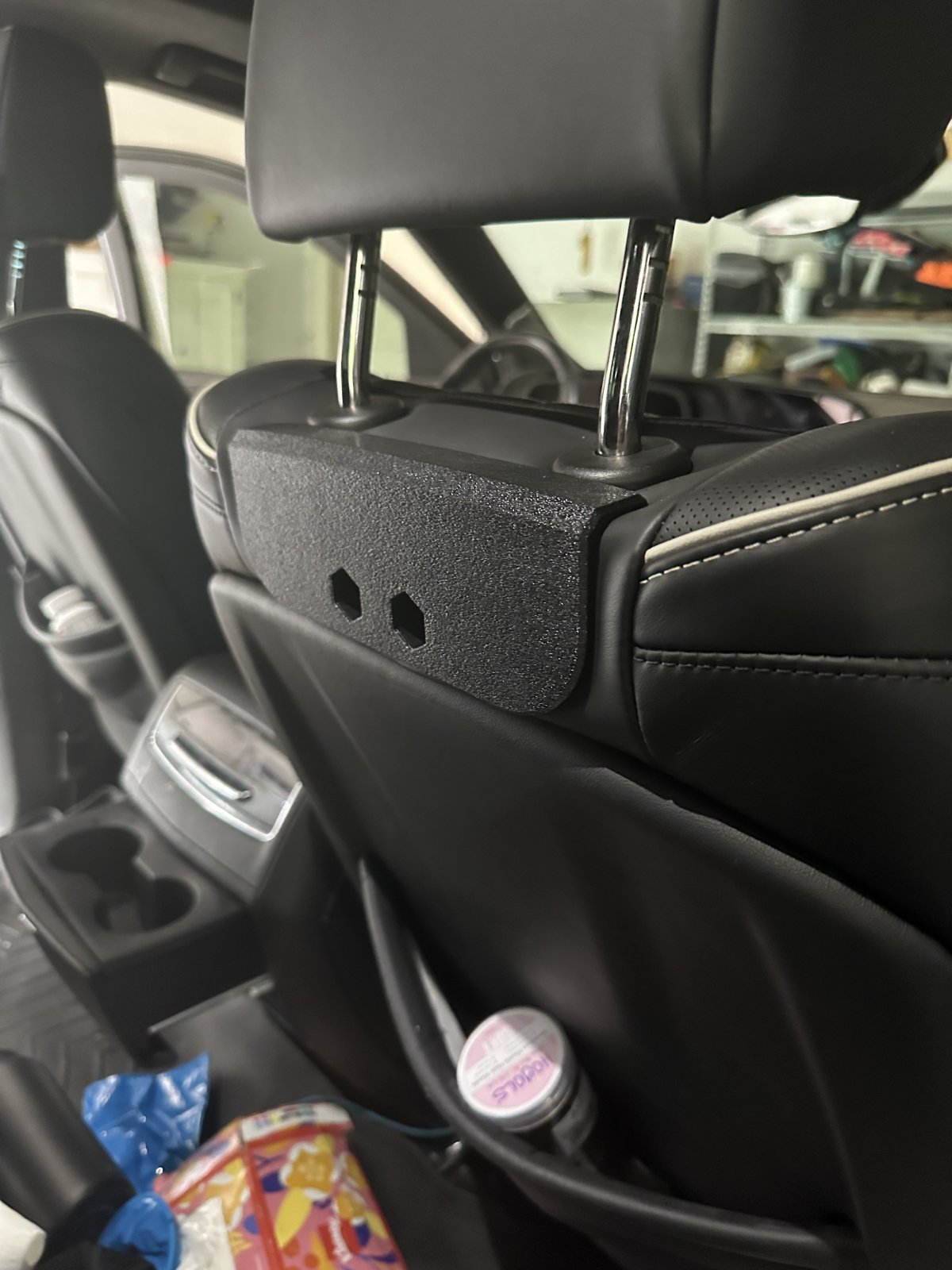

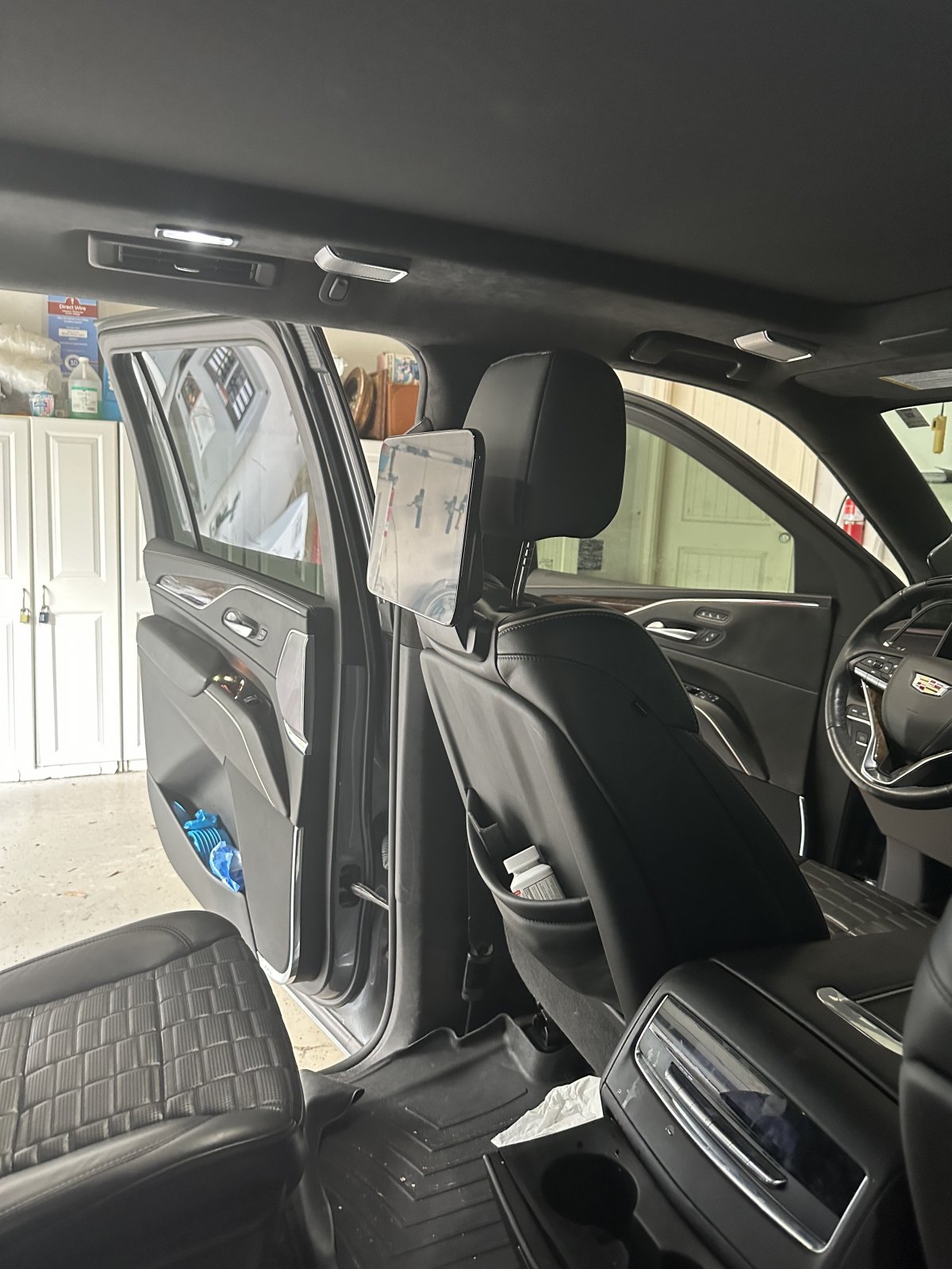

Just imo, if you hate it...see the link in my signature for the Nintendo Switch mount I used. I would suggest one similar for a tablet vs replacing the OEM.

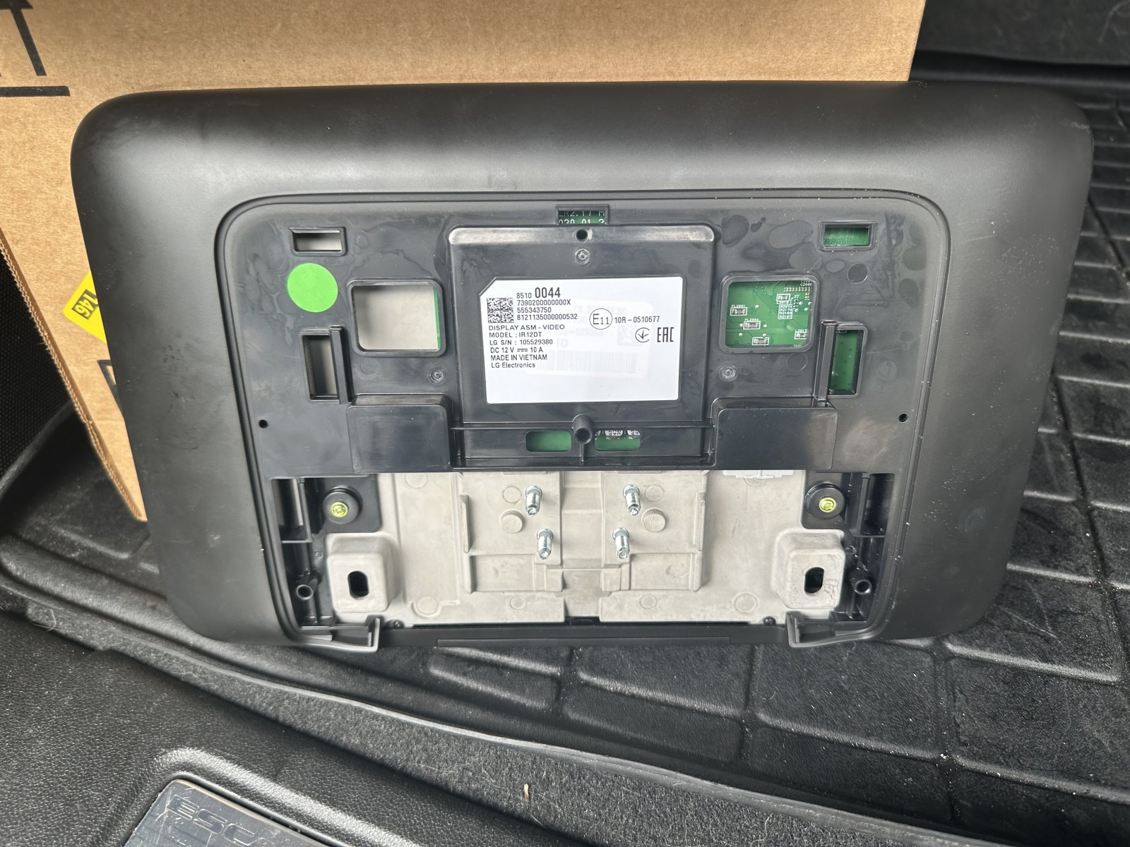

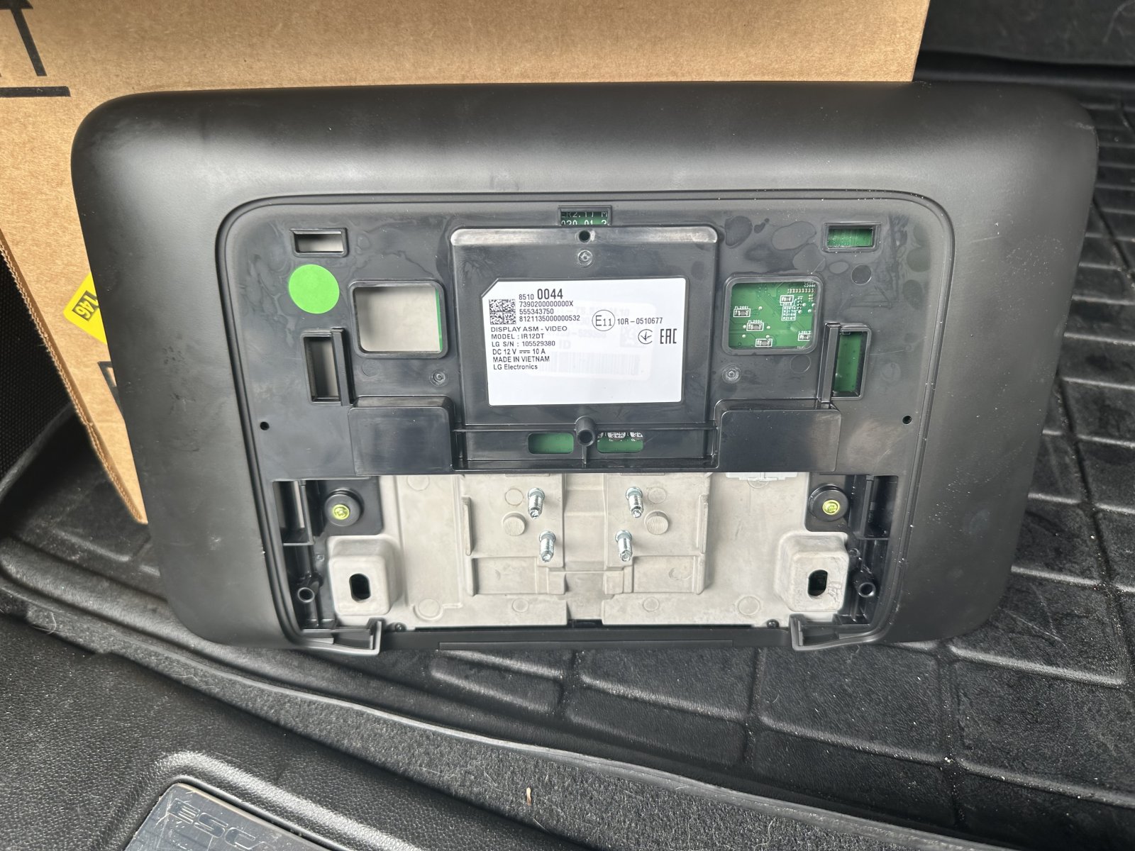

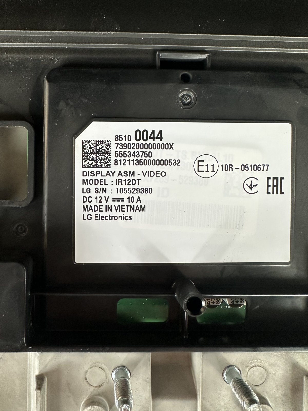

I had my mechanic look back through his notes, one of our Sales guys broke one. He said the part number is 85100044 for the Yukon, probably the same for Chevy's.
mtrentw
Mar 11, 2024
If anyone still needs one, I have 85100044 Driver Side screen for 2021-2023 Tahoe Yukon Escalade.
Note driver passenger differ. They’re master/slave. Passenger has 2 wire connectors. Passenger is 85100042.
I’ll give it cheap.
As a side note the blank plates look ok too if you don’t want screens.
