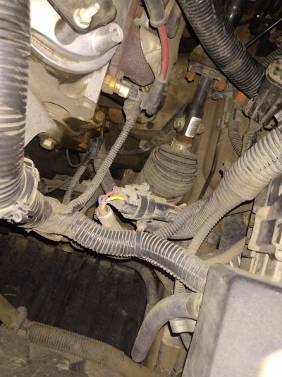

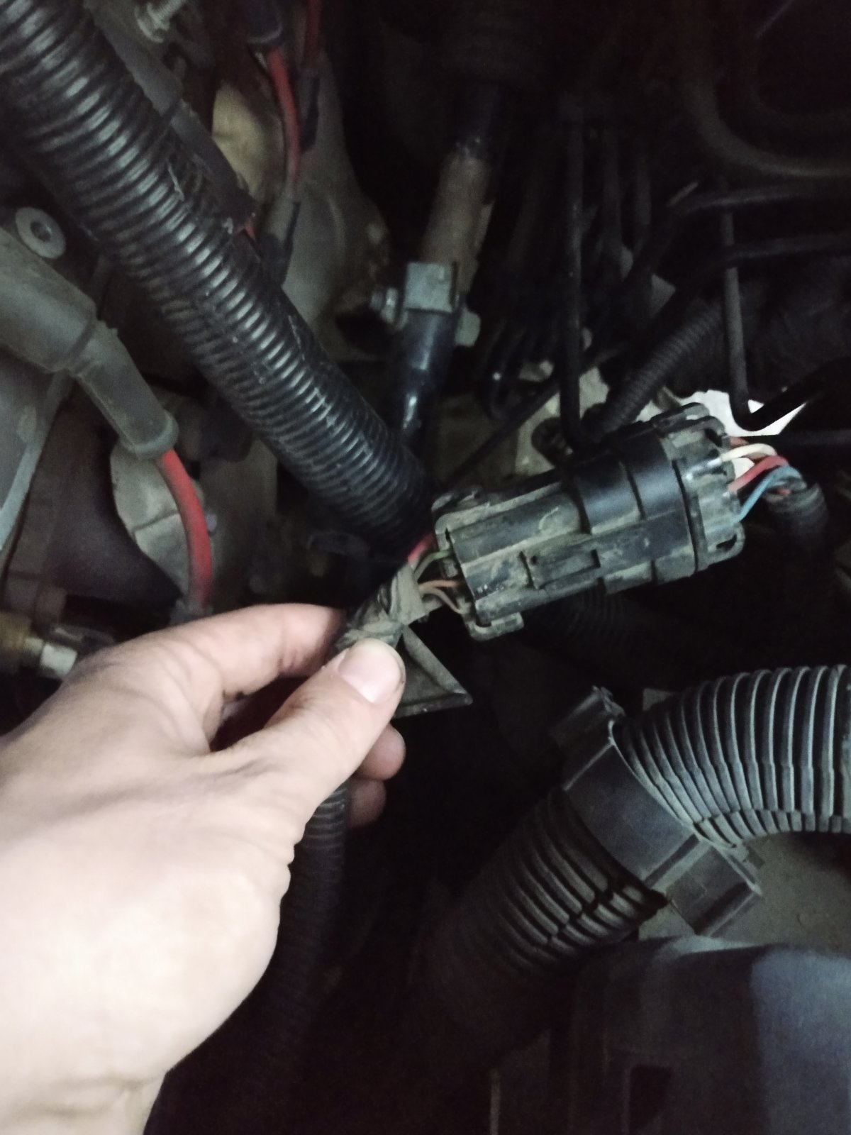

My wife has the car right now so I couldn't even check. As far as sensors go I took these pictures the other day after finding the TSB on this. Not sure if these help but it's all I have at the momentIMG_20220117_165345578.jpg?hash=8210616605f4607582e53f9475180a4b.jpg
B
BG1988
Nov 14, 2018
2,755
1,211

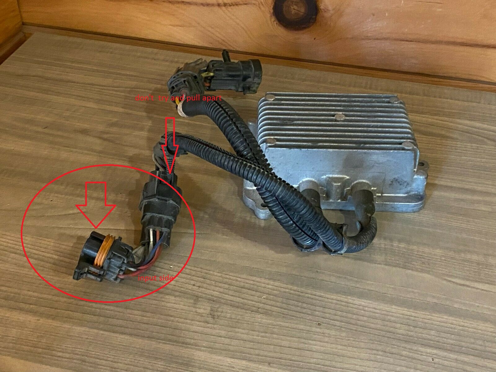

the top photo might be the input side and the bottom being the output side...
also i would clean up the ground to the engine block, oil is an electrical insulator(some can conduct electricity but still is an insulator aka resistance)
Make sure the engine is cold when using flammable sprays also make sure to allow flammable fumes to disperse before starting the engine...
the other one that is don't try and pull apart might not unplug ( at lest not without a special tool?)
looks like it's leaking oil from that bolt on the engine block
