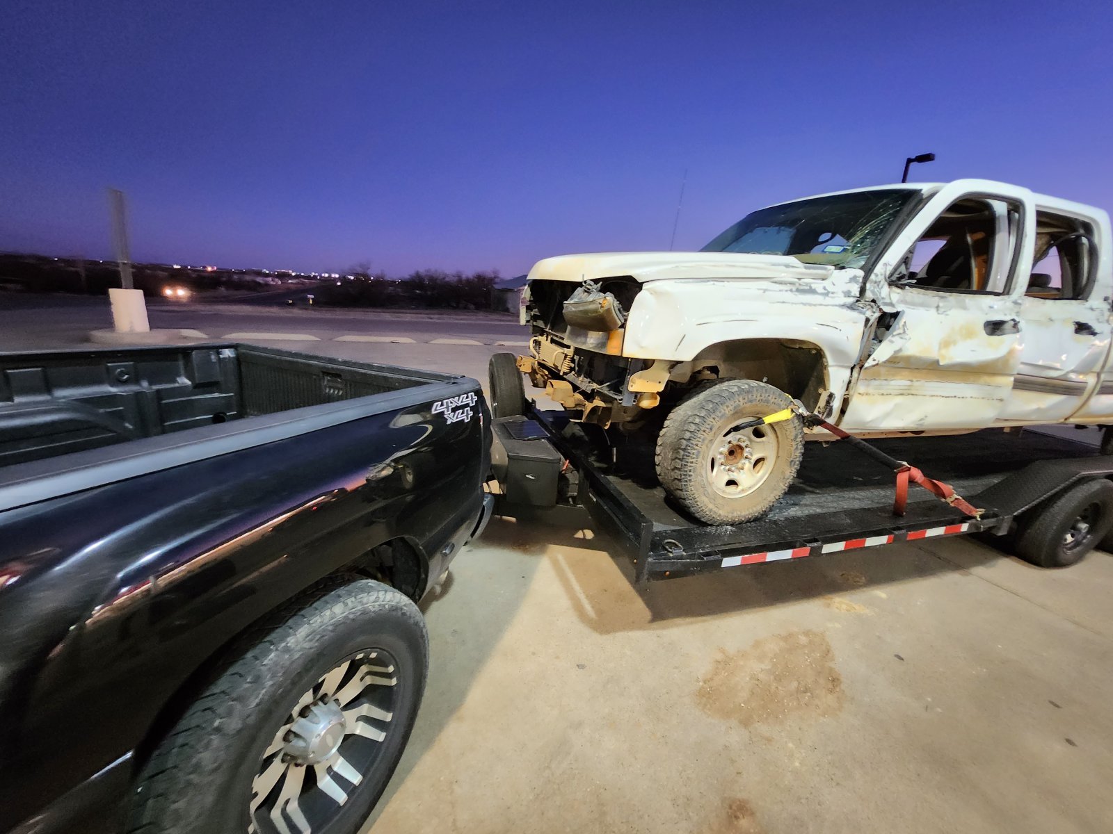

It's a 2006 2500 HD (LBZ & 6 Spd Allison).

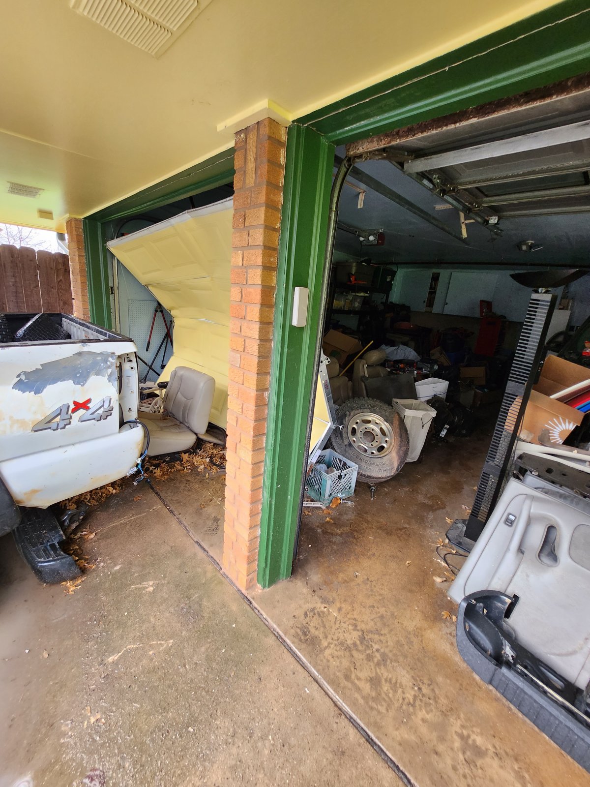

$3k, plus trailer rental, gas, a garage door, a mason, and a painter...
S33k3r
S33k3r
Aug 14, 2017
2,893
4,189
Dallas, Texas

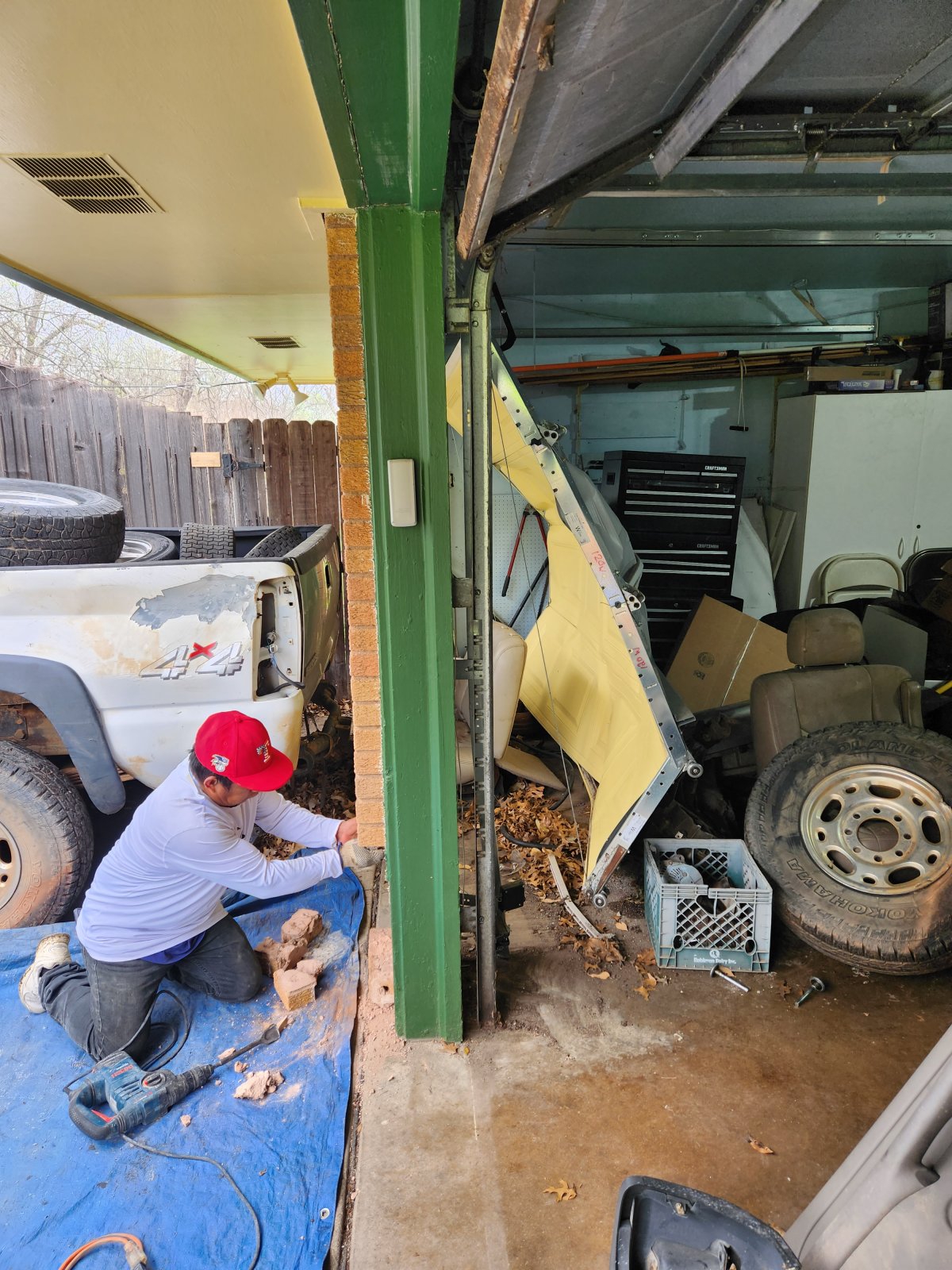

Masonry repair = $400. He was supposed to just do a patch job ($400). He did not communicate this to his employee who actually did the work. They tore the bricks all the way out, relevelled the post behind them, and then remortared the bricks! Oh! And there were 2 bricks at the front of my house I had partially damaged with a trailer a year ago; cosmetic only damage that time. But he repaired those as well.
We also found out he did tile work; we had previously moved some cabinets in our kitchen, and needed a dozen tiles to fill the whole. We could not find matching tile ANYWHERE. He quoted us $450 + we would pay for hardybacker, cement, and grout. Cam out to $475, but I paid him $480. HE found matching tile!!! And enough sop we have 1/2 dozen spares now, too!
The garage door repair cost $1100, approximately.
I'm still trying to get the contact information from my wife for the painter, so the door will match the other side again.
I also have to find a replacement hose roller, as the one we had was between the truck and the garage door...
***** No GMT800 vehicles were damaged in this incident -- by the grace of God. Nor was the idiot who caused the problem in the first place, unless you include pride. That was very damaged) *****

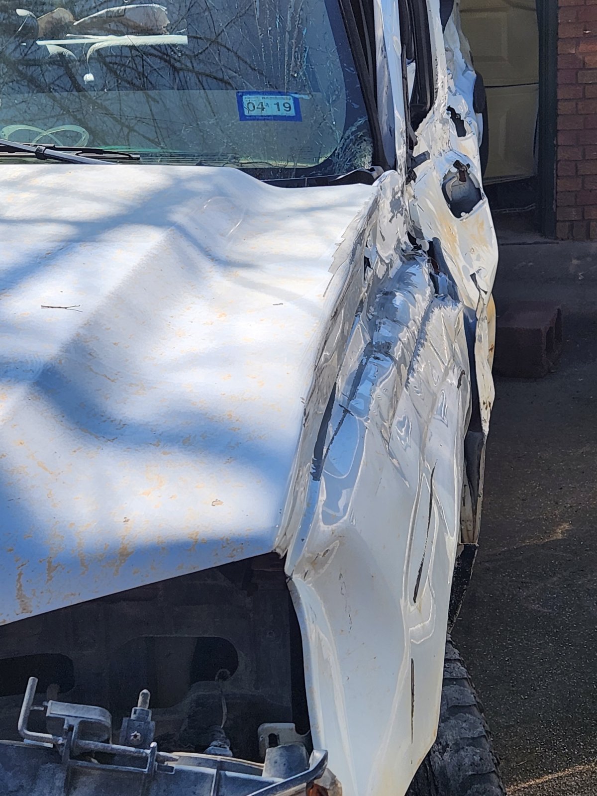

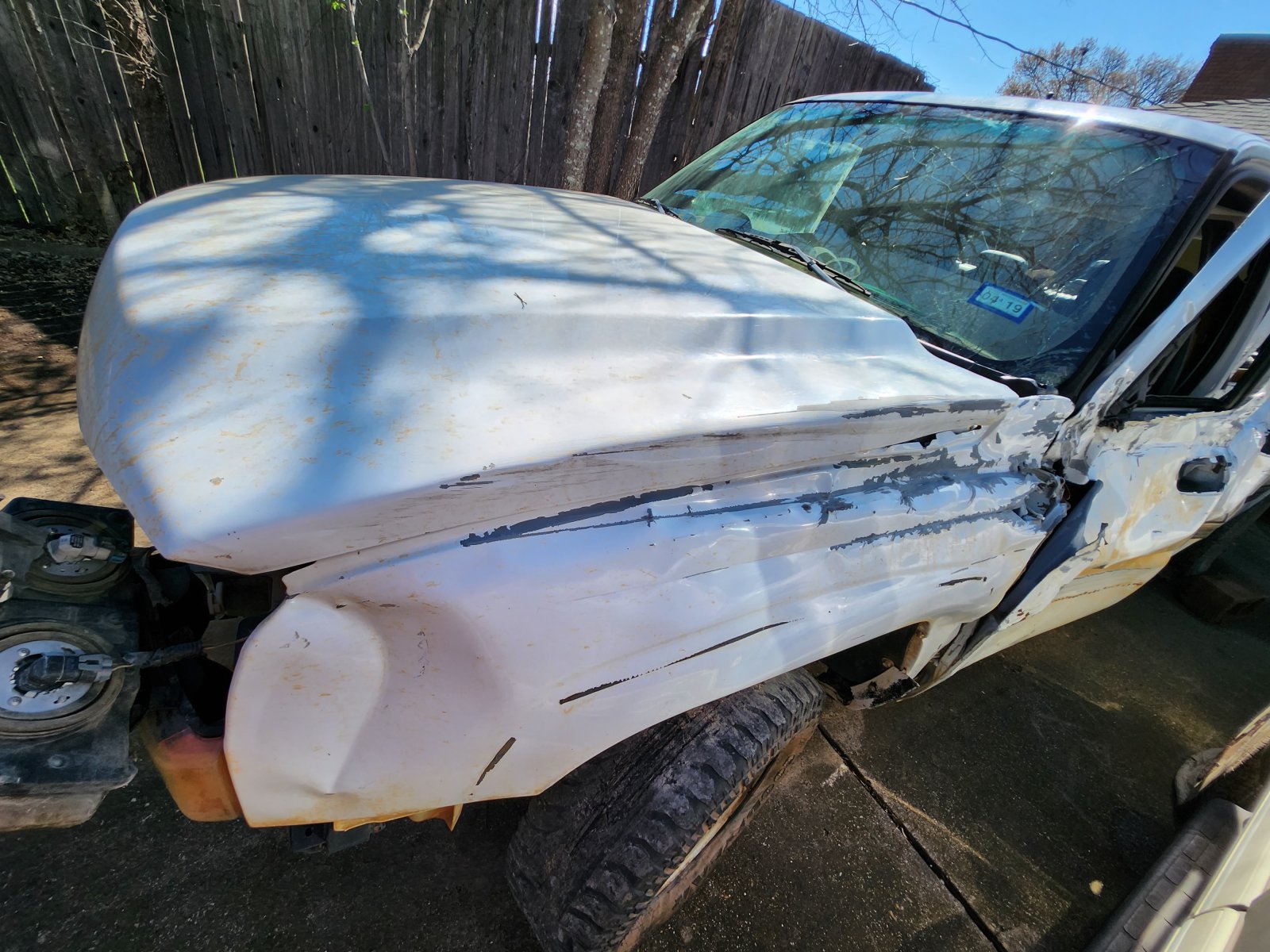

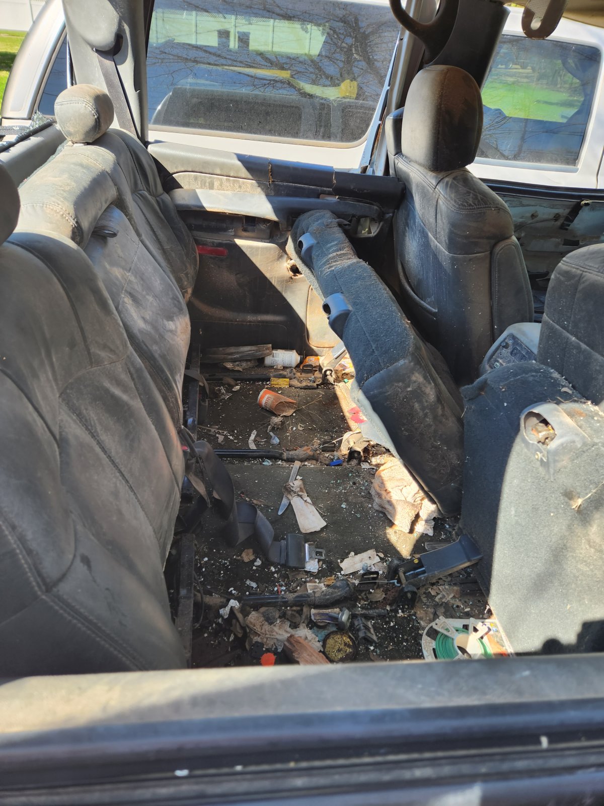

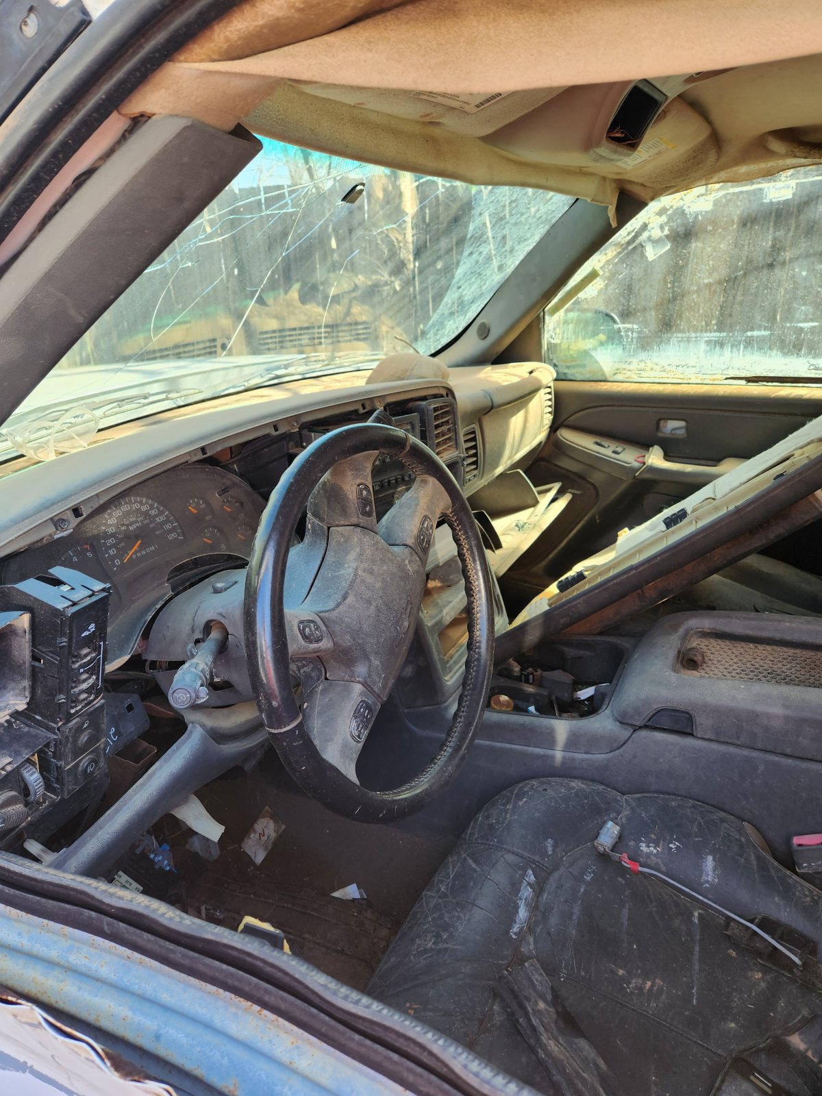

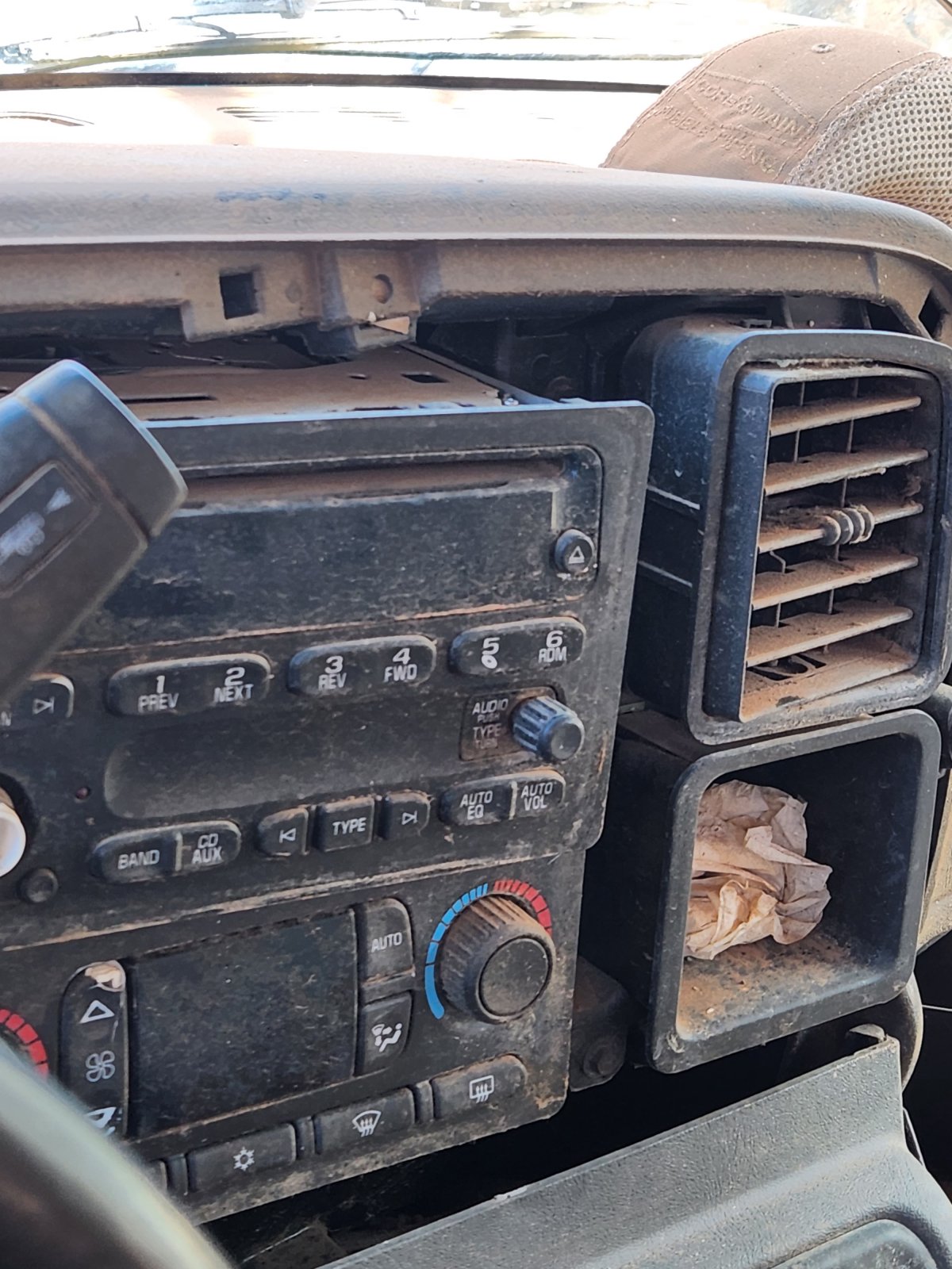

Here are some more pictures of the donor truck. Turns out it was a Farnken truck before I ever bought it. It was the second owner -- the son of the first owner that totalled it. But it had previously been rolled. So the cab is from a 2002 Sierra.... The fatal damage (to the truck; no blood inside the cab!) came from sideswiping a FedEx truck.

So, in buying the donor truck, I did make one mistake which may or may not be a PITA for me: It is a long bed truck, and I have a short bed. That means I can't use the frame. So I am looking for a 2500 HD, Crew Cab, short bed (CCSB) right now, or the frame there from. I'm looking for a 2010. The frames for these were the same through the 2010 model year, but with some stiffening improvements. 2011 is a different frame. They also switched to 8x 180 in 2011. Until then, it was 8x 165.1. Please wish me luck. The difference between the frame I have and the one I want is mine is rated for #8600 GVWR and the 2500HD frame is rated for #9200 GVWR.
Doesn't appear to be 1 straight body panel on that truck!

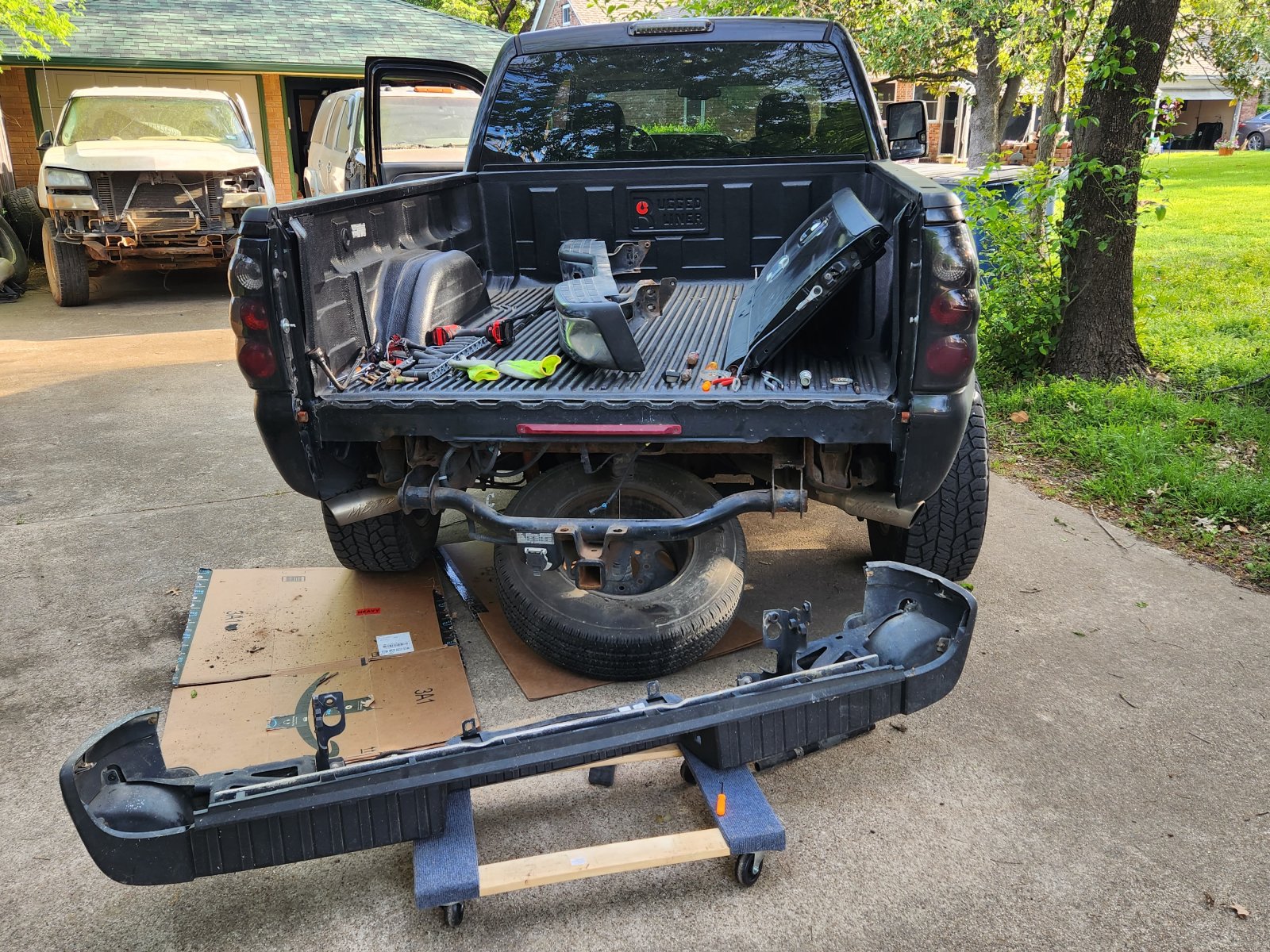

Tried to install a 2014+, step bumper on this weekend; got the old one off, can't get the new one on. Looks like I am going to have to swap the brackets. This is likely due to me having a 2500 (thicker frame at the rear) and the 2014+ bumper likely came from a 1500.
On the plus side, the spare tire looks good, and the spare tire holder isn't frozen in place. In fact, it looks to only be a few years old!
