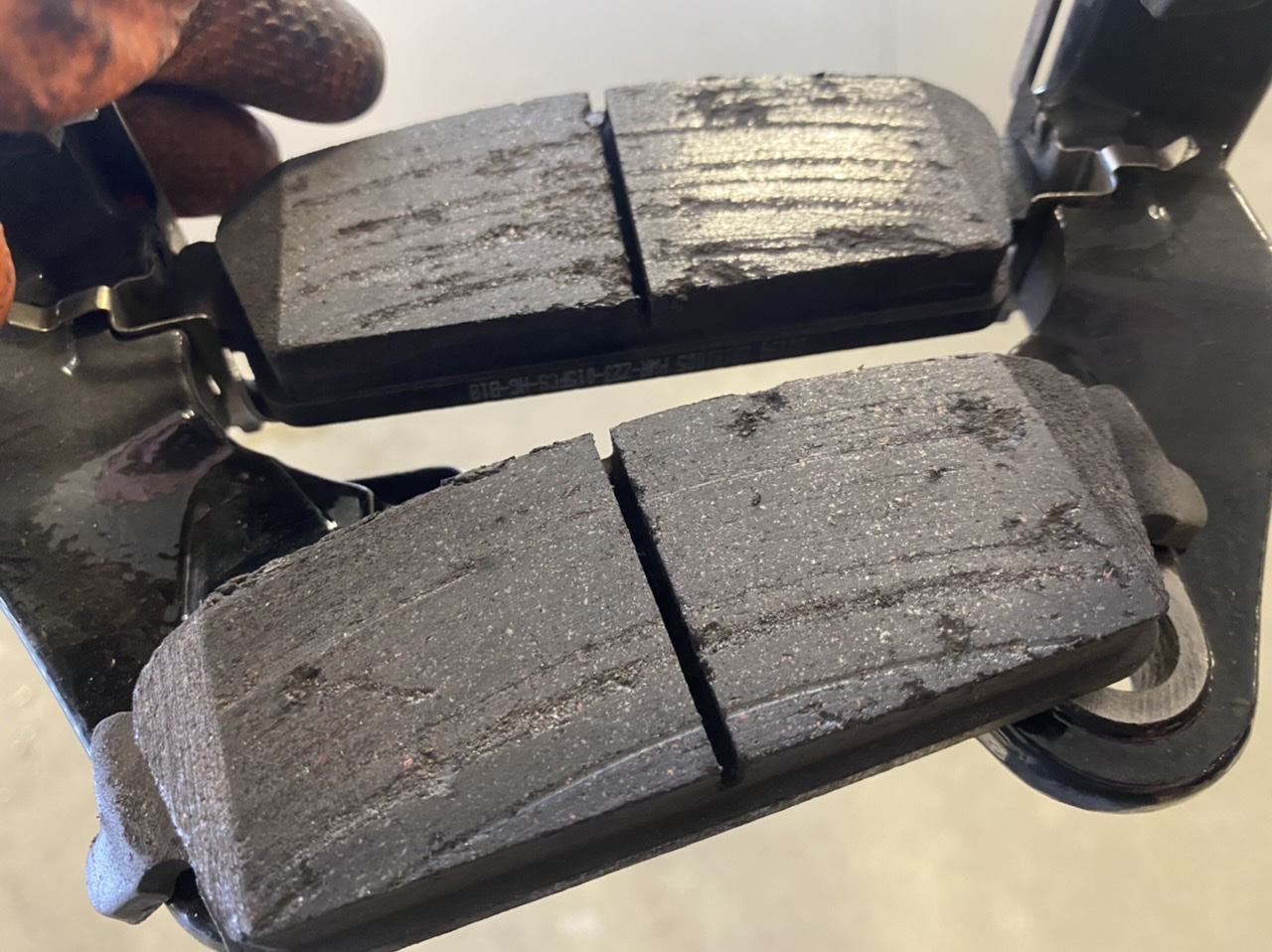

I tried Powerstop rear brake pads since people talk them up because the OEM pads are discontinued. I bought new rotors at the same time and noticed the rotors looked odd after 500 and found this when I pulled it apart. So in the trash they went, nice waste of money. I replaced them with Akebono and they’re fine so far.

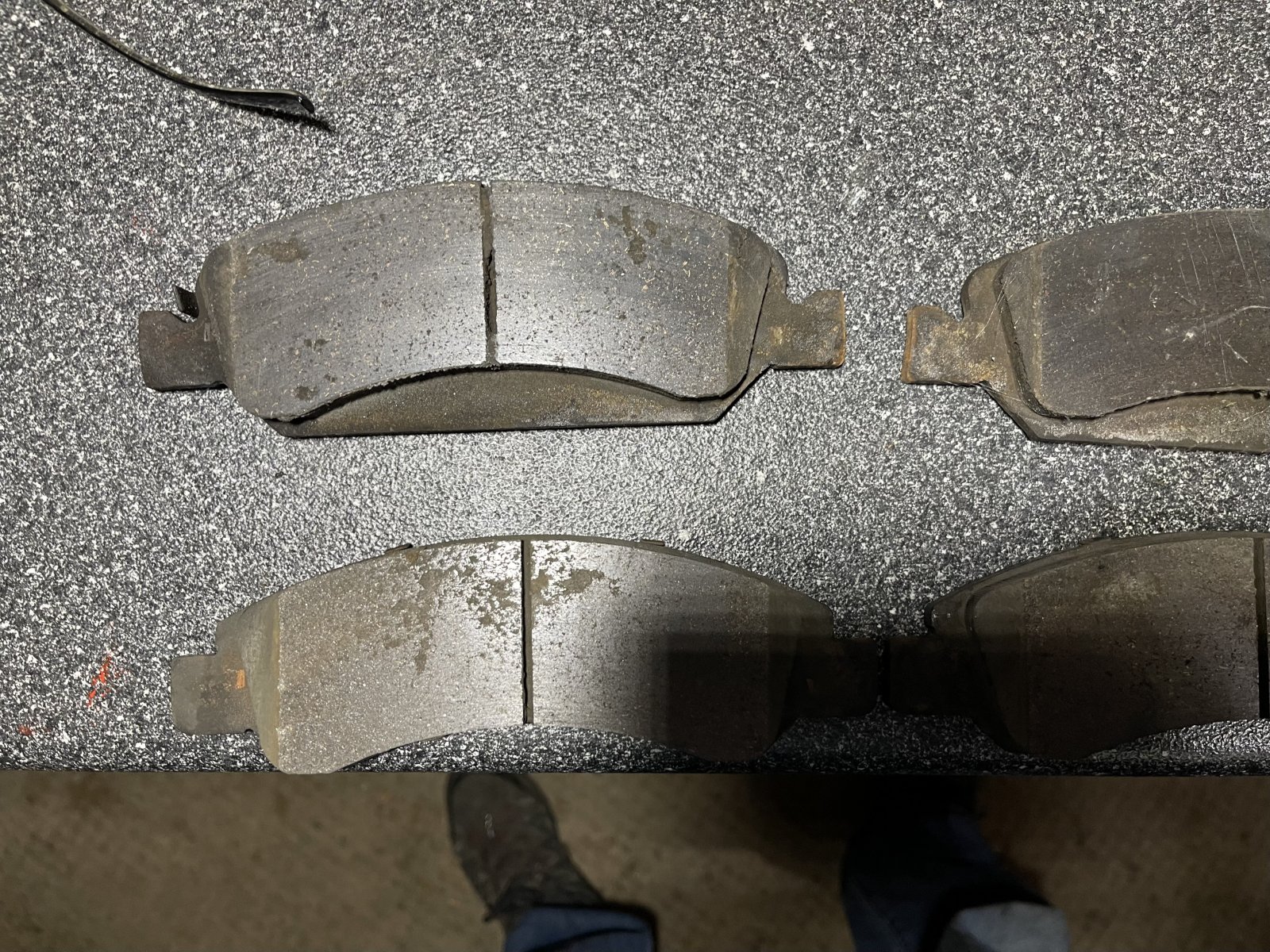

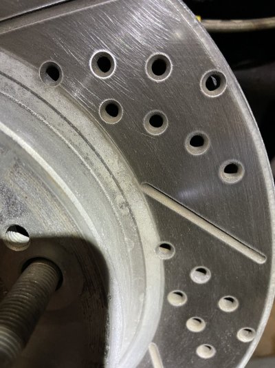

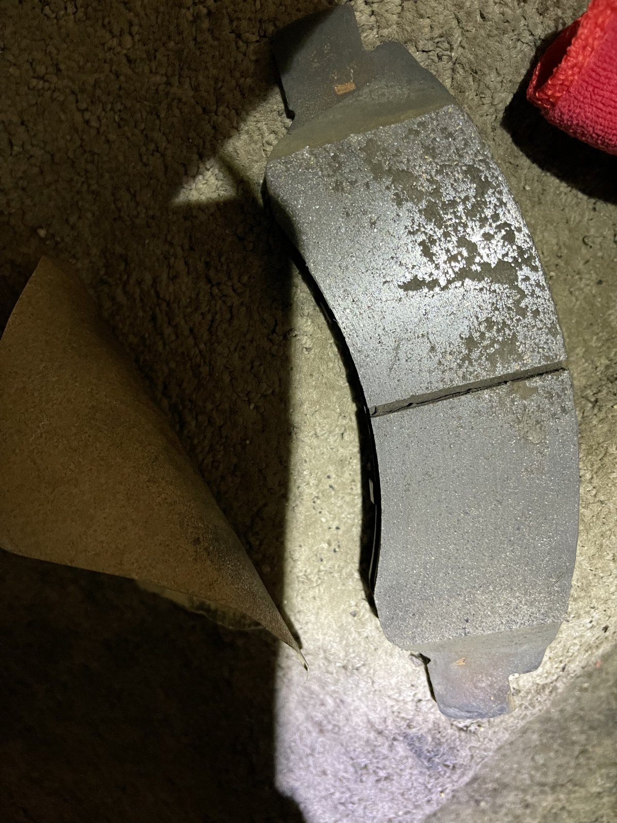

So took off the calipers to replace the pads today.I have been having a brake pad chatter at almost the very end of a hard stop-more recognizable when towing.To my suprise the baer pads that i have on it with maybe 10,000 miles are total garbage with chunks missing out of them.I got the nnbs 08 baer rotos and pads awhile back seemed great untill last 2 weeks when im towing the boat to go fishing,end of the stop brakes chatter.So scuffed up the rotors with 130 grit lubed slides installed the hawk pads burnished the pads and all great again.I did have the stock pads on here when i did the nnbs upgrade i hated them wouldnt stop well enough for me.i also put power stop pads on hated them also.Loved the baer pads but only lasting 10,000 miles with chunks missing no thanks-so we will see how the hawk pads do.About the ebrake i took that off and thru it in the garbage and refuse to put them on.It almost got me stranded far from home towing my boat when the retainer broke and the pads were grinding and clunking around in the rotor hat barely made it home at 5 mph no thanks-to each his own on that.
