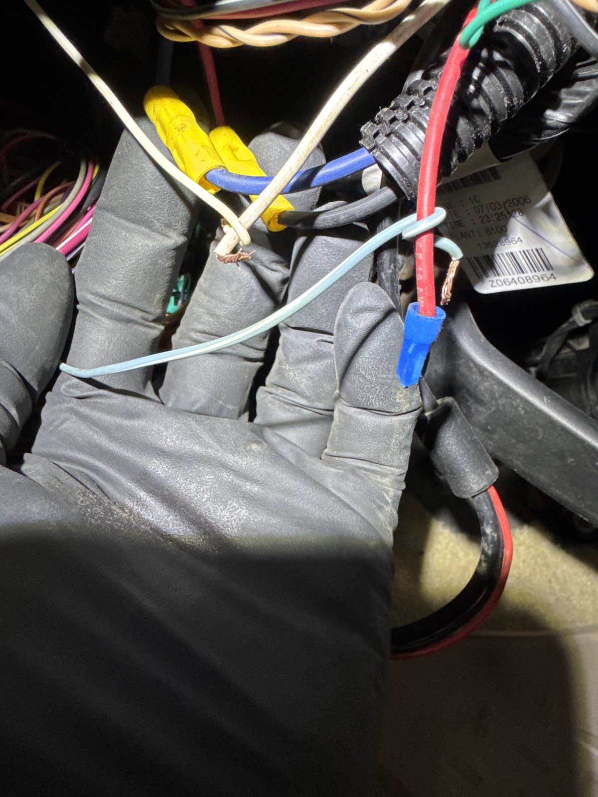

Hello everyone from SD, been using this site for a few years for advice on my 2007 Yukon XL Denali. I’ve had this vehicle for several years and I’ve decided I wanted a break controller. I went with the prodigy P3 part number 90195 from Etrailer. I have a red with black strip, blue, white and light blue with white stripe.
Red w/black stripe= black on controller
Blue = blue on controller
White=white on controller
Blue /white strip= red on controller
The red is from the positive post under hood. I have constant 12v on that.
Blue goes to back and into 7-way. I checked continuity to that and it checked out.
The white is factory spliced into a black in the group of wires under dash and I have continuity to known ground but only when battery is unhooked. Will not ring out when battery is hooked up.
Blue w/white strip has continuity to 4 wire brake switch blue/white harness when unplugged from switch. This is my issue, I have a constant 3.9 volts on this blue w/ white strip wire even when unplugged from brake switch.

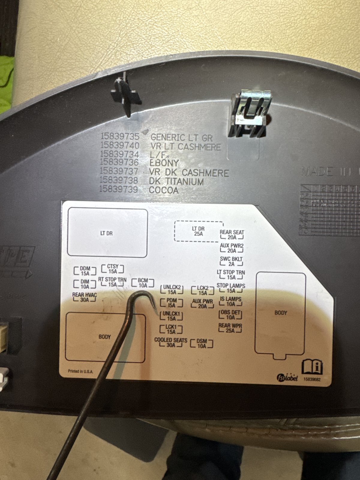

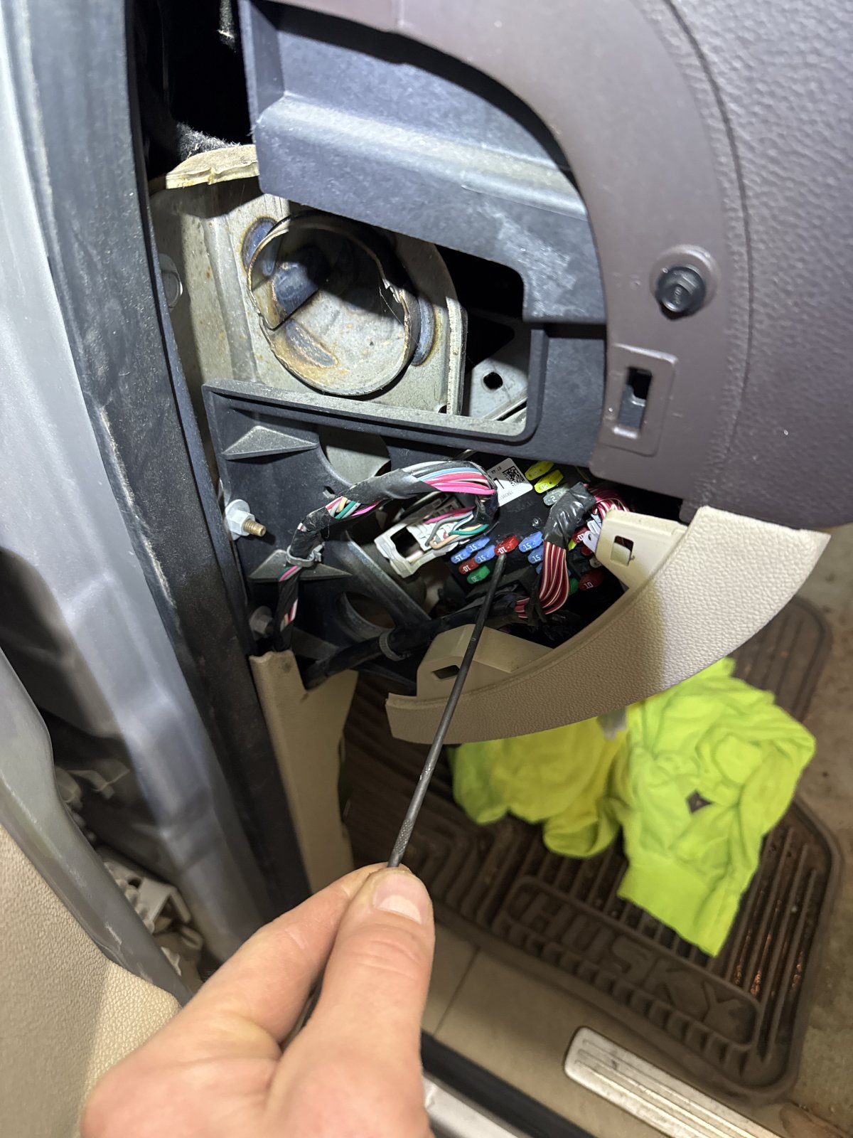

Update, when I pull the fuse for the BCM behind the panel on drivers side. The 3.9 volts on the blue w/ white stripe goes away… problem with the Body control module possibly?

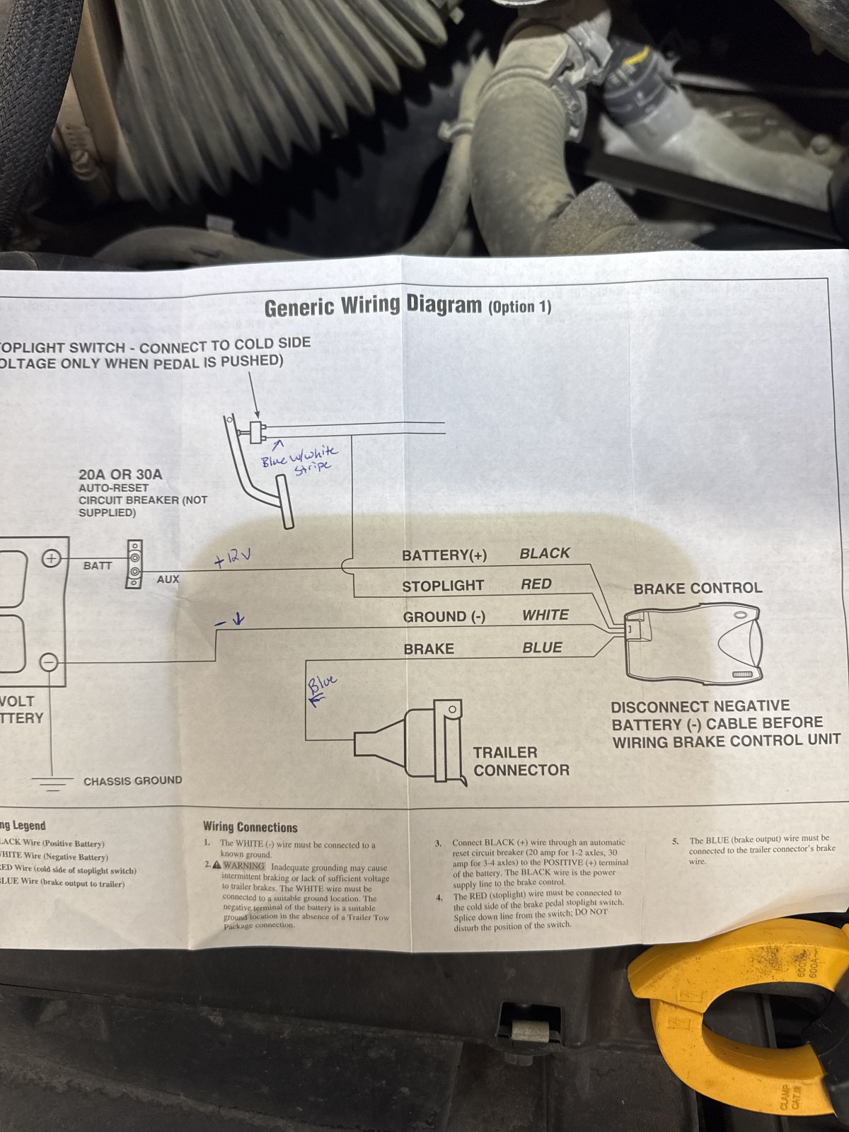

Are you following the guide that is linked below for your connections?
EDIT: it looks to me like the connections should be to the 4-wire trailer bundle, not to a junction box. I can't tell from the under dash pic what's going on there.
EDIT2: That Prodigy P3 is a great controller -- I have one and use it.

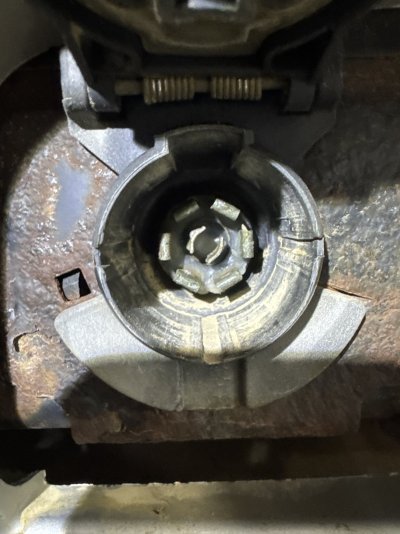

Here’s how I wired it. These wires were hanging out and had been cut by previous owner and I mounted the my controller in the same holes they had on mounted in

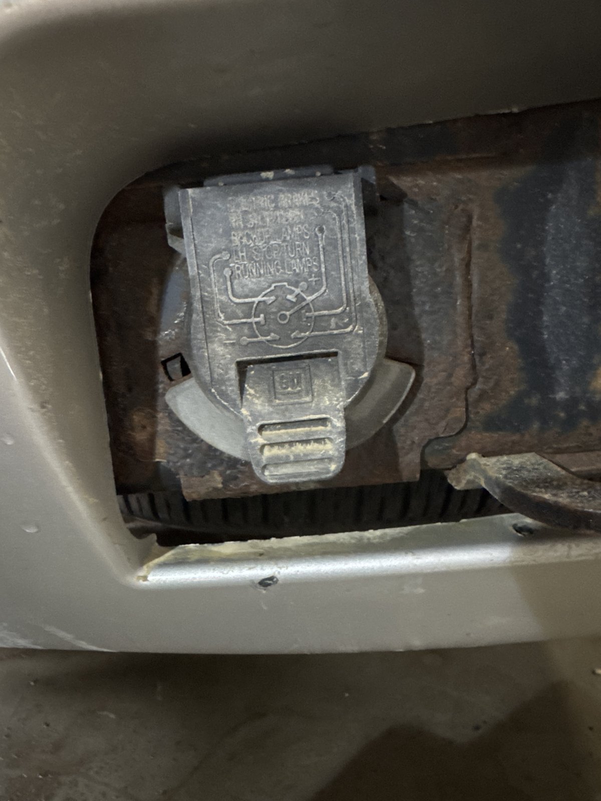

That's a generic wiring drawing for a vehicle that's not wired for the 7-pin trailer connector. Did your Denali come with the 7-pin connector on the hitch? If so, the factory wiring should be there. Unless it's defective, it's the harness to use.

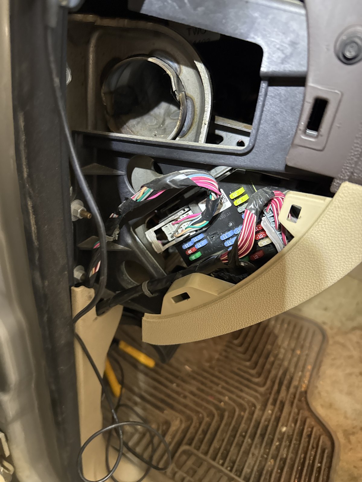

The previous picture I posted was just showing the BCM fuse I pulled to get the 3.9 volts to go away. I have nothing wired into it. The fuse I’m pointing at is the one I pulled to get the voltage to go away.

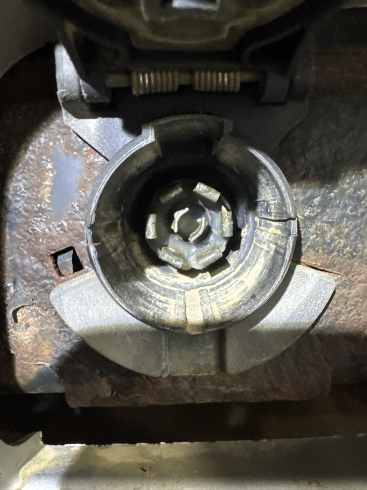

Factory I haven’t added anything on this vehicle.

Yeah, that’s what I did, the wires were short because the previous owner cut them short when removing there controller before trading vehicle in. I spliced them in and the blue/white has a voltage when it shouldn’t. I’m leaning towards replacing the BCM or bringing it to a GM dealer to diagnose
