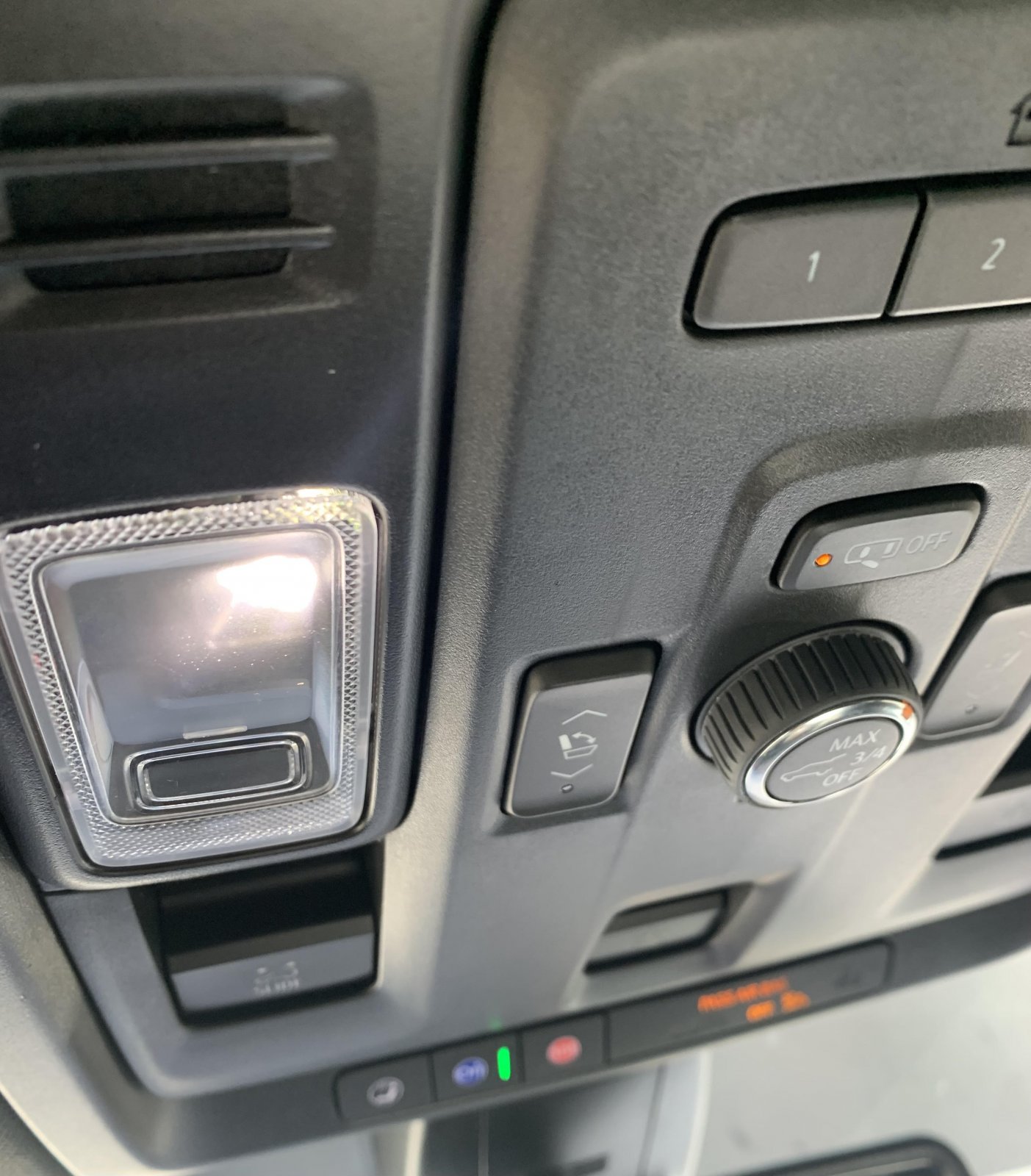

hi all and glad to be part of this new forum. i love my new truck. ive driven mostly japanese SUVs (lexus gx 460) and my family has now grown. had to go with the Yukon XL 5.3. the car has its quirks but nothing beats the size and comfort.
question on interior lights if you can help me. i hit the center switch up top and the orange light comes in to keep them off. my kids sleep and since we do a lot of road travelling, upon arrival to home i like to keep them off as to not wake them up. they still come on! even if the switch has the orange light. i cant figure out the functionality of this interior light and what it is supposed to do. i noticed sometimes it stays off when i open the door to start the car and sometimes it stays on when i open the door. not sure if it makes a difference if i use the remote to unlock or if i hit the door handle switch to unlock
can someone guide me on the "rules" of this interior light on and off button?

thats the problem. the override is ON but the domelights still turn on.

i wonder if its even a valid function. maybe its just buggy or broken? wonder if anyone else is having this issue
