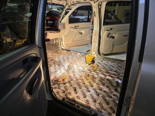

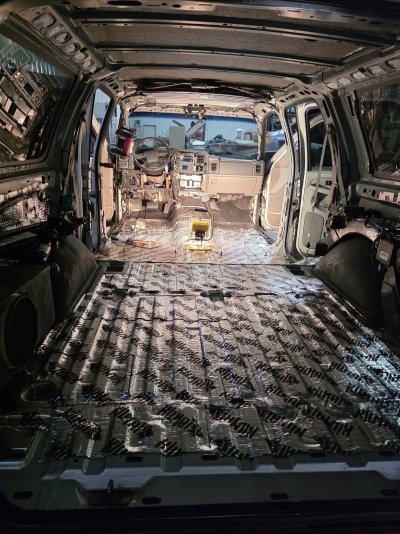

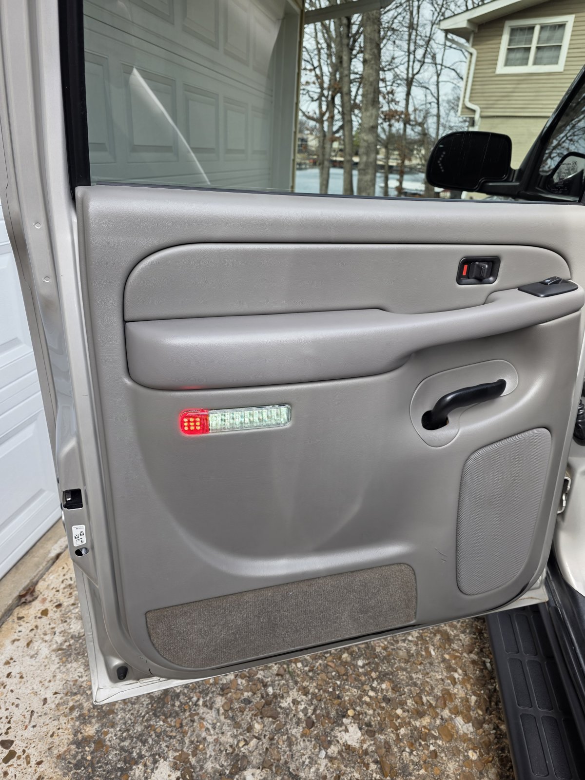

I just installed the courtesy lights in the rear doors of my 2004 Yukon XL. It was completely torn apart for sound deadening, insulation, and headliner. I went from the auxiliary panel in the driver side foot well across the harness to the passenger side and back to the driver side. There are holes for the pins in the door connectors and I just went through those with the wire. I tapped into the gray with black wire to get the power. I used the ground at the B pillar behind the panel. Doing it this way made them function as factory. If you go with the LEDs like I did be warned that they are super bright.
