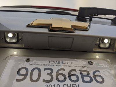

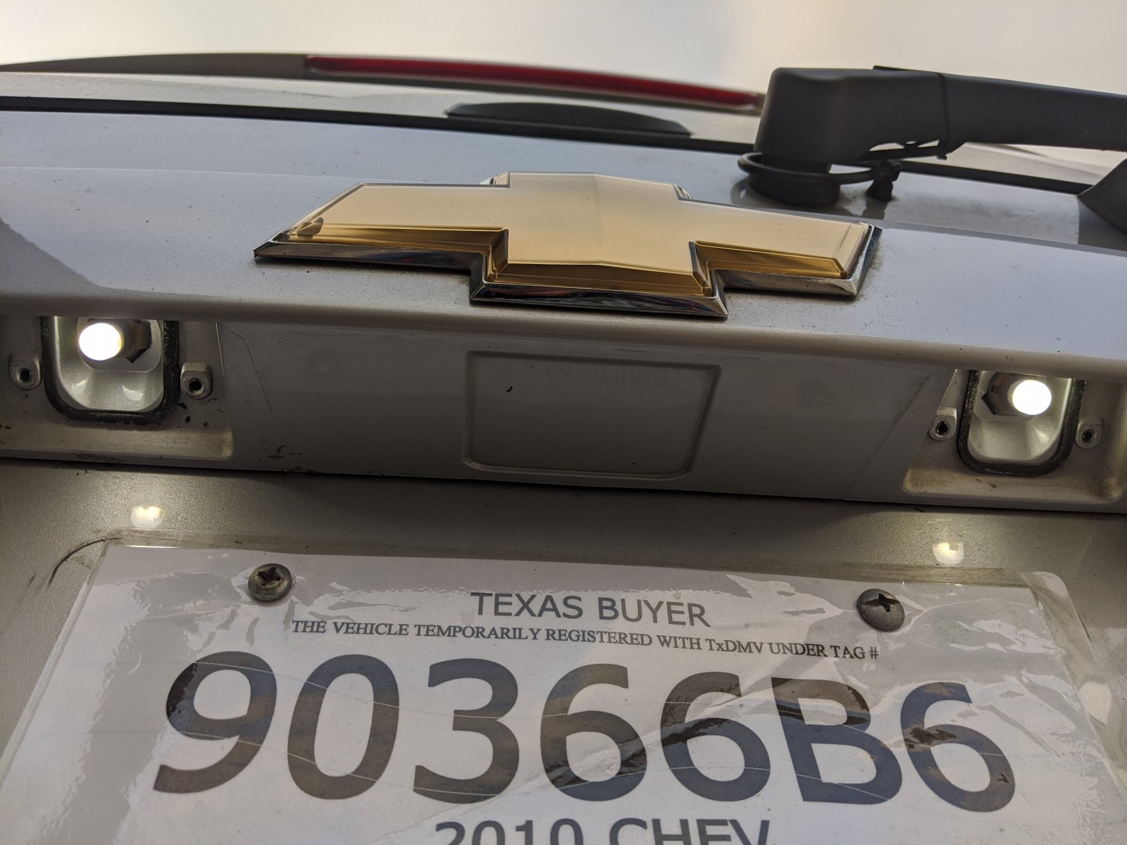

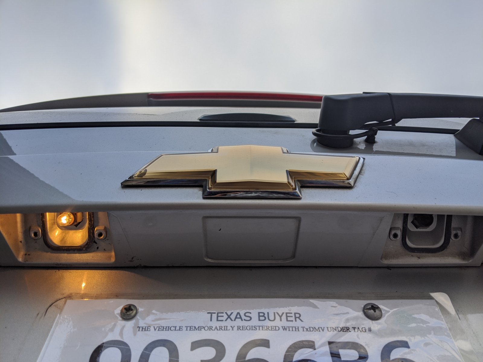

If/when you go to install a backup camera.
The plastic trim piece above the plate where the license plate lights sit.
Seen a few with this problem, including prior owner of my hoe...
Apparently they use locktite on those mounting nuts/bolts
When you try and remove the bolts they can deform the bolts in the plastic cover.
I managed to fix mine, but i have some marine epoxy i used to form new mounts in the cover.
Thanks for the heads up. I'll keep an eye out when I do the backup cam. Hopefully I'll get to it before Christmas!

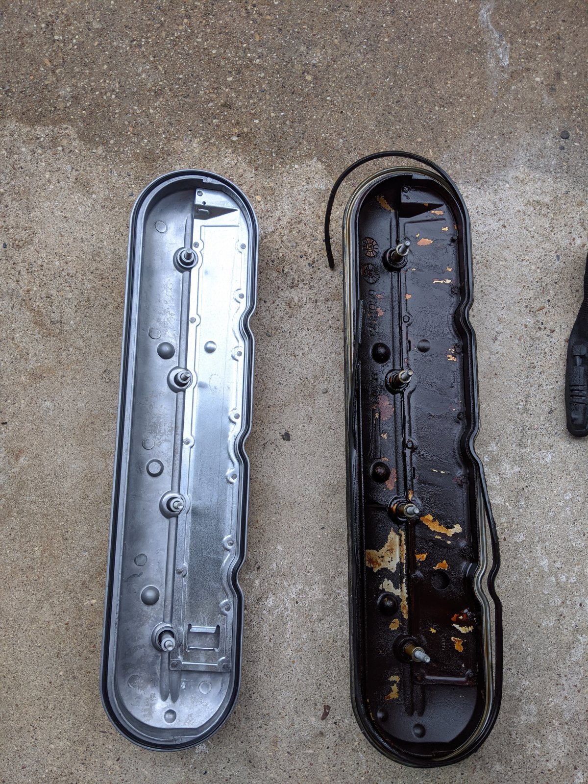

Found out I had a leaky valve cover due to the busted gasket in the picture. So I decided to upgrade to the new style valve cover to fix the oil consumption issue. Hopefully this combined with the AFM delete (via tune) gives my mature 5.3 some extra life.

From my limited knowledge, i think you might have had the update valve covers already?
If not, it's on my list as well.
Not to mention to the time getting the crud/sludge off of them seems worth while.

No it was definitely the old style. (Round hole vs rectangle hole).
