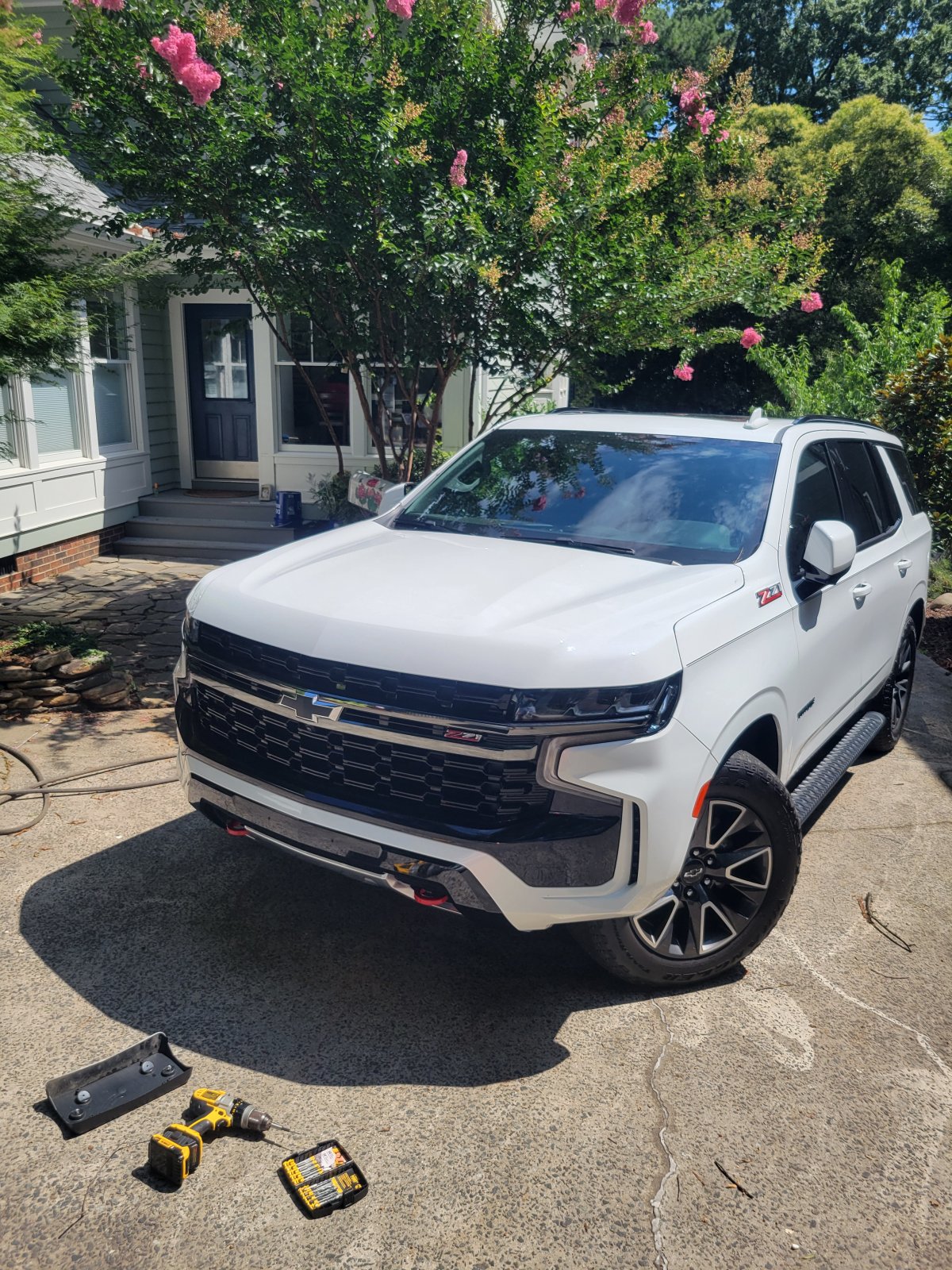

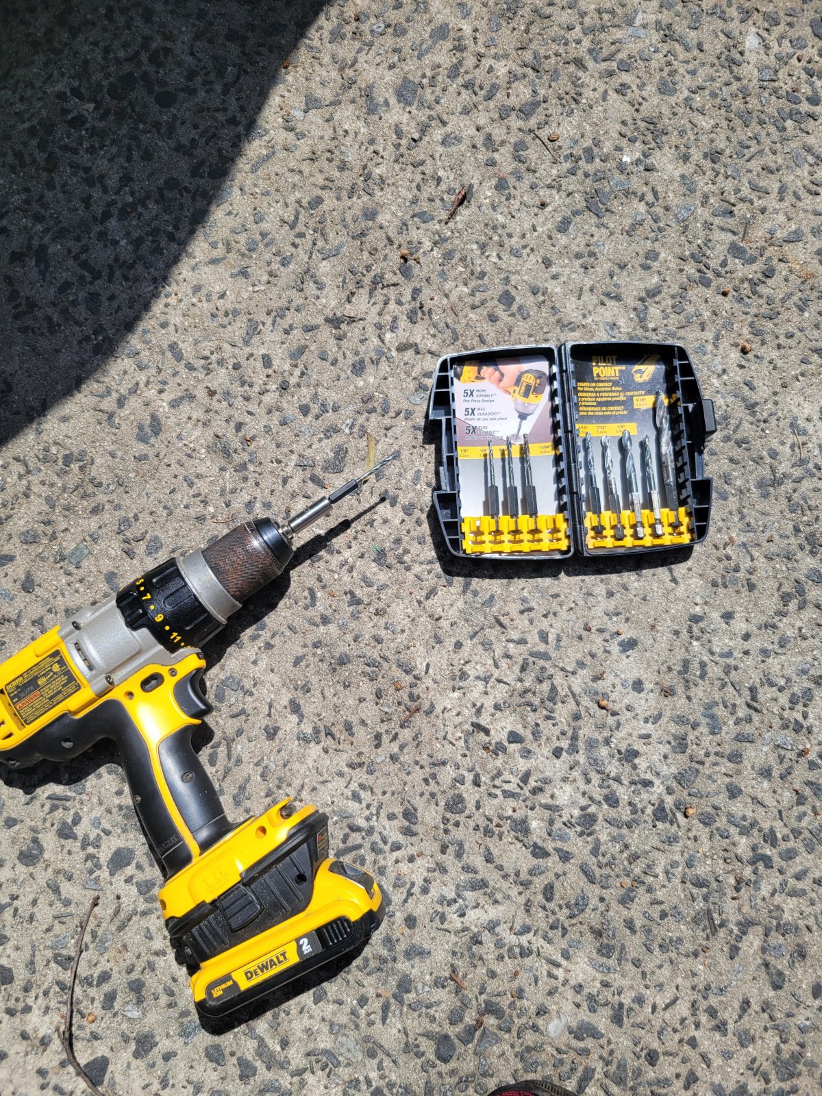

1.) DELETING THE DEALERSHIP INSTALLED FRONT PLATE HOLDER:
I used a 1/8" drill bit to drill out the two rivets
Even though I have two small holes in the front, it looks much better without the plate holder, IMO.
QUESTION: Does anybody have a good solution for the two holes created by the front plate holder?

KMeloney
May 2, 2009
3,475
719
Yes -- Go to an automotive store and pick up a couple of those "Christmas tree" plastic trim push-fasteners, and just insert them in the holes.

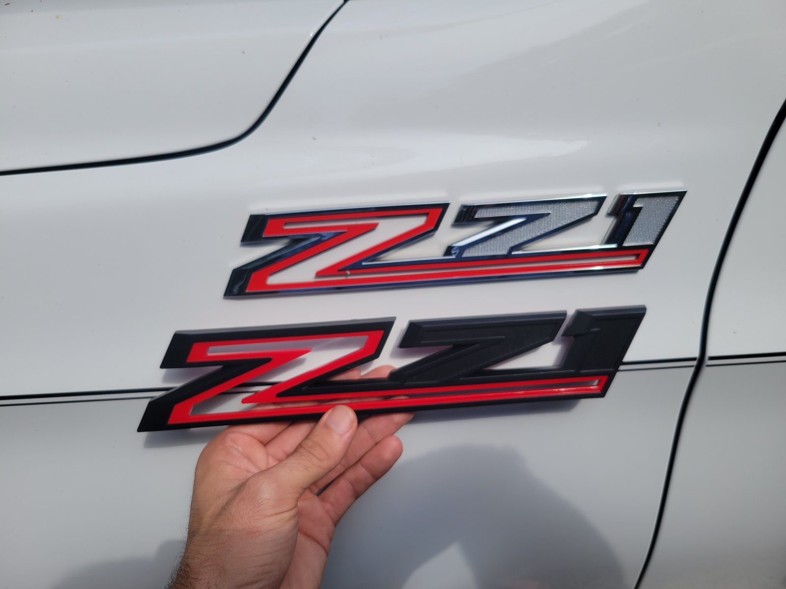

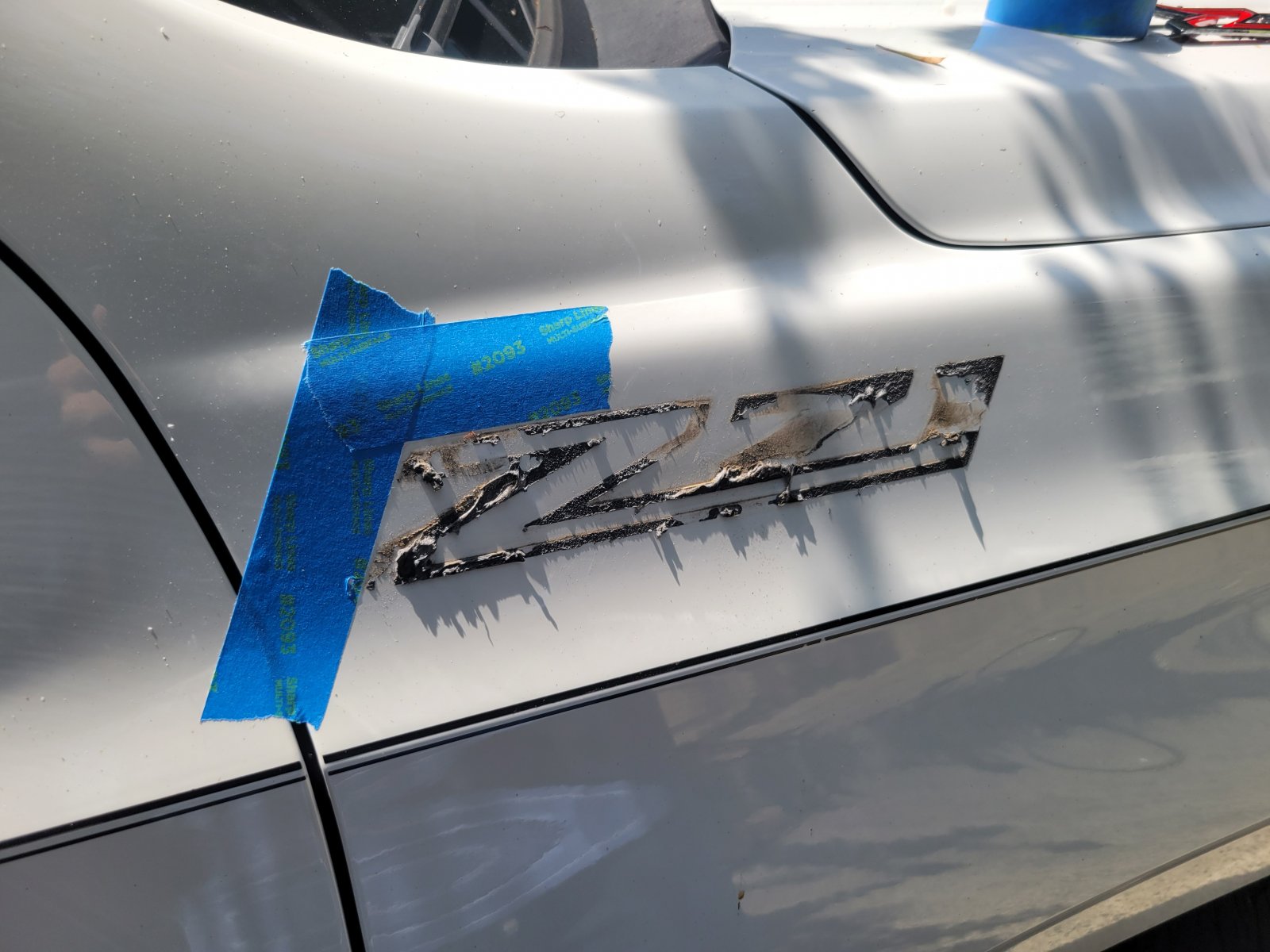

2a.) REPLACE STOCK CHROME Z71 WITH BLACK Z71 VERSION
Black Z71 Badges Purchased:
The quality seems excellent out of the package. I hope the black does not fade with UV exposure over time.
The badges are slightly larger than the stock badges. I personally like the size of these better than the stock.
I used Goof Off Adhesive Remover Spray and a microfiber towel to remove the stock residue.
It took some work and 3-4 rounds to get it all off cleanly. (Perhaps there's a better product?)
I used a new microfiber cloth and alcohol to prep the surface for the new badge.
I'm quite happy with the look.

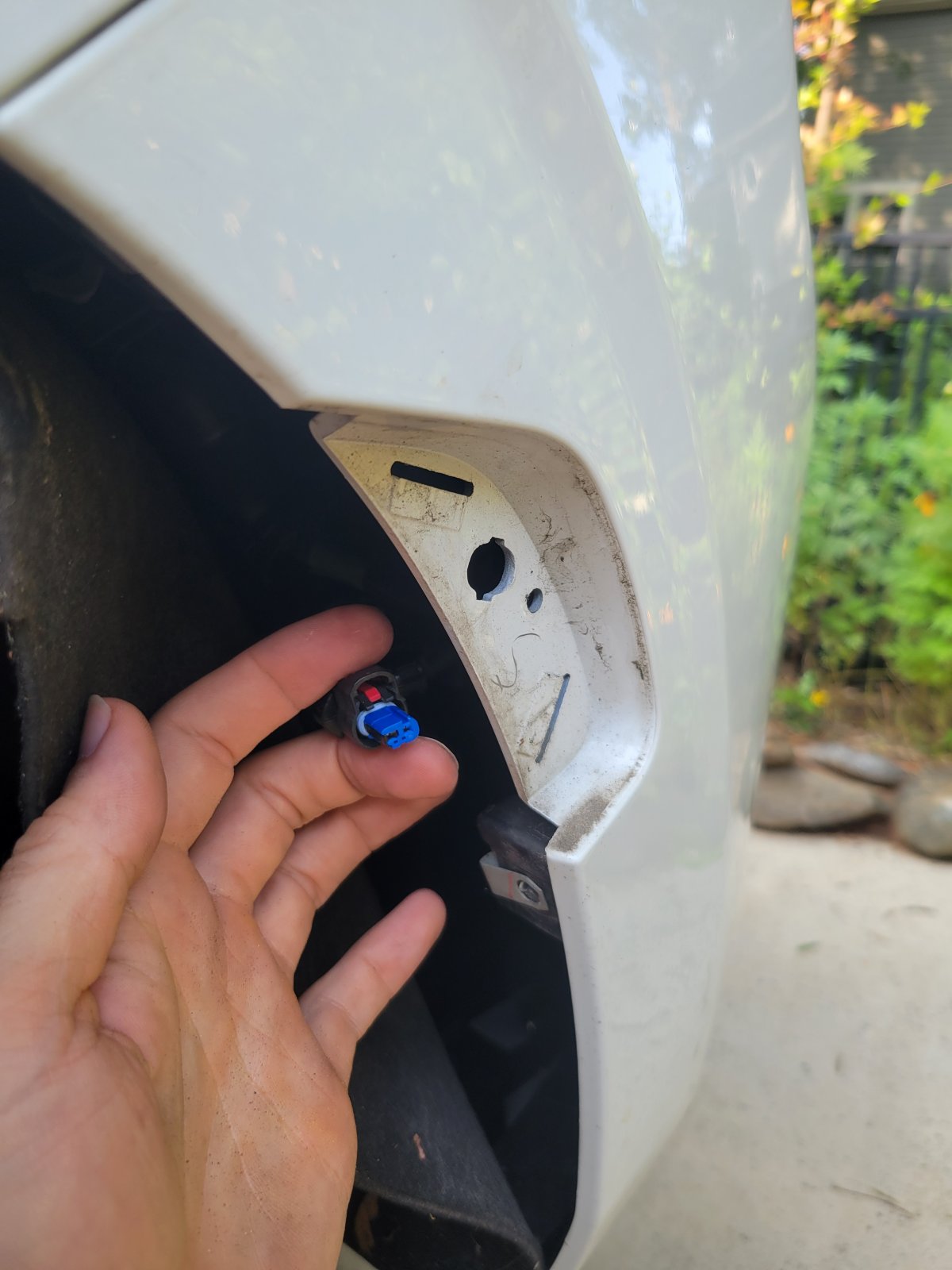

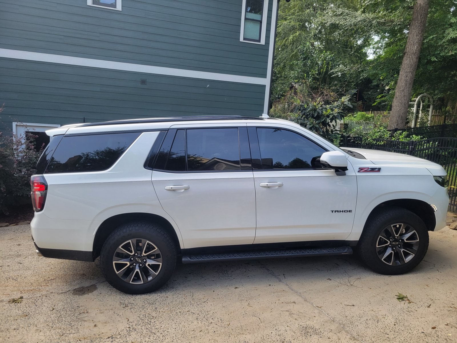

3.) Swapped out orange side markers for smoke LED side markers.
In my opinion, this is a great upgrade for the money and effort.
Video I followed:
Side Markers:
Install, Before and After pics included.
5/5 rating for how it looks when off
4/5 rating for how it looks then car is on. I'm not in love with the LED pattern, and they are a bit bright compared to the other exterior lights. Still looks good, just not OEM looking crisp.
Anybody else out there running different side markers? Would love to see.

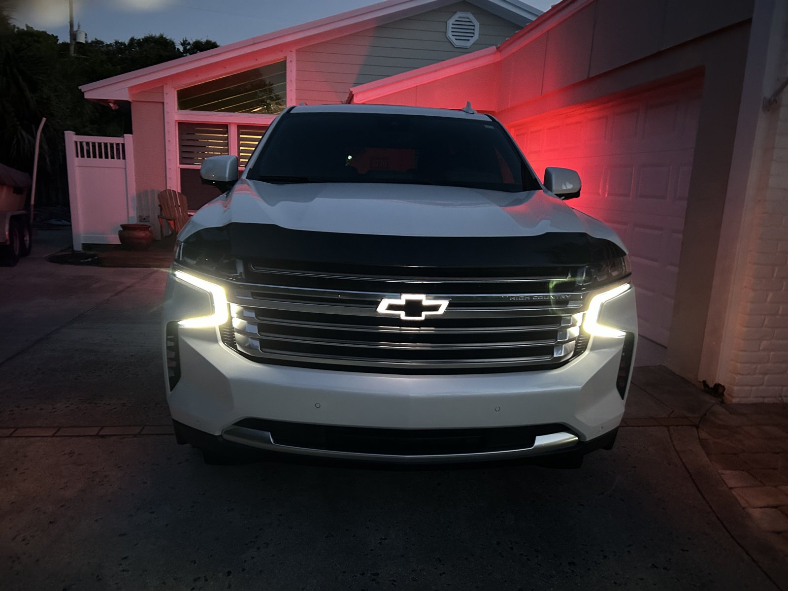

Since you did the side markers and LED taillights the front illuminated bowtie is a nice touch. I also went with the flush mount hood protector. I am in Florida and lots of bugs end up on the front.View attachment 437453
I really appreciate the feedback and picture.
I pulled the trigger on this, and very glad I did.
Pictures to come soon!
