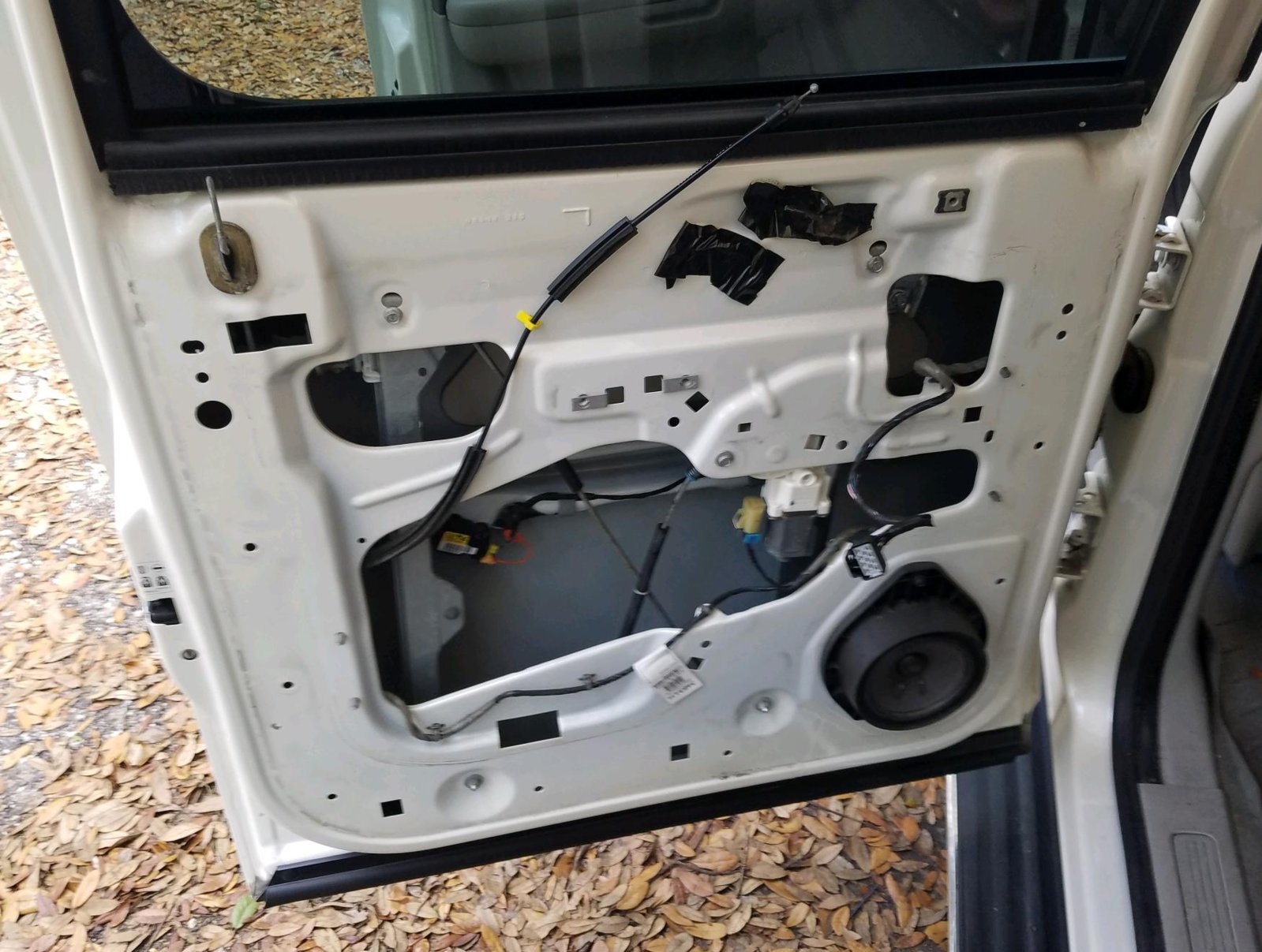

May 1, 2018
The road noise is definitely better/quieter than before.
How much insulation did you end up using, and how much do you think it would take to do the entire floor, doors, and inside panels? Asking for myself.
I'm sorry... I really don't know the answer to any of these questions. I got the sound deadener from my brother so I didn't order it to know how much was there and I didn't measure it because I didn't care... I also haven't done the floors or anything else so I really can't be of any help there.... I am such a failure... lol

If it helps with that question, I bought some Noico 80 mil from amazon and the 18 sq ft was way more than enough to do the front 2 doors including covering the area behind speaker. If I wanted to, it could be stretched to 4 doors if I only focused on primary areas. The door can cover the entire side of floor related to its location so I would imagine 90-100 sq feet would be enough for all doors and floor. Roof and tail gate would be another story.
