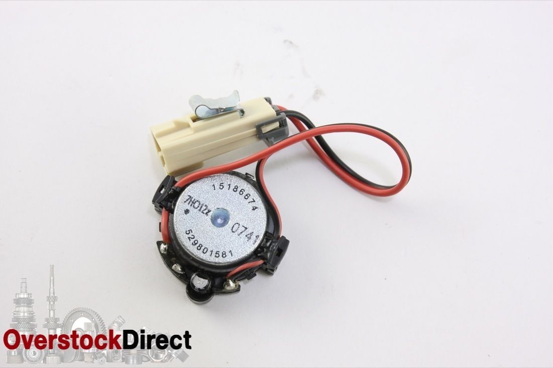

Ok.... who wants to pull the A-pillar tweeters to see if they have the ohms marked on them???
Anyone..... anyone at all?
Any of those numbers make sense, other than the part number?
No Sir.... that is all I could find in pics online as well.... I guess they are probably not marked.
May have to pull one and check it with a ohm meter..... yes I know it won't be accurate but it is better than nothing.

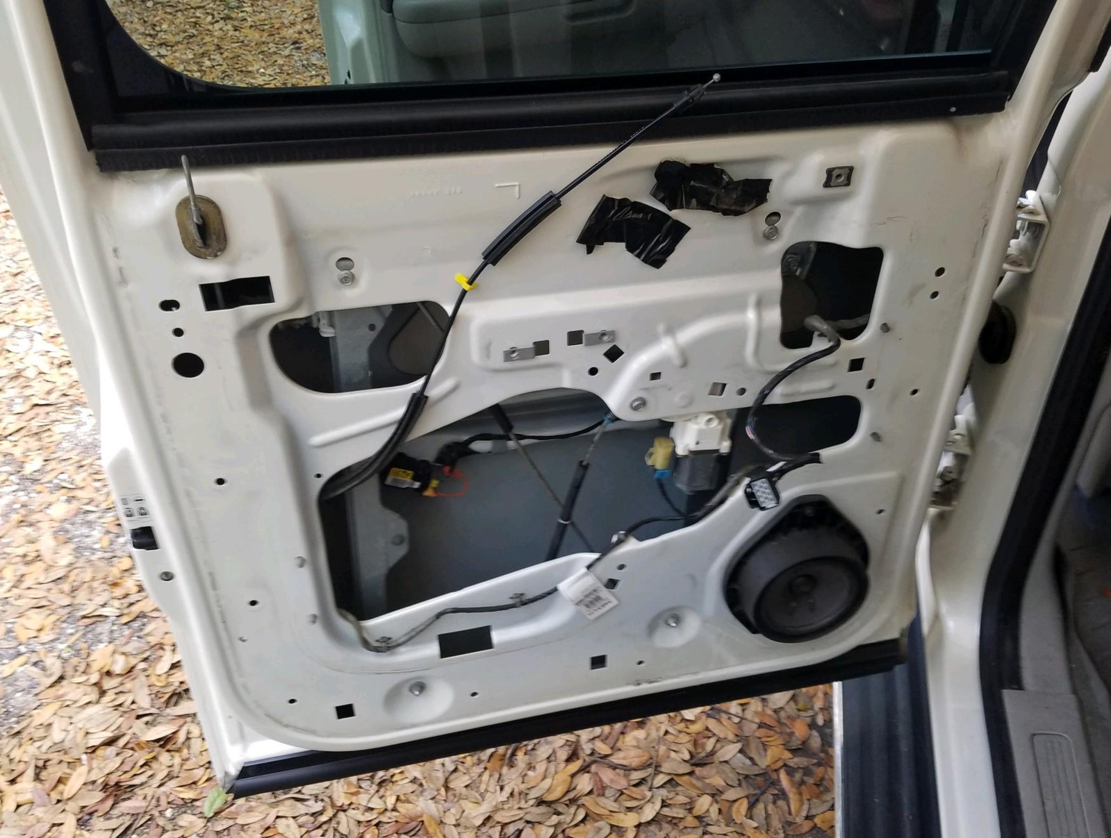

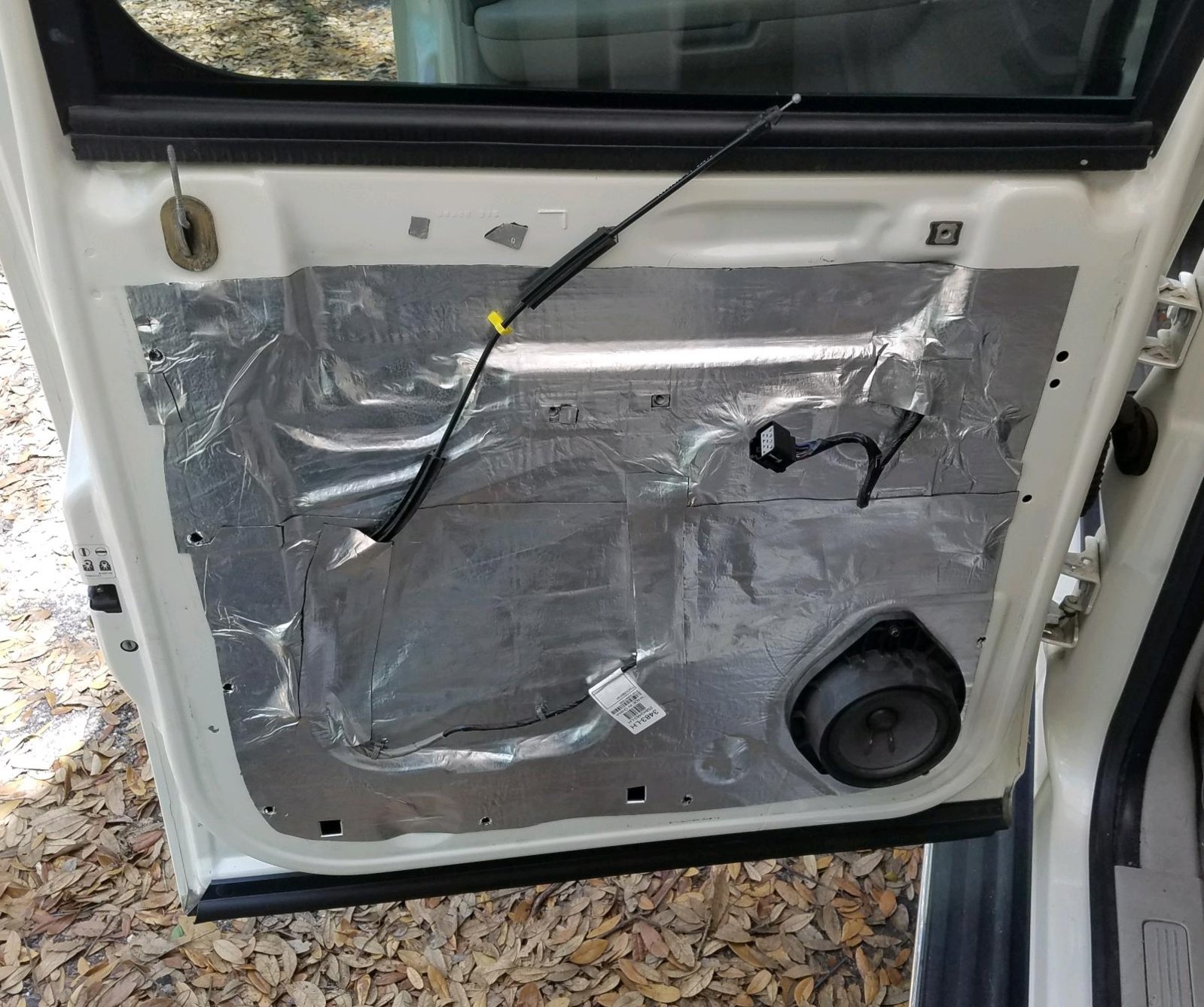

No worries... I am installing the "dynamat" on the rear doors today so I pulled the rear speakers.
2008 Suburban LTZ non-LUX Bose system...
1.9 ohm front door speakers
3.6 ohm rear door speakers
So looks like 2 ohm front and 4 ohm rear replacements would be in order.
Not sure how 2 ohm speakers in rear would affect the amp or the sound... I would assume the rear speakers would be louder but it may cause the amp to run hotter.
I am going to wait a while and see how sealing/sound deadening the doors is going to improve output... who knows, I may not need to upgrade.
Before...
After...
How's the "dynamat" on the door with road noise?
