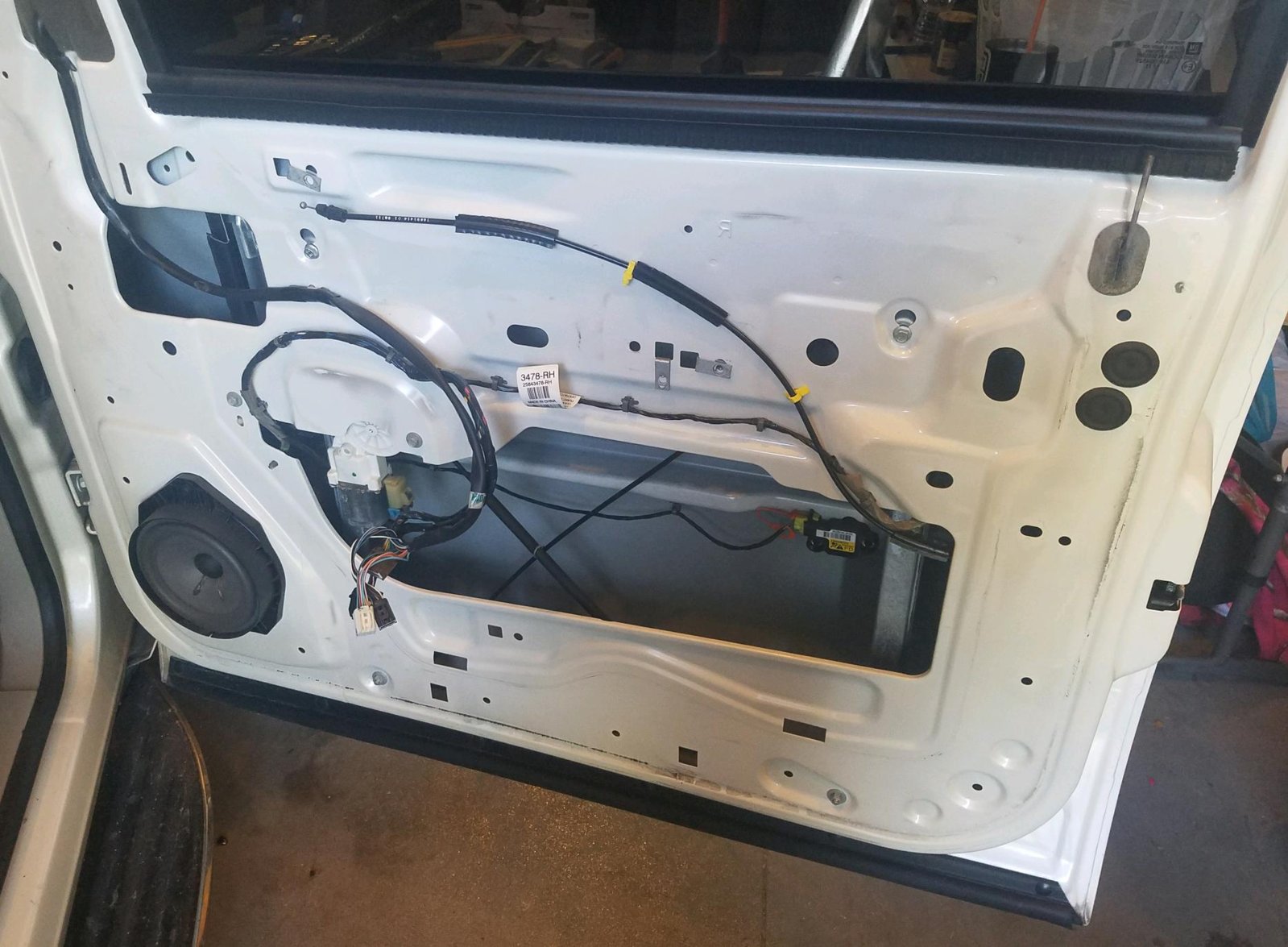

Before...
After...
Still need to do the rear doors.

No worries... I am installing the "dynamat" on the rear doors today so I pulled the rear speakers.
2008 Suburban LTZ non-LUX Bose system...
1.9 ohm front door speakers
3.6 ohm rear door speakers
So looks like 2 ohm front and 4 ohm rear replacements would be in order.
Not sure how 2 ohm speakers in rear would affect the amp or the sound... I would assume the rear speakers would be louder but it may cause the amp to run hotter.
I am going to wait a while and see how sealing/sound deadening the doors is going to improve output... who knows, I may not need to upgrade.
Before...
After...
