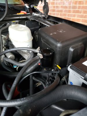

So I completely forgot I made a build thread lol. I'll just go with most recent. I dont remember what had happened since December but I just did knock sensors and every gasket pretty much involved with that job.
I also picked up a set of 20" Z71s that I traded my 22s for.
Cleaned throttle body and intake manifold. Along with injectors and fuel rail with new o rings. Installed catch can and used a paint marker on the engine cover.
Next up is transmission flush and filter. Then when I get around to taxes I want to replace the leather seats.
20190124_141638.jpg 20190124_112054.jpg 20190214_204709.jpg 20190212_104839.jpg
