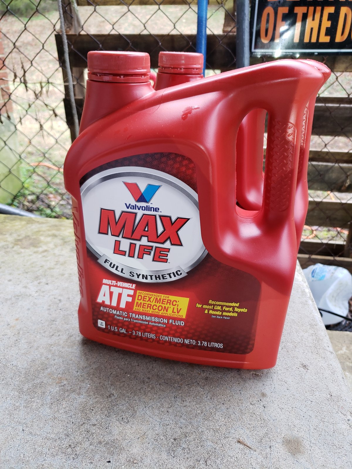

I used valvoline fluid to push the old stuff off then filled it with ac delco fluid.

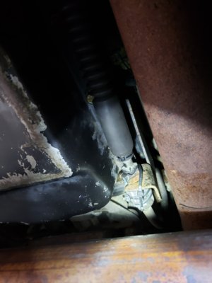

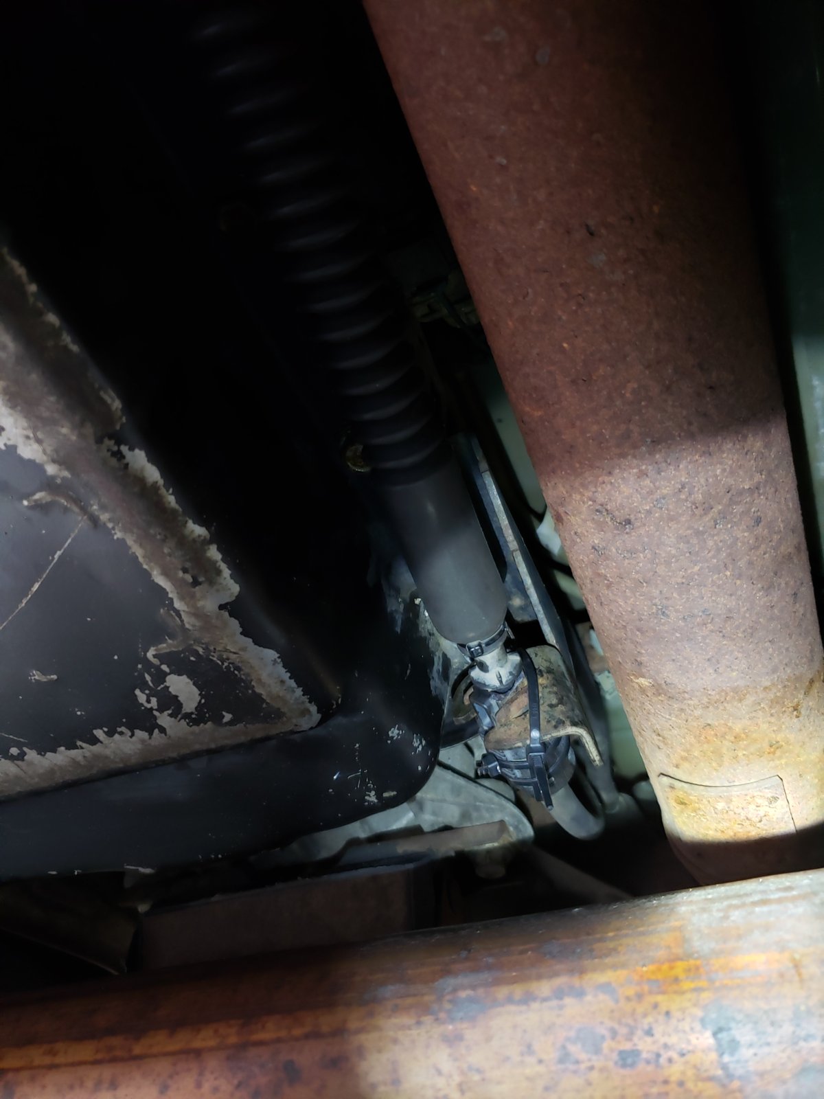

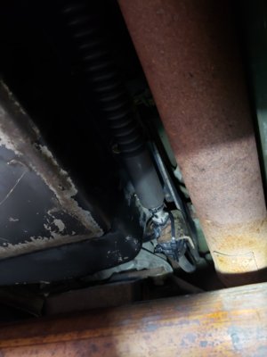

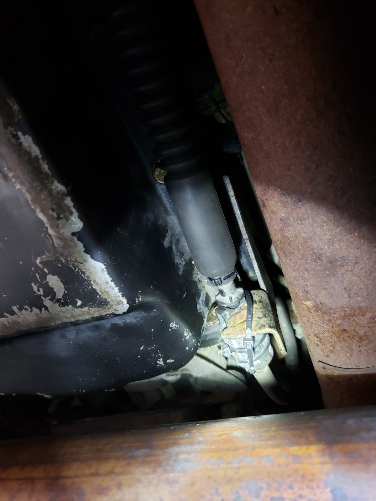

Side note. I think this retainer broke. I had to zip tie this part in place or the truck wouldn't go into park. Does anyone know how to fix this and what is involved?
I have no clue how this broke (I did use a pry bar to move the bracket out of the way but I never pulled this clip.

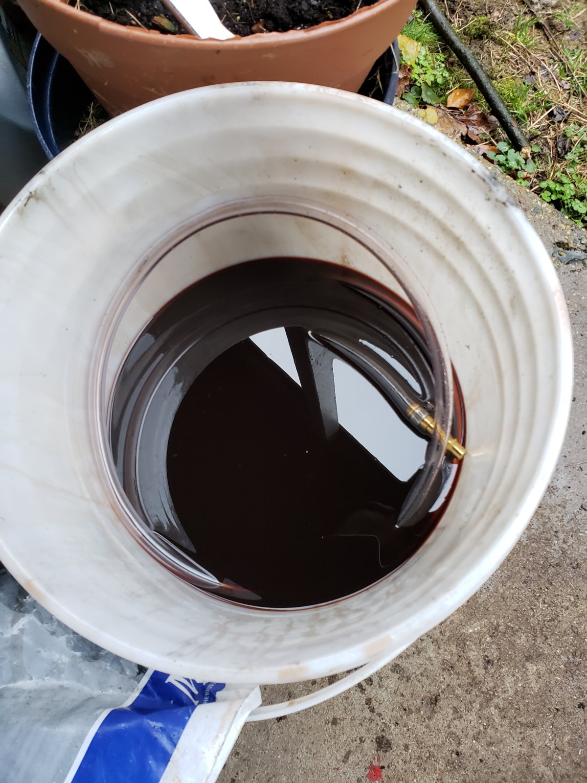

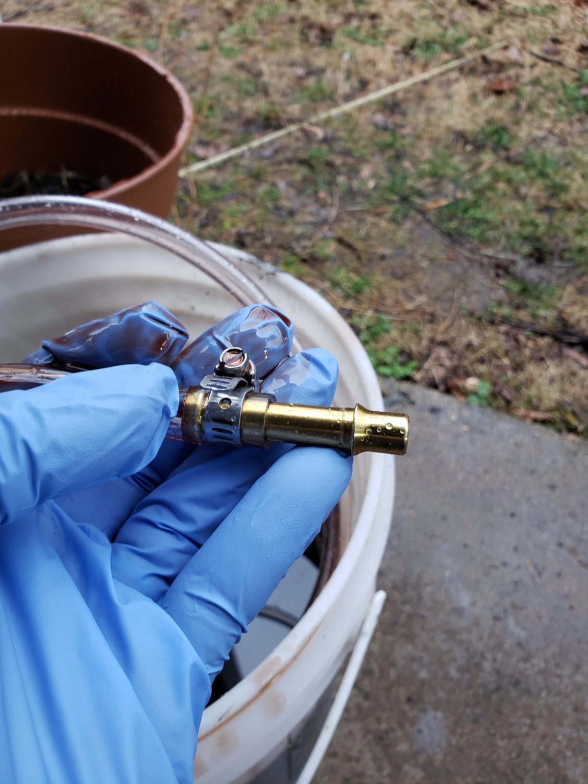

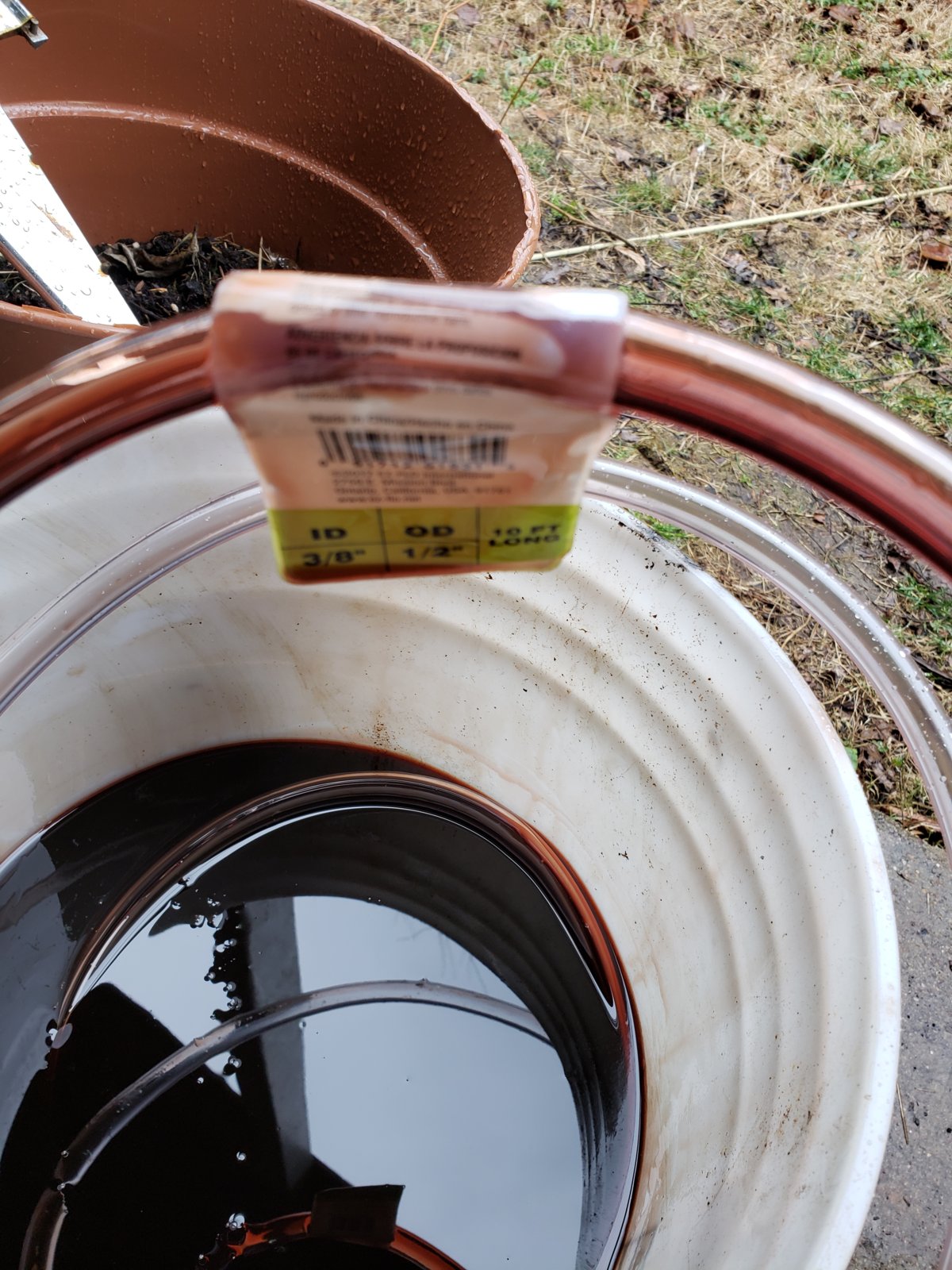

I got a fitting off of Amazon and connected it to the top left (if you're looking at the engine) side of the radiator. Ran the line into a 5 gallon bucket then started the truck with my remote start. Once it started to bubble and gurgle I stopped it.
Then I jacked the truck up. Removed all 16 bolts (had to pry the shift bracket back a little) I did NOT have to drop the exhaust. Once the pan was off I drained the rest of the fluid in the pan into the bucket.
Then I cleaned the pan and magnet along with gasket mating surface.
I then placed the gasket on the pan put all 16 bolts in to hold the gasket. Then carefully aligned the pan. Bolted it up.
I then ran the 2 gallons of Valvoline through the transmission via the dipstick tube while the other hose was still con6to the radiator into the bucket. I did so until the fluid was bright red.
Then I topped it off with the ac delco.

Just as I finished I realized the transmission wouldn't go into park That's when I saw that the shift cable was not being held in place by that retaining clip. So I rigged up some zip ties to hold it in place until I can figure out how to fix it for good.
