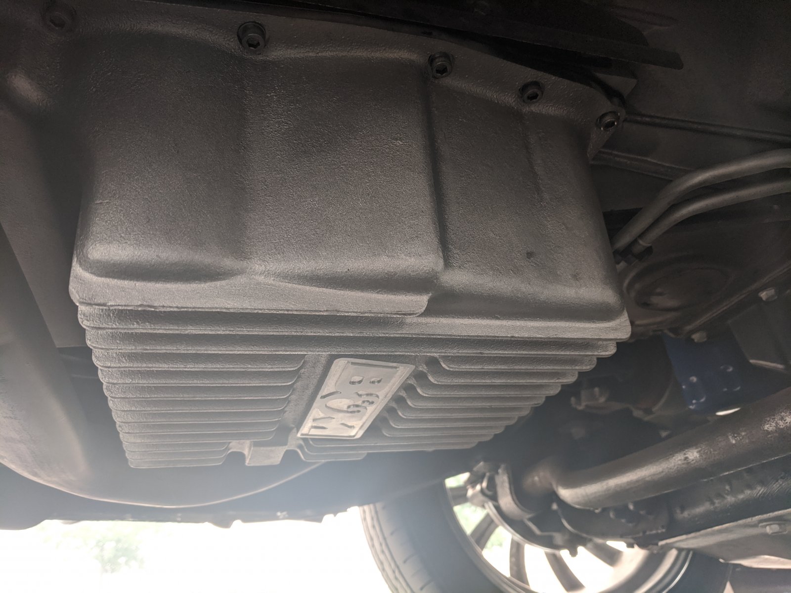

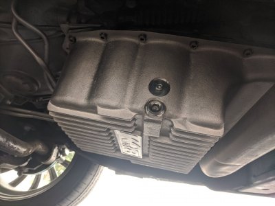

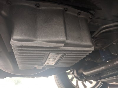

Got the B&M transmission pan installed with a transmission service,no extra cost since they have to pull the pan anyway, and a transfer case service, $239 out the door from the dealer

shops around here won’t install any ‘aftermarket parts’. Bologna.
I don't see why not, doesn't void the warranty unless it had a visible defect that caused something to fail and fitment is identical it just adds 2 quarts extra capacity
if it was something that required modification they wouldn't do it.

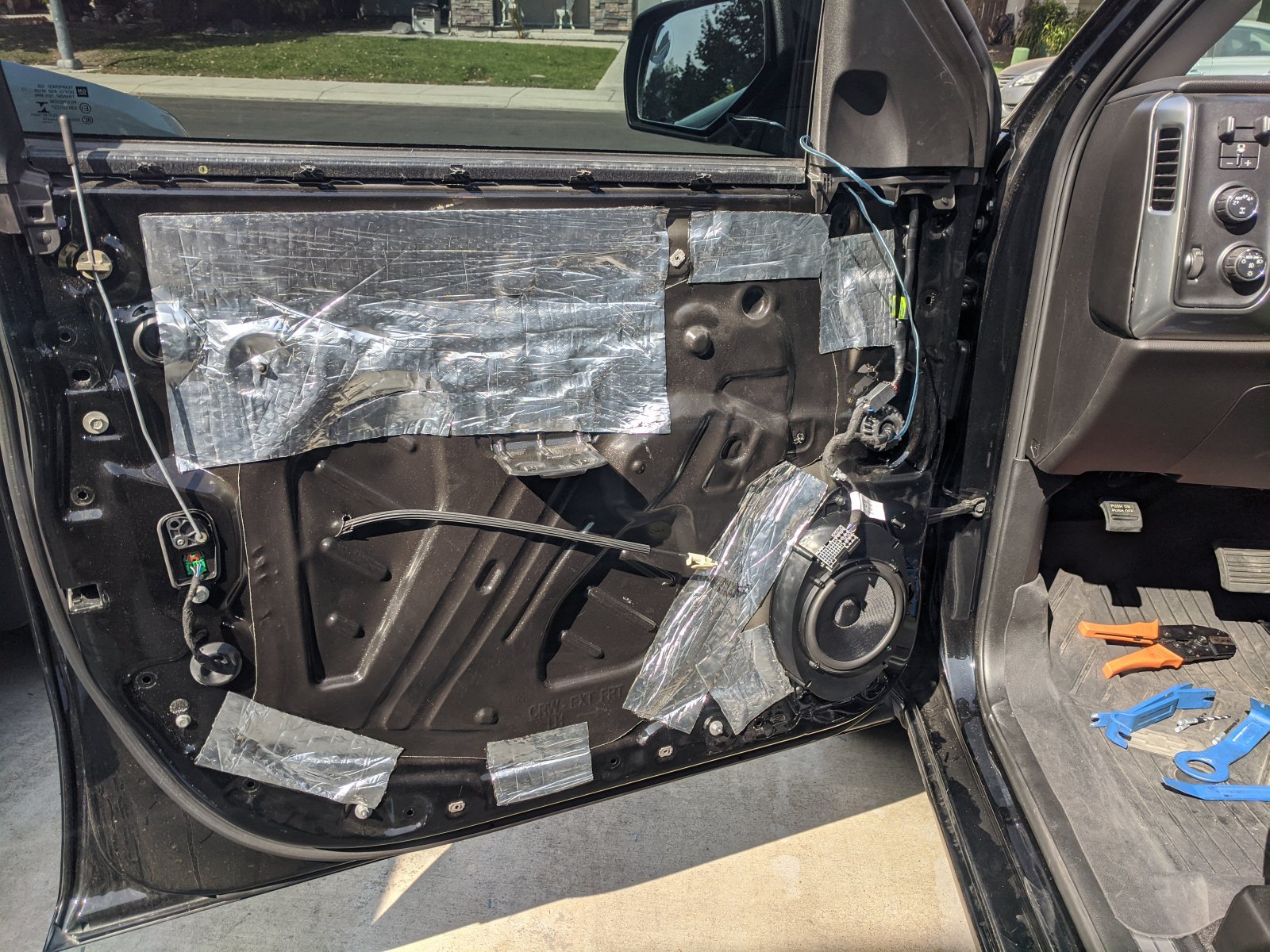

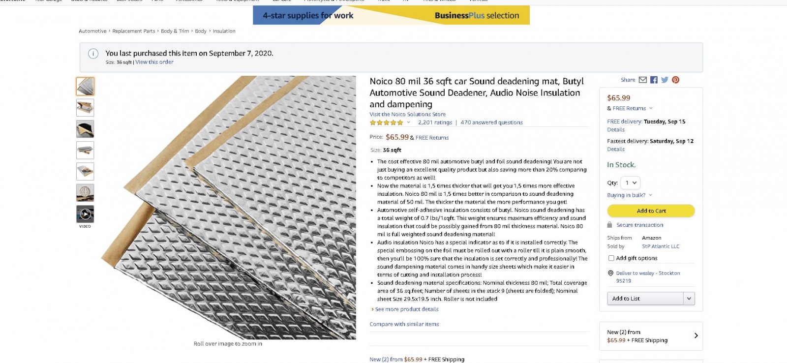

ordered some sound deadener for the doors the front doors on the silverado rattle like hell even from the factory speakers, need to get started on getting all this stuff installed hopefully in about a week or so once this heat wave goes away.

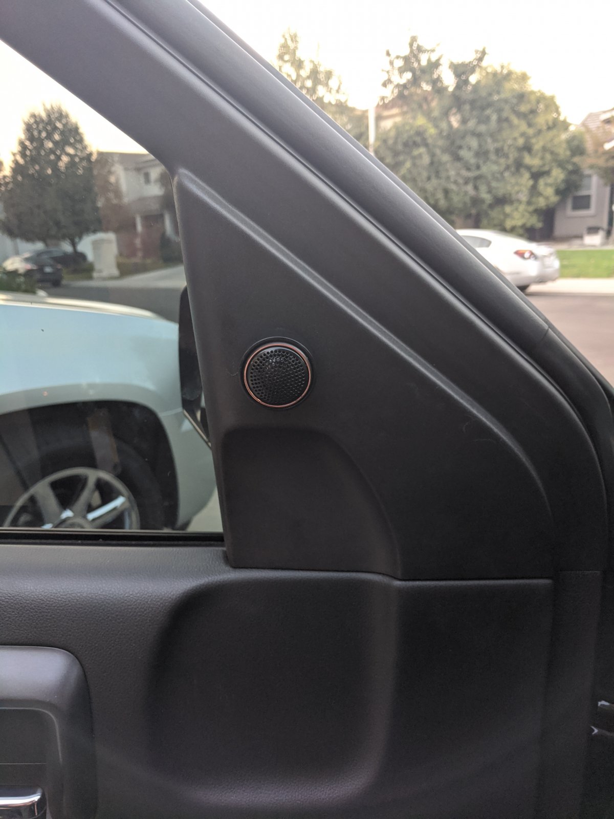

This is a bit more work than I anticipated, got the crossovers installed and 6 1/2 driver's, going to put the tweeters up by the mirror triangle once I figured out how one side should go the other side was easy, mounted the crossovers inside the door had to drill holes and more holes to zip tie the wires so they won't get caught in the door stopper, funny the stock bose amp doesn't even put out enough power to fire the tweeters thought maybe something was wrong but hooked them up in the house and all is well just need to get the amps installed and the dash speakers, not really sure what I am doing with the sound proofing but whatever

Wondering how you mounted the 6 1/2” speakers in the door? Oh wait...never mind, wrong year of truck!
30,552
48,018
The originals were 6x9 so I bought the metra adapter brackets for 6.5

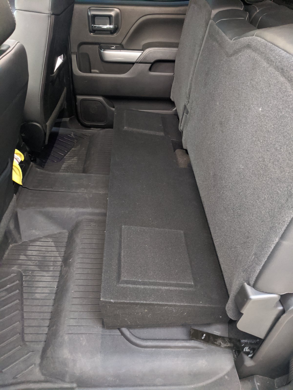

Made the doors rattle like hell, I like the bass in the back
