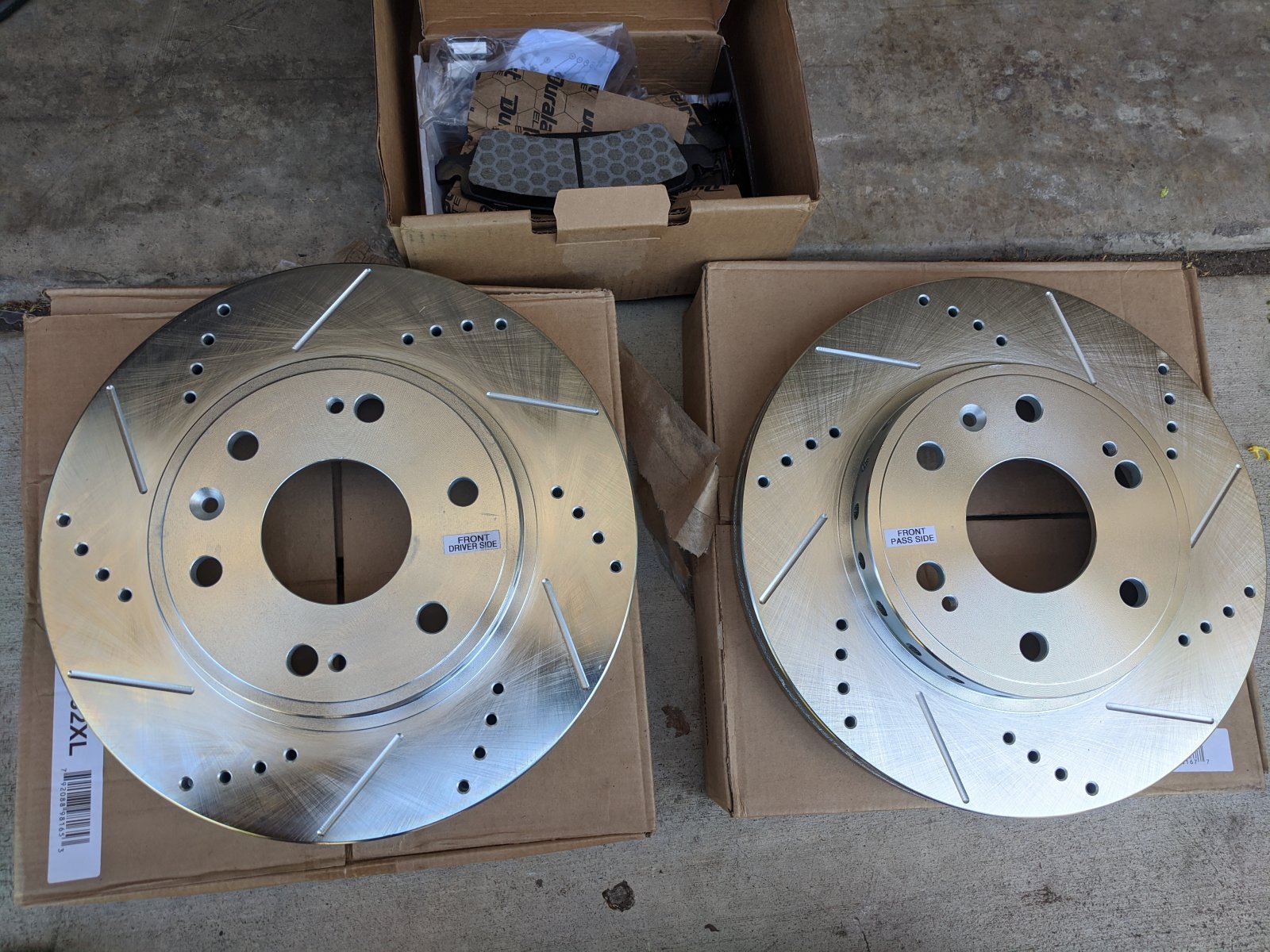

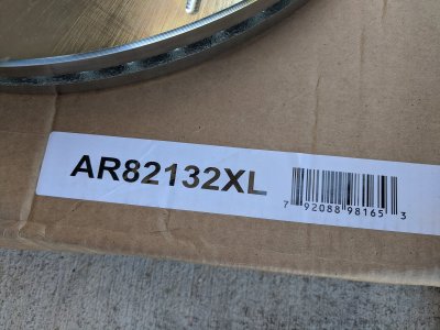

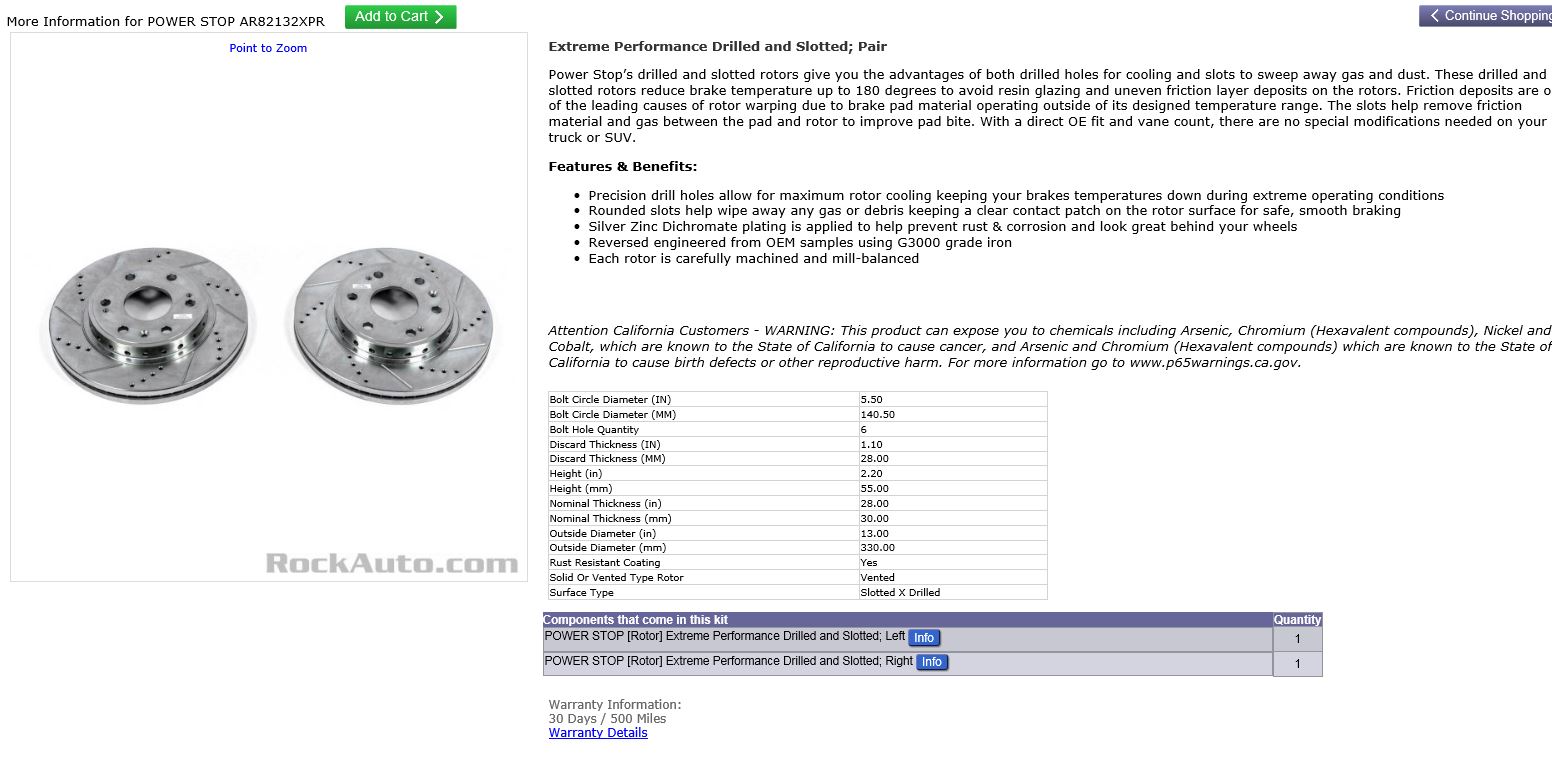

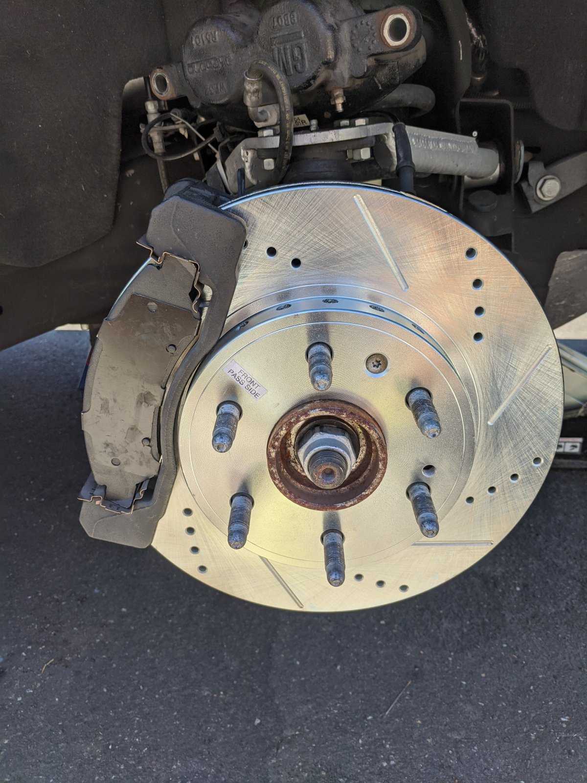

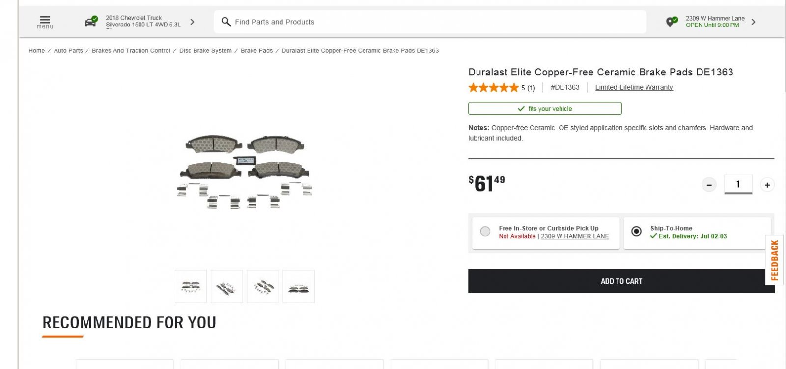

brakes started squeaking at me today so new rotors and pads on the way, ordered the powerstop police rotors, not sure why they only market these to the 08-19 tahoe's the dam things are just oem rotors that they vented, drilled and slotted. and apparently copper is being removed from brake pad material because it is "hazardous" :rolleyes:
View attachment 250879 View attachment 250880
In Cali everything is hazardous, and everything causes cancer--including oxygen, dirt, ice cream etc.

ya I read up on it and there was a law made for california and washington that all brake pads have to be copper free by 2025 so of course the rest of the country has to follow as well, supposedly...the new material should be better, time will tell
