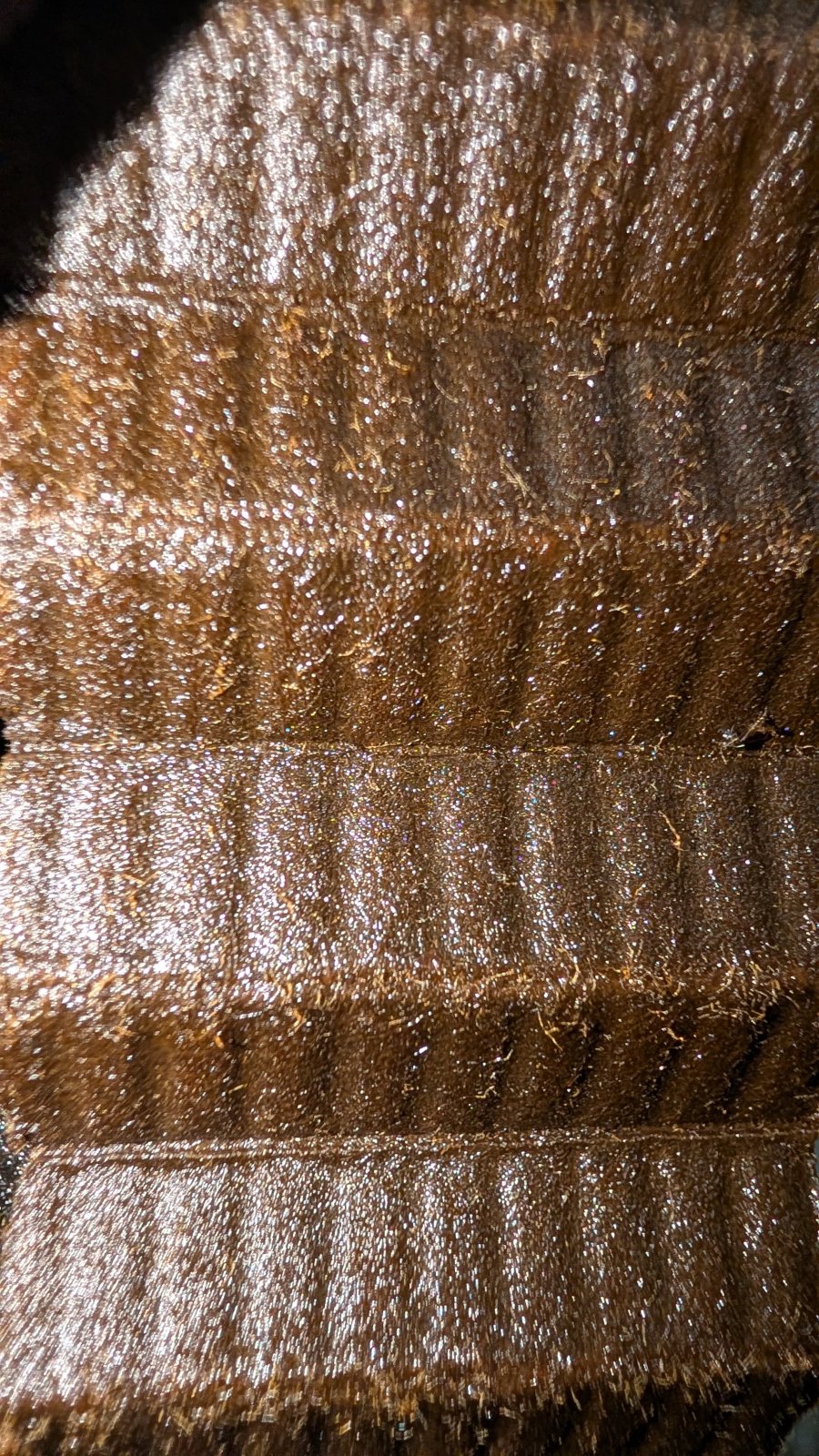

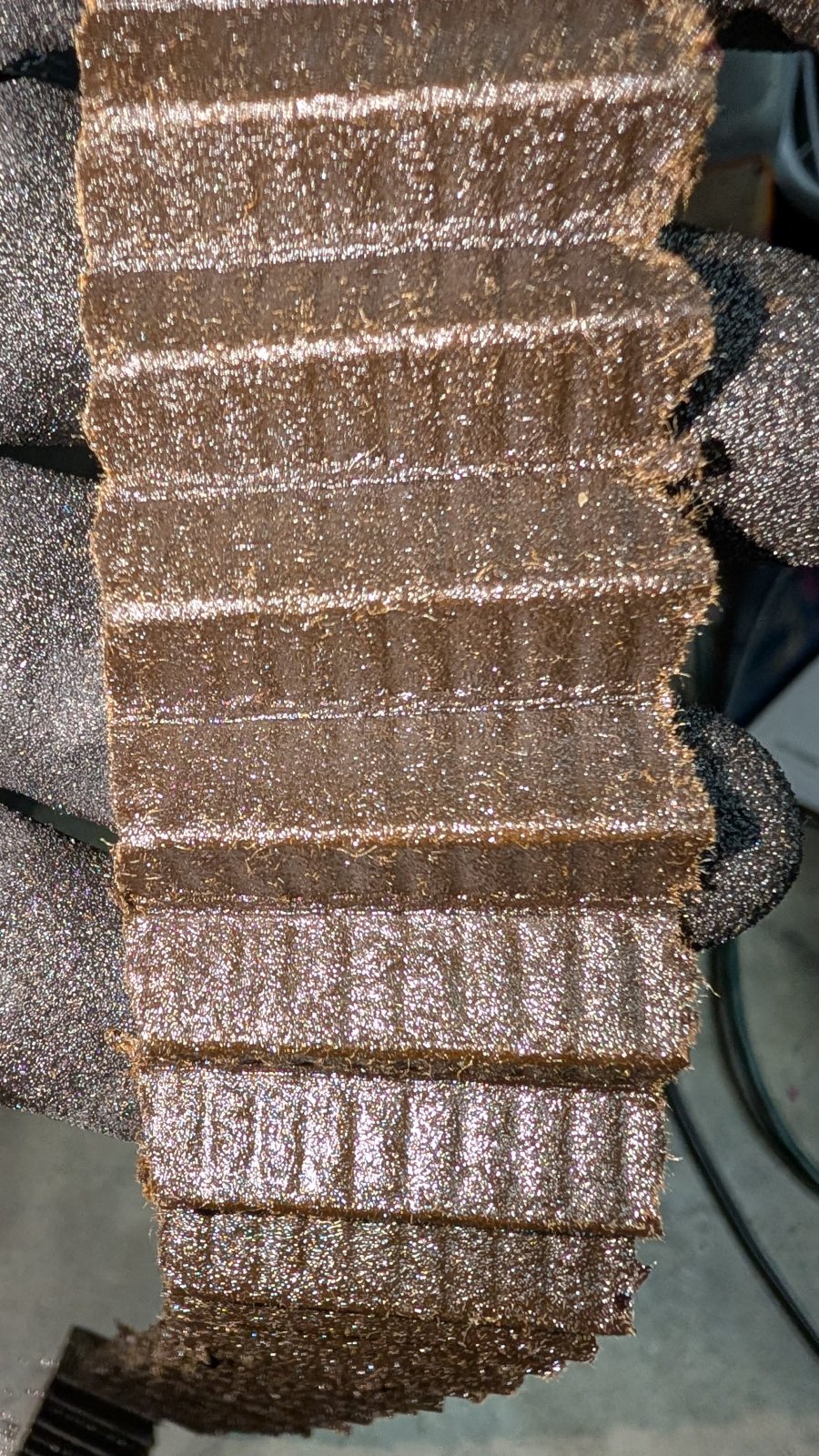

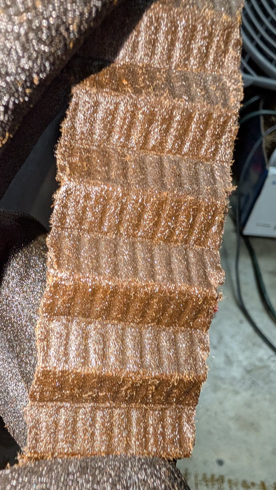

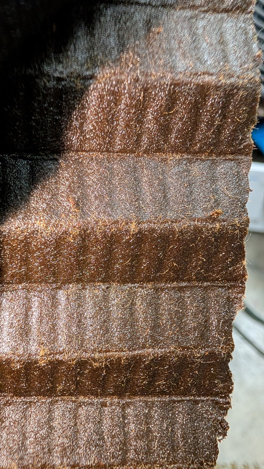

Here's the pics of the filter. I honestly do not see anything in it. But when I looked at the left over oil in the filter, I saw a few specks of gold/copper. No chunks though.
Most of my driving is city driving. I just got the rear end rebuilt after the govlock blew up so this is a big downer. Honestly I was thinking the 4L60 was going to be the next major repair down the road; not the engine.
I get that this will need to be repaired at some point, but what are my options? If it just the rod bearings, is it just as much to fix that as getting a rebuild? And then if I do a rebuild, does it make more sense to buy a rebuilt engine?

glitter in the bottom of the pan after dumping the oil isn't great.
these ls engines don't usually eat a main or rod bearing first before the valve train. but crazy stuff happens.
I'm honestly not sure where that's coming from by lookin at the pics.
what is best to do is hard to say. you could try as said above about sending off an oil sample. they might be able to tell you what that metal is coming from. to know for sure you'd basically have to pull the engine, tear it down and inspect it.
finding a rebuild engine that you can trust is kinda hard these days someone else will probably have better advice than me. but for now, maybe change the oil a 1000 miles, or at least pull the filter and inspect. might get a sense of its getting worse.

I think I cried wolf too soon. Me being an occasional idiot, I totally forgot when my GovLock blew up a few months ago, I drained the diff oil with all the chunks and bits, into a plastic oil container that has a drain/pour snout. I use the same one for all the oil changes. When I did thoroughly clean it today, the metal bits were silver (not copper). And when I poured out the old motor oil (from the other day), I smelt the fragrance of diff oil in the container.
I thought I had wiped it down when I drained the diff oil but I don't remember spraying it down with brake clean and really cleaning the metal off. :doh2:
Anyways, I am going to play it safe and drive my Tahoe a few hundred miles and then change the oil again and see it there is anything then.
