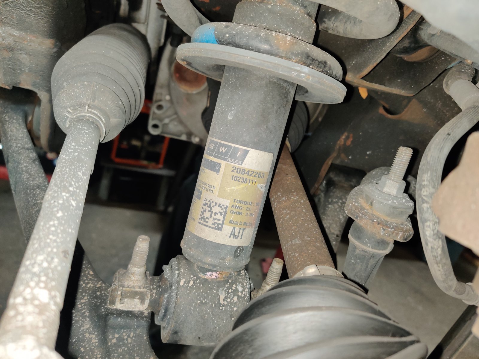

the only replacement I have found for the front z55 suspension is Monroe 40049 which is in that $300-$350 range. if I remember correctly the AC delco equivalent is about the same price.
this is what is on my truck now

When I looked up for my 14 denali awd.. I got the monroe 40048 w Z55 Susp
and the ACdelco # was 580-434
Hope this helps.. This would be the correct OE replacement... And retain
the factory Z55 active handling. Which is what I'll do when it's time.
