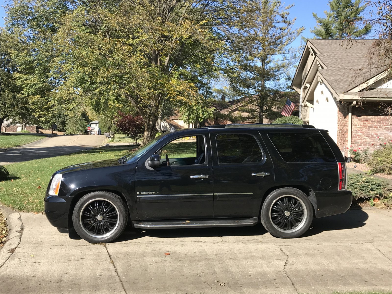

Had it out driving today to get things to settle and make sure it didn’t fall apart. Held together lol.
I had to take the level sensor rods that were supplied, cut half the threads off of each end and reinstall.
Compressor would continue to run when I first drove it. With the shorter rods it only does it’s test run after start for like 5 seconds.
Needs an alignment but here it sits.
factory 22s with huge 305/45/22s on it. Lol

Sounds like you have the AutoLevel links set about right.

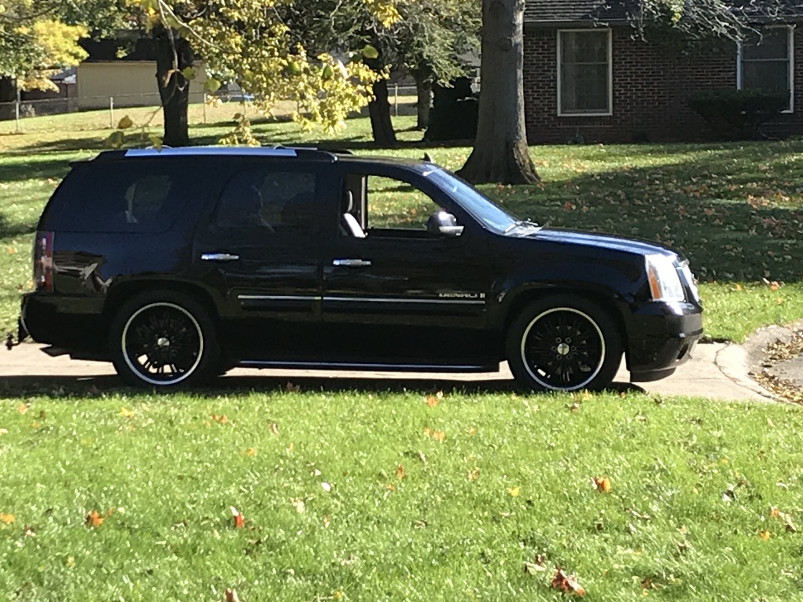

Yes sir. At least as it sits now.... we will see if any settling happens, but.... maybe I will figure out using the system to keep the airlift bags at the right level.
I have some ideas for that and possibly figured it out.
I think I really want to use it or find a way to have an autolevel system in the truck is my wife drives it a bunch to Girl Scout events etc and I would hate for her to have to add air to the bags when she has it fully loaded with kids and gear.
we will see.
Here is another picture. Not sure if it’s better or not. Lol
45,011
What's the total drop, 4/4? Did you measure anything before and after? How about a direct side pic next time it's outta the garage?

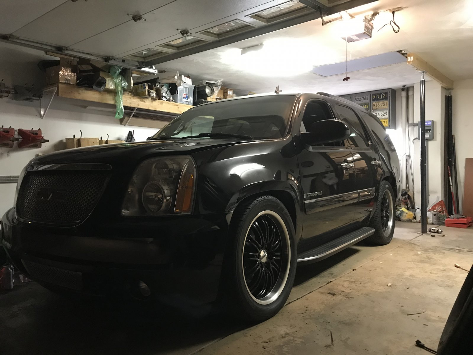

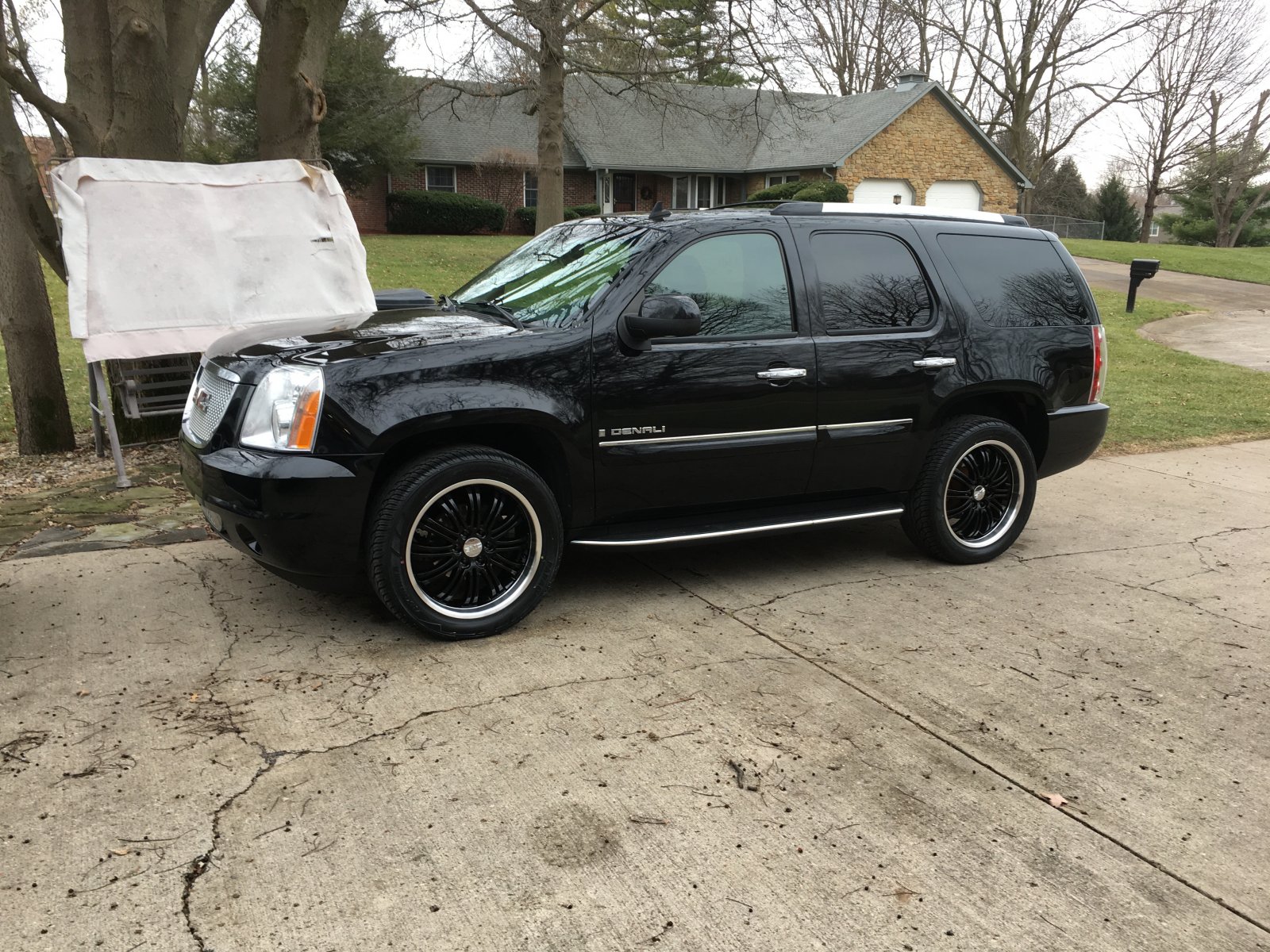

yep will do lol, I got too excited to show what it looks.
Unfortunately I didn't take a measurement before.
Of course I measured it after, front is right at 32.5 from ground to fender lip opening. and rear is about 33.5 will post a before picture.
45,011
Really interested in the side pic cuz I believe yours sits how I want mine to. I'll compare your "after" measurements to my "before".

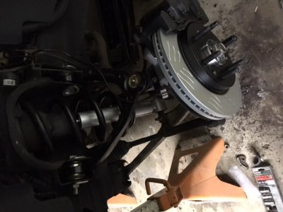

whats up guys new to the forum and i just got a 07 esky currently i installed a 2/4 kit but i want to go lower @iamdub im interested in what you said about mounting the strut under the lower control arm can you explain a little more on that is it literally just mounting under and thats it also was wondering if the 3.9 ohm 25 watt resistors work for the escalade aswell, trying to get rid of the service suspension light.

See this thread for putting strut under control arm. Post #7
https://www.tahoeyukonforum.com/threads/leveling-kit-to-lower.114438/#post-1377518
45,011
... is it literally just mounting under and thats it also was wondering if the 3.9 ohm 25 watt resistors work for the escalade aswell, trying to get rid of the service suspension light.
It is literally just that. Well, other than grinding a little for clearance and an alignment afterwards. Wade got you handled!
I'd PM Tony (@NORCAL SS) to verify, but I'd assume those resistors would work the same on the Escalade. It may depend on the type of shocks the Escalade has (MRC versus Bi-state).
