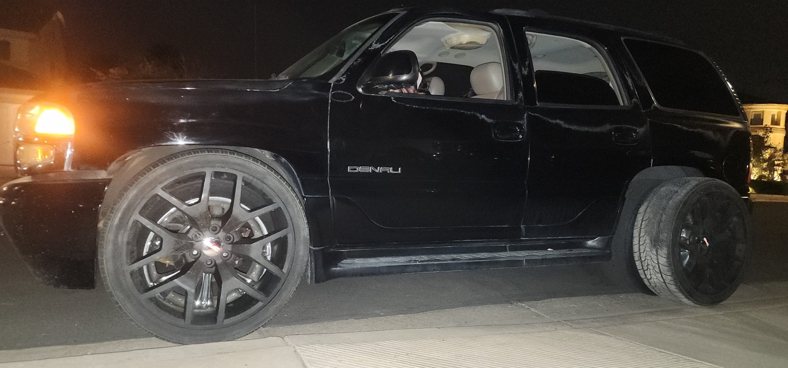

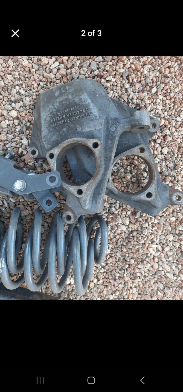

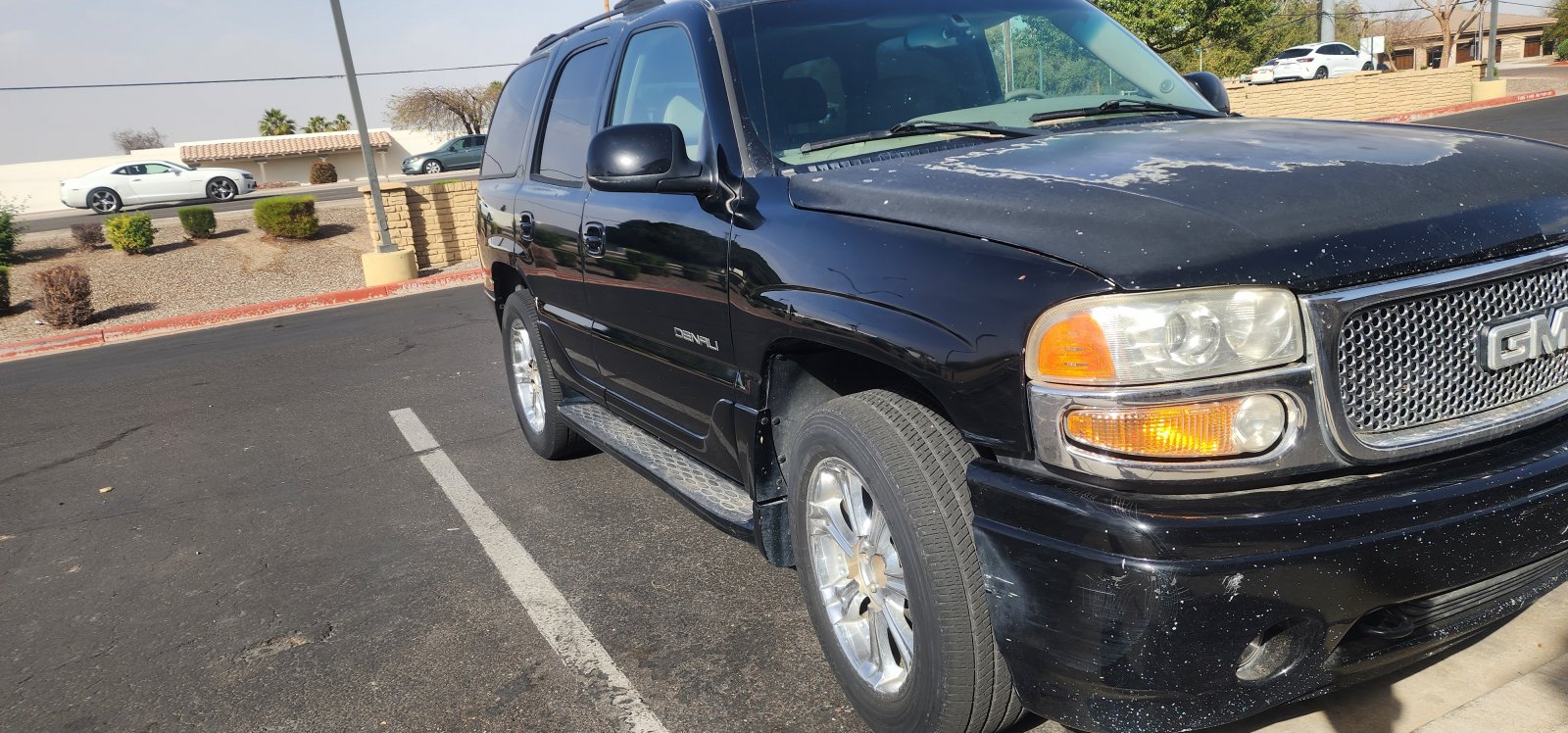

been scrolling thrue threads/Google for a few hours now figured I'd ask to clarify some questions. Anyways I just purchased an 04 yukon denali that's awd with the air ride. I originally decided I'd just delete it, but as of right now there's nothing wrong with it so why replace if i don't have to.More money for other things lol. so I'm curious can I keep it on and use drop spindles and rear springs/shock drop shakles + free range mod. "I believe u modify the rods or somthing for auto ride if u do this? I Just picked up a set of 24inch snowflakes for 400$ and I found a set of used spindles/springs local I'm debating on grabbing for 200$. Im not sure if they are correct but I believe it is the right set. I'm after a "flush" look 2/4 or 3/4 adding in lowering keys? New to these trucks I just bought her for 1500$ from a family friend with only 140k miles, and I'm the 2nd owner so I think it's worth fixing her up lol

Spindles get 2” in front and springs with shock extenders out back. Yes you adjust the ride height sensor rods. You’ll need a fairly low profile tire with 24’s and may need to massage your front fender liners.
